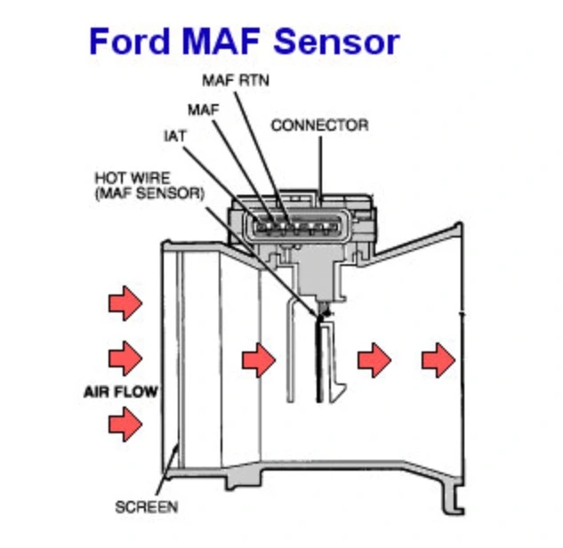

I'm betting the Mass air flow is coated in oil and not reading correct air flow-id clean it,and not oil the filter anymore

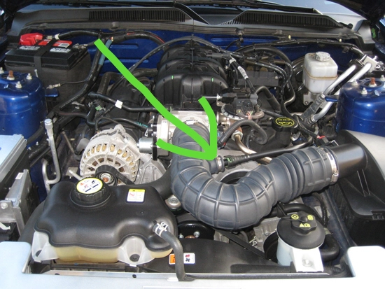

This is the tube I'm asking about
Yes I'm thinking there's either a leak or all components haven't been attached. Check the hose and clamp to the air tube. Is everything connected and secure as it should be? Check all seals and make sure everything is tight. That's what I would suggest.
