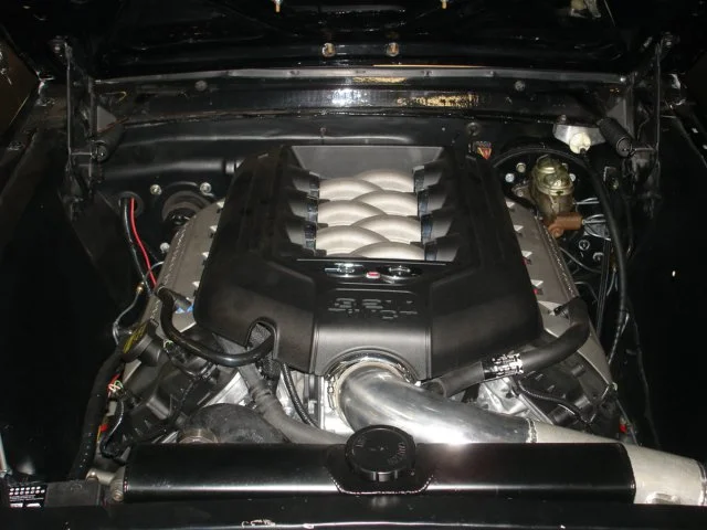

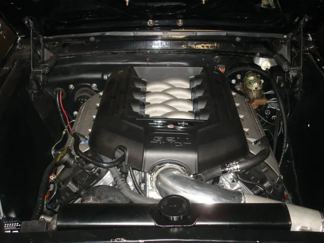

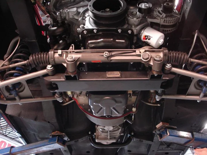

If you are interested in doing this swap, the shock towers can be cut away and the front suspension upgraded to accommodate.
You will pick up significant handling performance, will have an engine that is definitely "Modern", will be out about 12-18 k by the time you buy it, the controller, the fuel system, and the suspension kit to get that "modern powerplant"

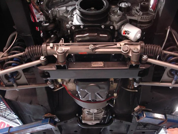

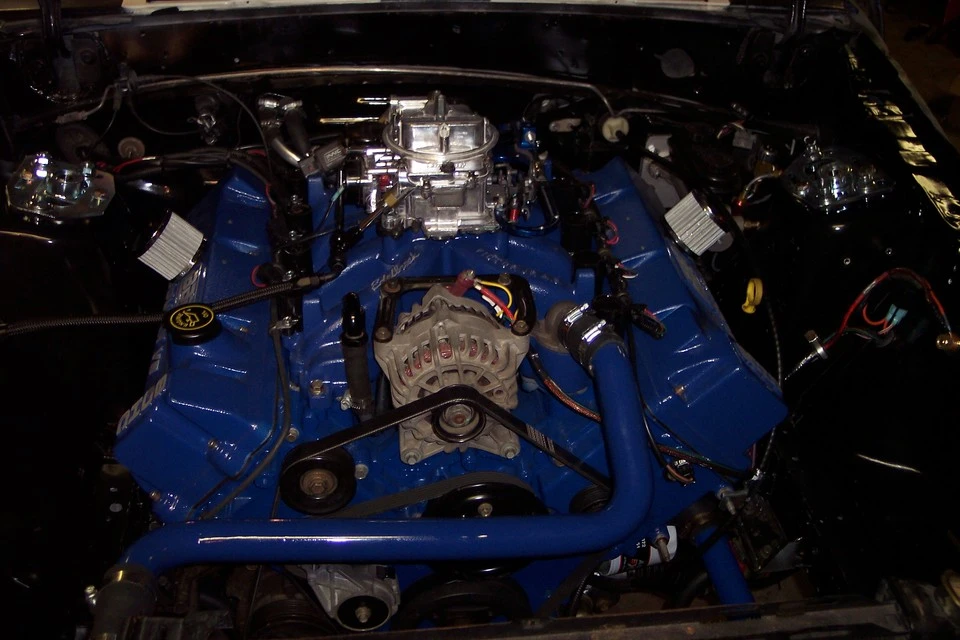

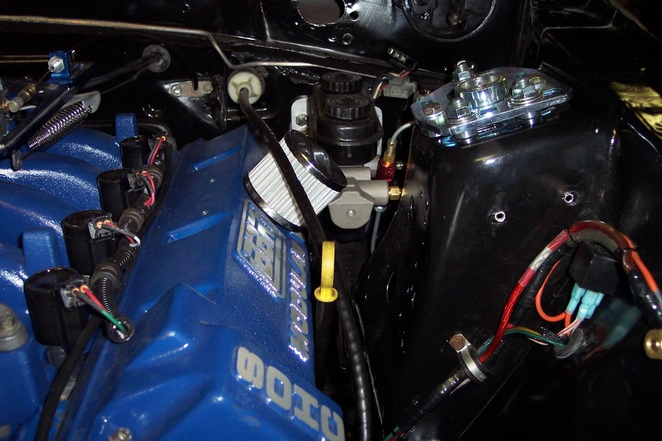

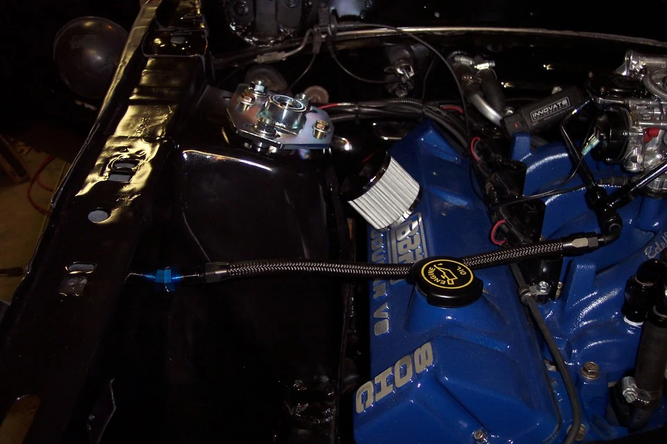

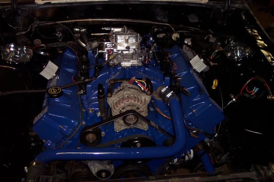

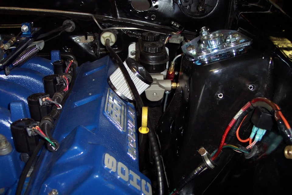

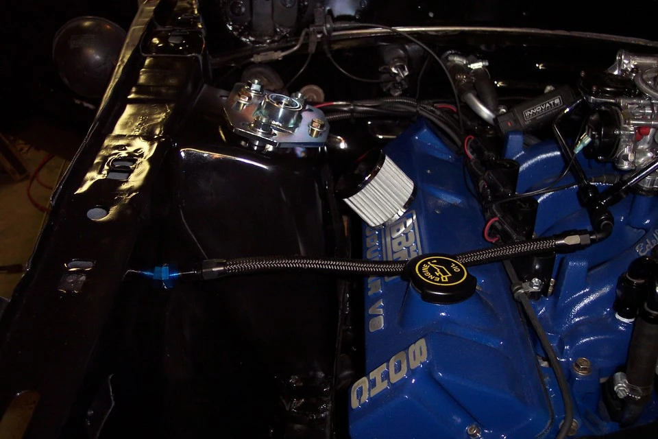

There is shop in the Chicagoland area called Speed Inc. that built and documented a '65 with a Coyote motor, as stated there is a lot of work to do on the front suspension before ever taking on the motor. The build was documented on another forum.
Just to repeat some of above...you would have to change out the entire front suspension, do away with the shock towers....and from the looks of those pics up there, i dont think that a brake booster would fit. Anything can be done if you throw enough money at it though. I like the idea of a stroked 351, or a hot 302. Love me a hot small block....very fast, very cost effective.
