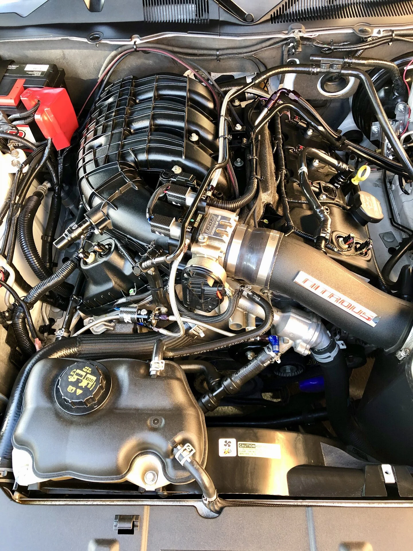

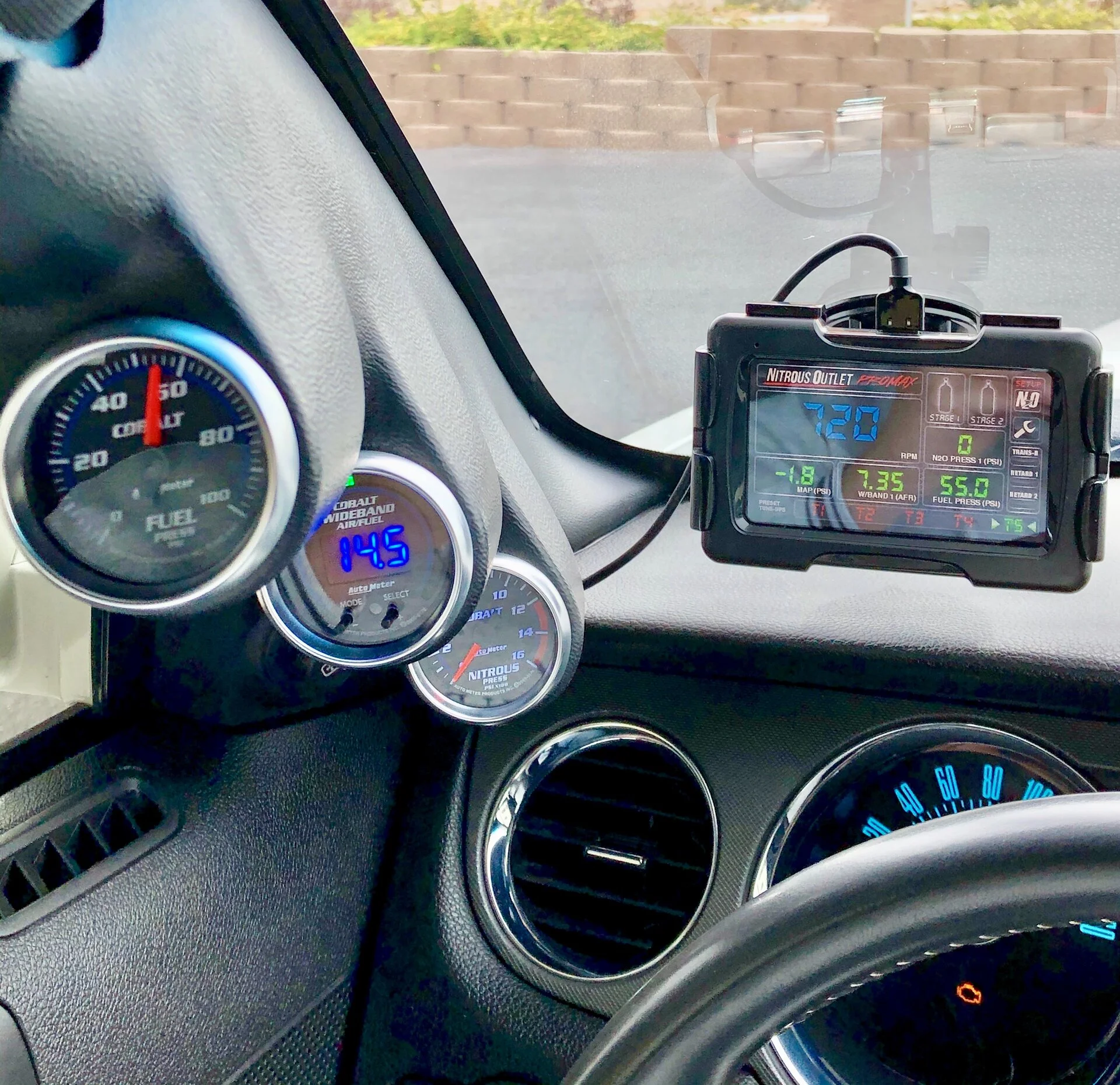

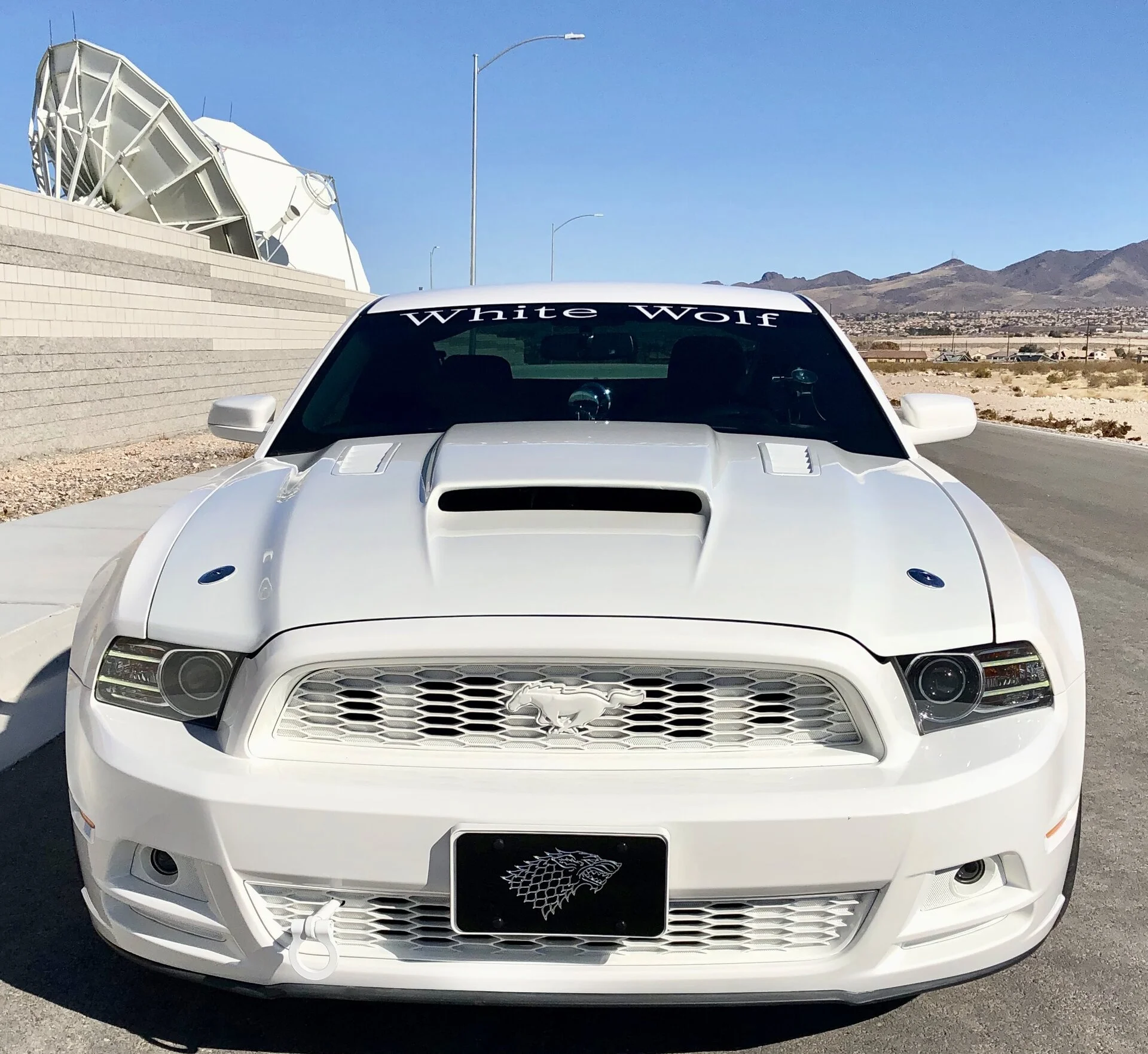

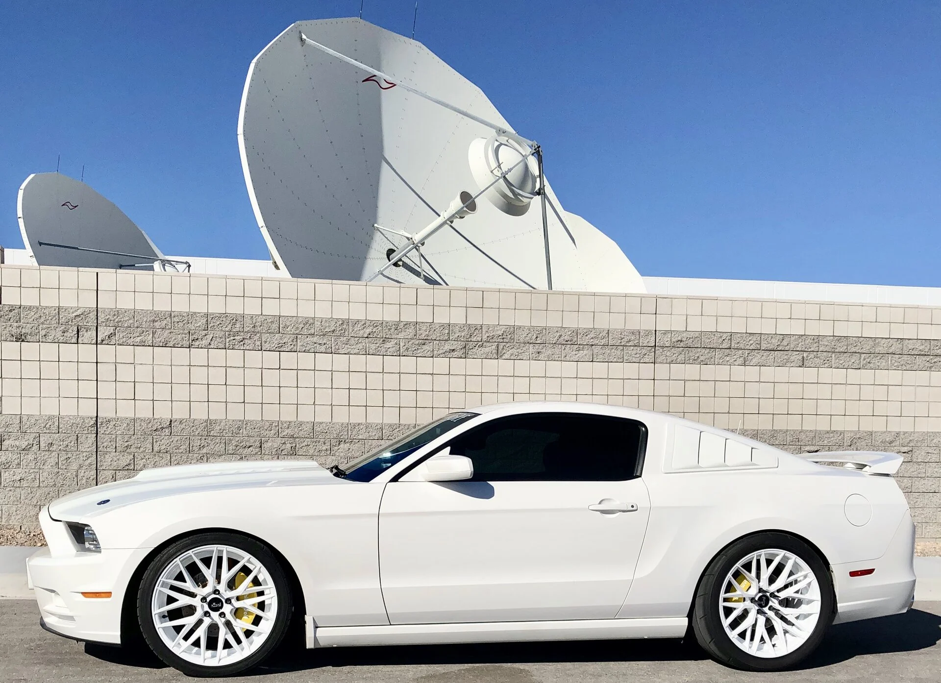

Its been a 2 year build - labor of love.
“WHITE WOLF”
2013 - 3.7 Cyclone Mustang
420 HP to (Wheels) @ 6200 RPM
395 Torque @ 5400 RPM
Pro Dyno Tune (Insane Power)
6R-80 Transmission
8.8 Rear End/ Detroit Locker
6 Speed Auto Sport Drive
(MODS)

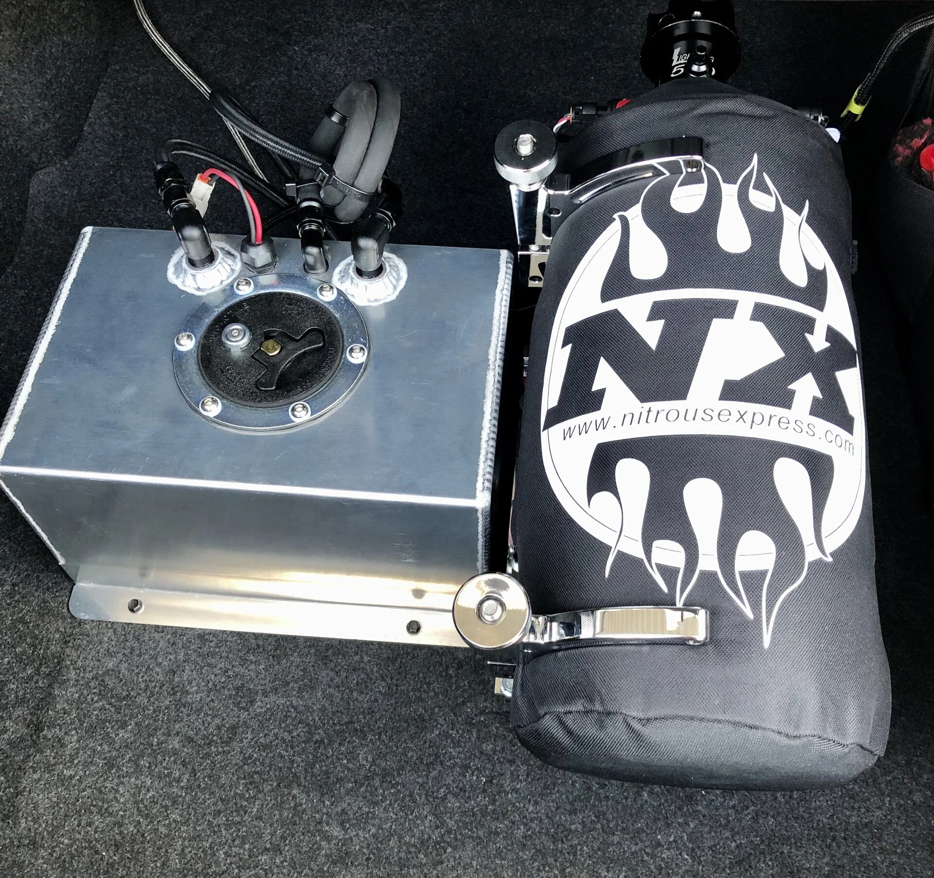

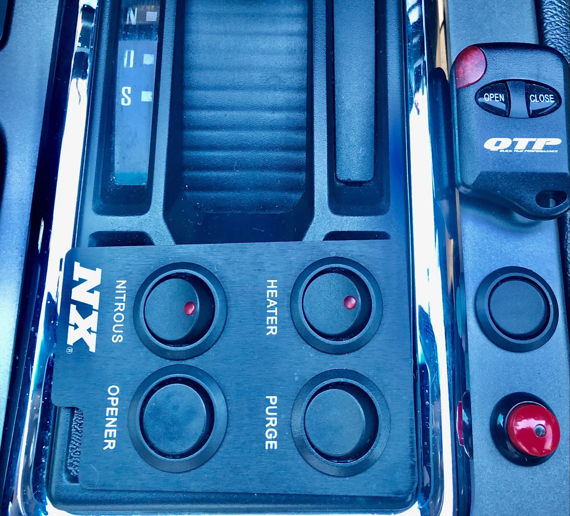

*Nitrous Oxide - “175 Shot” (Progressive)
*Ported Upper/ Lower Intake Manifold’s
*JLT Cold Air Intake
*73mm Throttle Body
*Brisk “Diamond Tip” Spark Plugs
*BBK Long Tube Headers
*Catted X PIPE Exhaust
*4:56 Rear Gears
*Eaton “Detroit Locker” Differential
*Carbon Fiber Driveshaft - (18 lbs)
*Spicer - U-Joints
*4000 “Stall” Circle D Torque Converter
*4000 RPM Trans Brake “Launch”

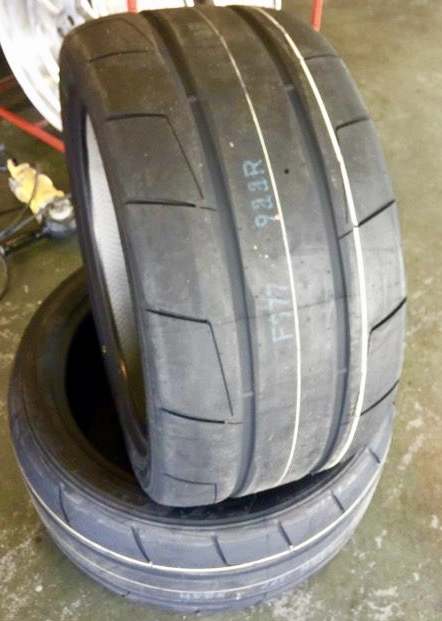

*Rear Tires Nitto 315-35R-20 (Drag Radials)
*Royal Purple Synthetic Lubricants
*MOTOR FUEL - 97 Octane - w/ Boostane
*NITROUS FUEL - 110 Octane “Dedicated”
