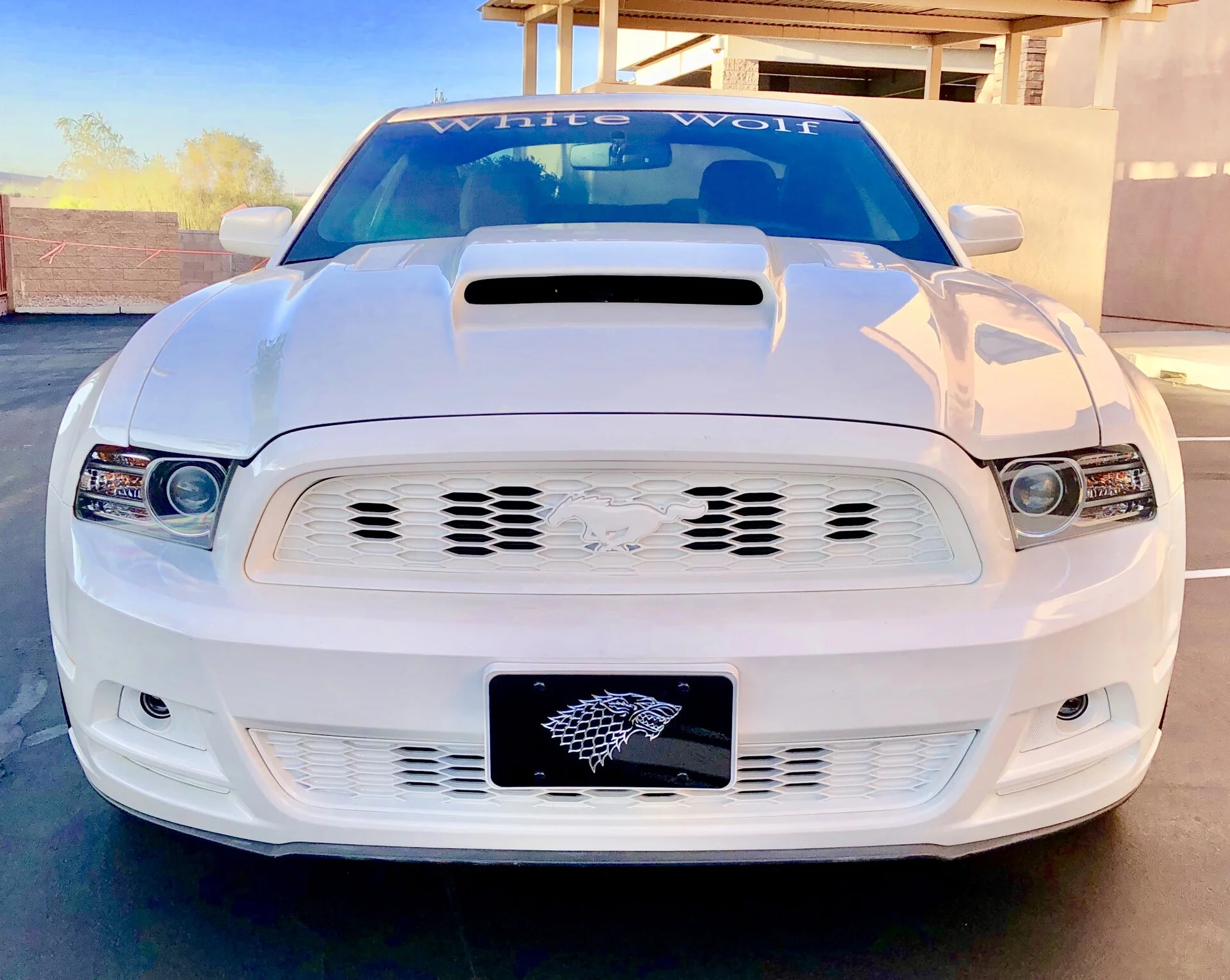

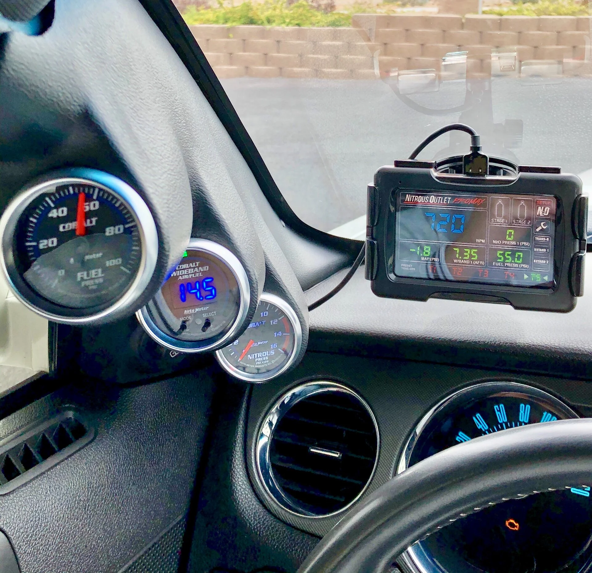

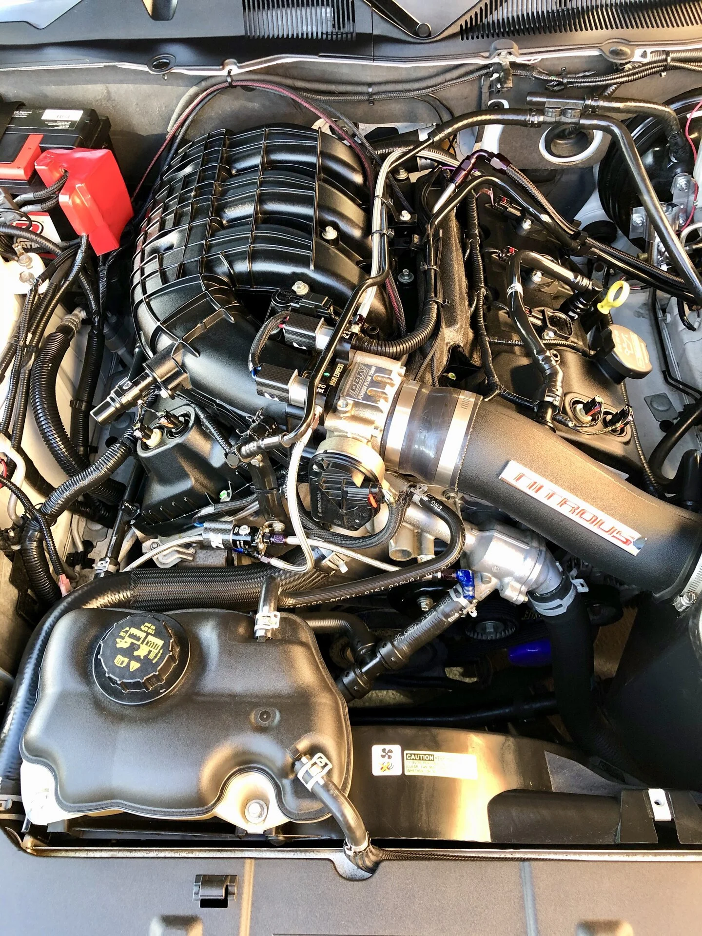

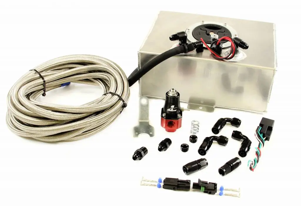

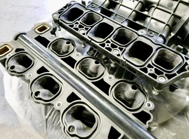

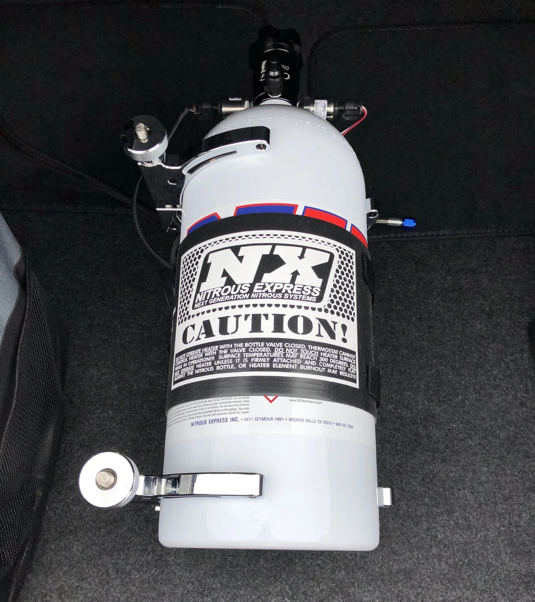

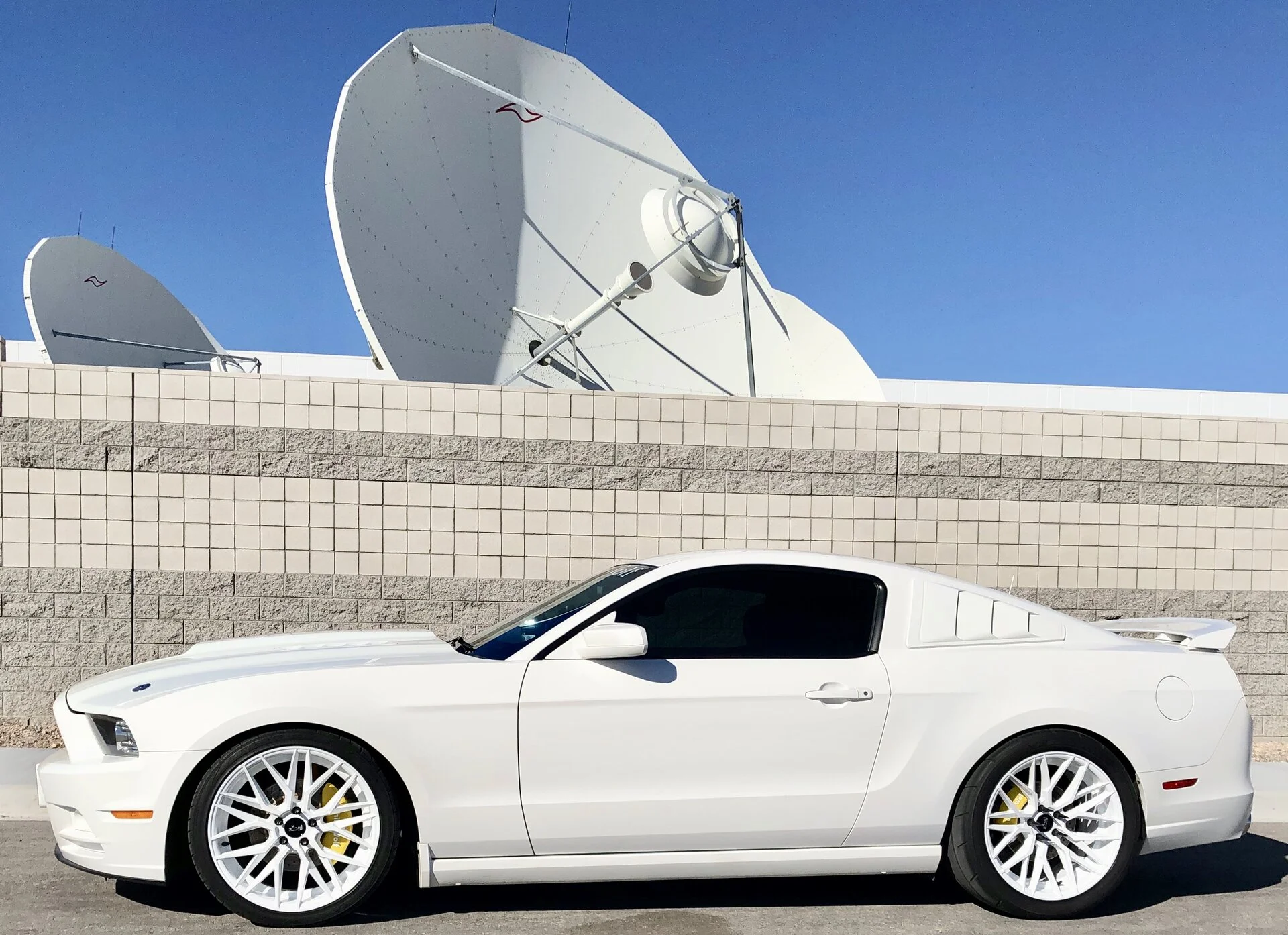

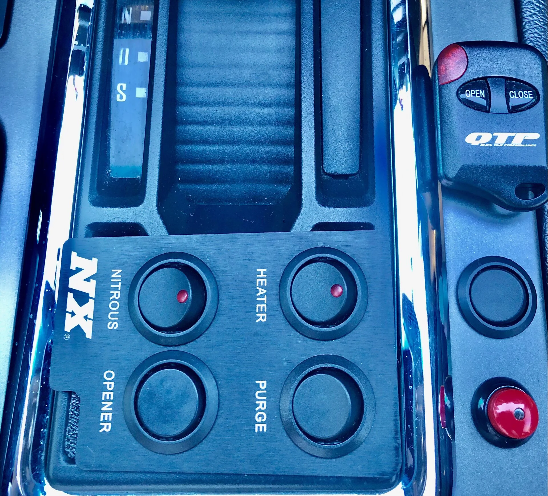

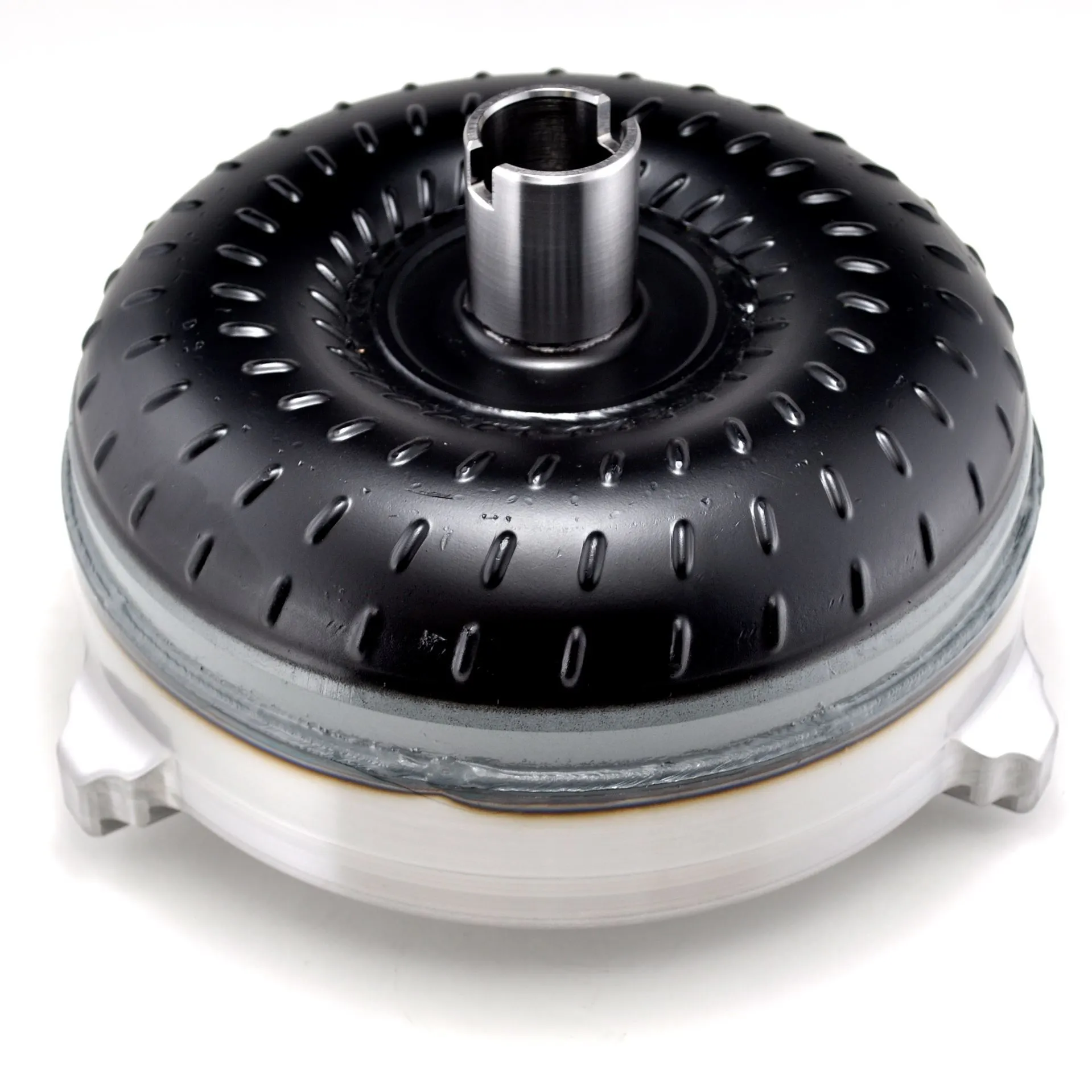

The Nitrous project has progressed nicely and finally completed for those of you interested.
No Track Time yet. Very hot here in Vegas and Ill wait til the fall. I'm anticipating 11's based on all the info I have.
2013 - 3.7 Mustang
6R80 Transmission
8.8 Rear End
6 Speed Auto
*Nitrous Oxide - 150 Shot Pro Max “Progressive Digital”
*Dyno-Jet
Tune Pro Tune - (Insane Power) SPEED SHOP
*Super 6 Ported (Cyclone) Intake Manifold’s (upper - lower)
*JLT Cold Air Intake
*BBK Long Tube Headers
*Catted X PIPE - Dual Exhaust
*Ford Traction Lock (Possi) Rear End
*4:56 Ford Gears
*73mm BBK Throttle Body
*Brisk “Diamond Tip” Spark Plugs

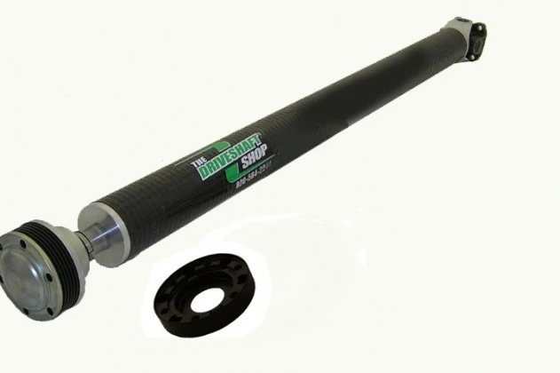

*Carbon Fiber One Piece Driveshaft - (18 lbs)
*Circle D 4000 “Stall” Torque Converter
*Trans Brake - 4000 RPM Launch

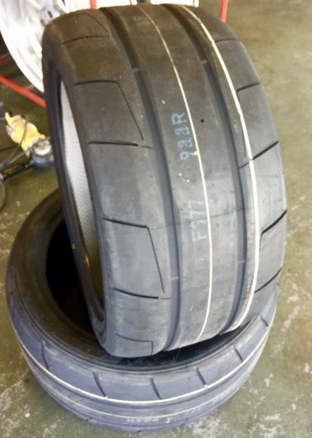

*Rear Tires Nitto (NT05R) 315 (Drag Radials)
*97 Octane Fuel - Boostane Additive - Motor Only
*110 Octane Fuel - Dedicated - Active Nitrous

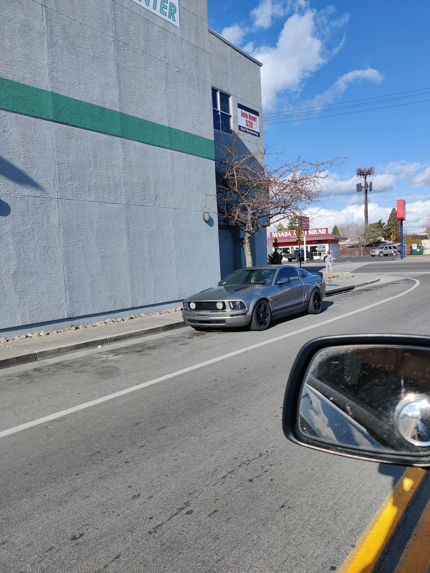

Very nice set up.
I have a 2009 4.0 V6
Cold air intake, shorty headers, high flow cats, daul exhaust, 91 oct tune, lowering springs, adjustable panhard bar, rear lower control arms, 100 shot wet nitrous system with daul purge, 3.73 gears on stock 7.5.
Ebc black slotted rotors and ebc yellow stuff brakes.
I am still buying more stuff.

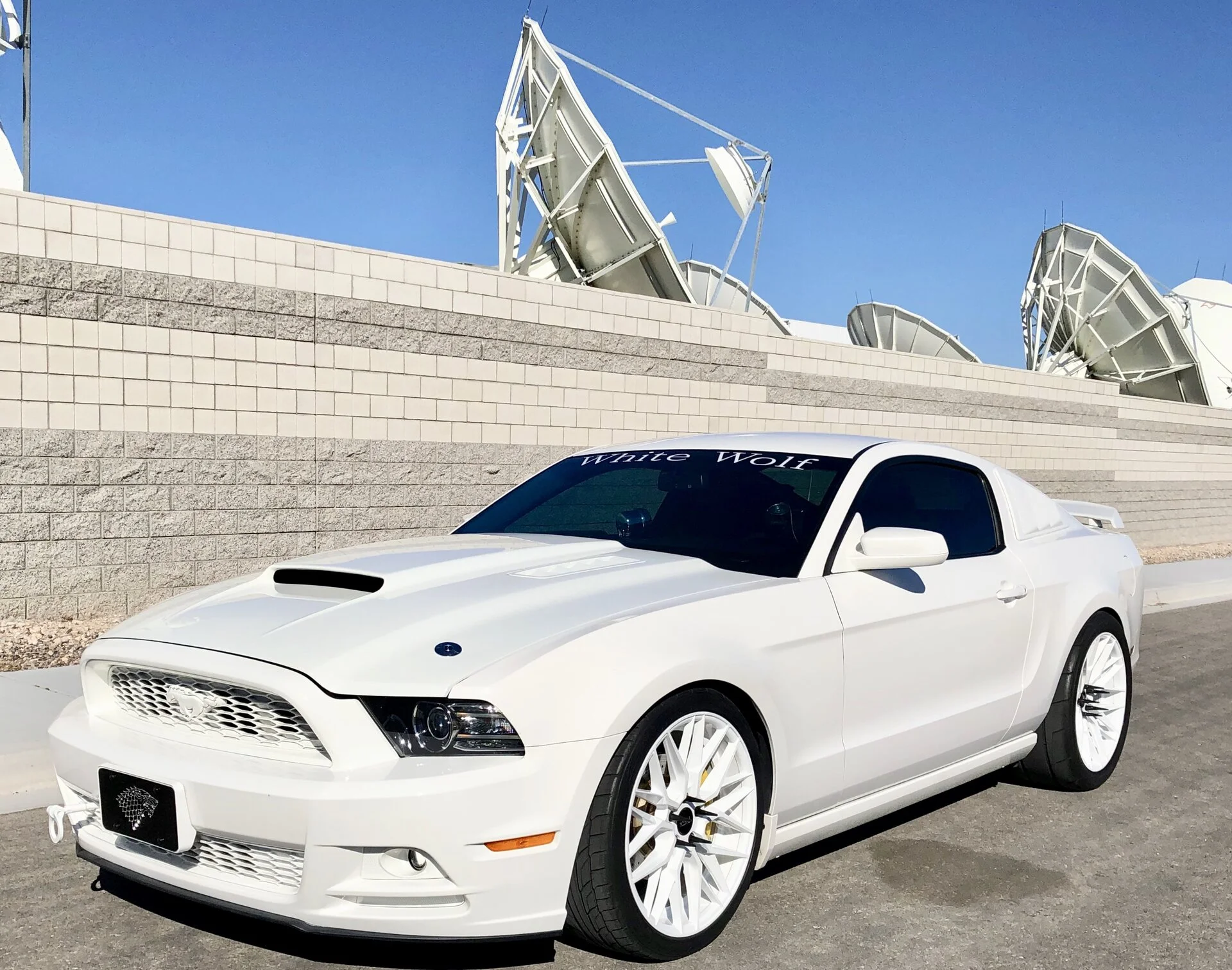

Good story I would never think of the V six doing any of that. With your car it's all about the money, and you have spent a fortune I am sure. Looks good I like the headlights too. The car looks nothing like your average Mustang, and that's the good part. Maybe a white louvre on the back window to really put it over the top
I bought it for 12,000 and have about 25,000. Half of that Im sure is SHOP LABOR in it which was done over the past 3 years. Been a labor of love for sure. It has the look of a SALEEN. What people dont realize is the TINY things one never even thinks about could cost 800 - 1,000 in parts and labor.

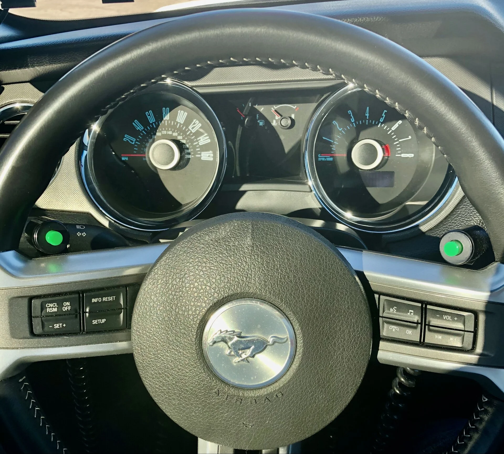

Nice thing it has all the CONTROLS for the Nitrous, Line Lock and Transbrake right at my fingertips. The TWO GREEN buttons on the steering wheel are the LAUNCH. You hold both of them down at the light and FLOOR IT bringing the Tach up to 4,000 RPM and release them simultaneously to launch as the Nitrous comes on automatically at 50% amping up to 100% within 2.5 seconds. The Nittos hold it tight and more importantly STRAIGHT as it moves out. Very controlled.

A couple. This car for some reasons TRANS BRAKE alone will not hold it at 4,000 RPM so I must use the Trans Brake (RIGHT) and the Line Lock (LEFT) same time. I did not know this could be done and never heard of Line Lock and Trans Brake same time until a heavy hitter racer at the speed shop I use set this up and told me use it. He was dead on.
What many people dont realize is those Nitto Drag Radials do not require a lot of SMOKE and HEAT to launch. As a matter of fact Ive tried them heated to the point of smoke and then went in and launched. I had considerable spin and felt greasy as it left HEATED UP vs just street warm. Just the opposite of what one would think. To me its just the SLICKS that need that serious warm up they do at the track.
