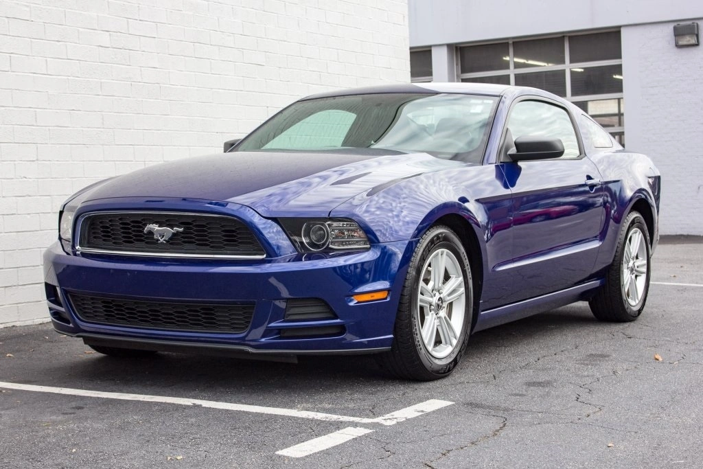

Looking at a 2014 V6 Mustang, V6, 6-spd manual, 57K miles. 1 owner good carfax. Dealer is asking 15,790.
Per cargurus that is a bit high. Wondering what y'all think a good price is for this car ? Also, anything too look out for on a '14 V6 ???
