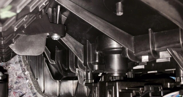

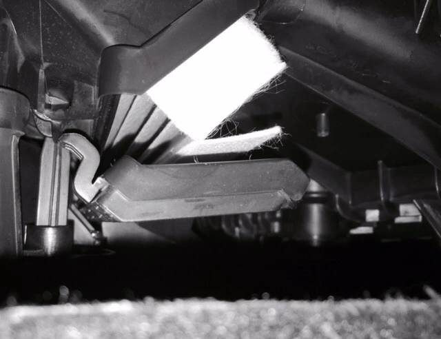

1- drop the glove compartment door
2- look for the flat tap with a screw in it around 9 o clock in pict #1
3- unscrew the silver screw, pull on the tab and the hinged door will open up and you will see the filter. The filter door can be removed
4- pull the filter out and replace it noting air direction arrow.
5- reverse the above procedure
