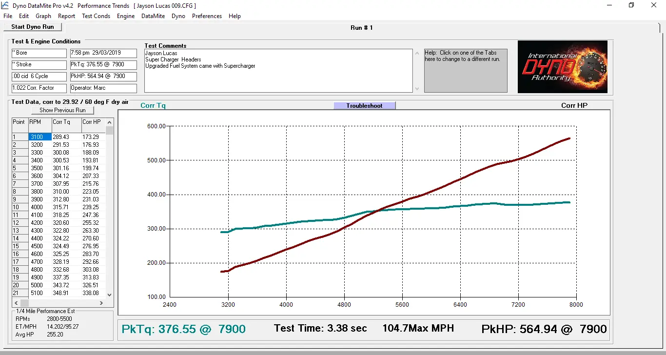

Looking for some advice - recently had my 15 gt tuned on the dyno .
Rough stage 1
Bbk catless headers
mt-82
Torque numbers seems low . It’s my daily so I didn’t want to push it but I am putting down n/a torque numbers. Car drives great and hauls higher in the rpm range but I wanted someone with experience to take a look . Thoughts?

That graph is not right.
You're missing about 100 ft.lbs of torque and that's the weakest torque curve I've seen for a positive displacement supercharger, yet.
Your HP numbers look to be in the ballpark but that torque figure is def off.
I agree . I’ve seen multiple graphs of similar supercharged mustangs making 450-500 ft/lbs . I thought maybe the dyno was conservative. My baseline on the Canned roush tune was embarrassing . It made 400 hp and just under 340 ft/lbs - granted I had headers installed before we did the baseline so it wasn’t tuned for them .
Now to figure out why the numbers are so low .
