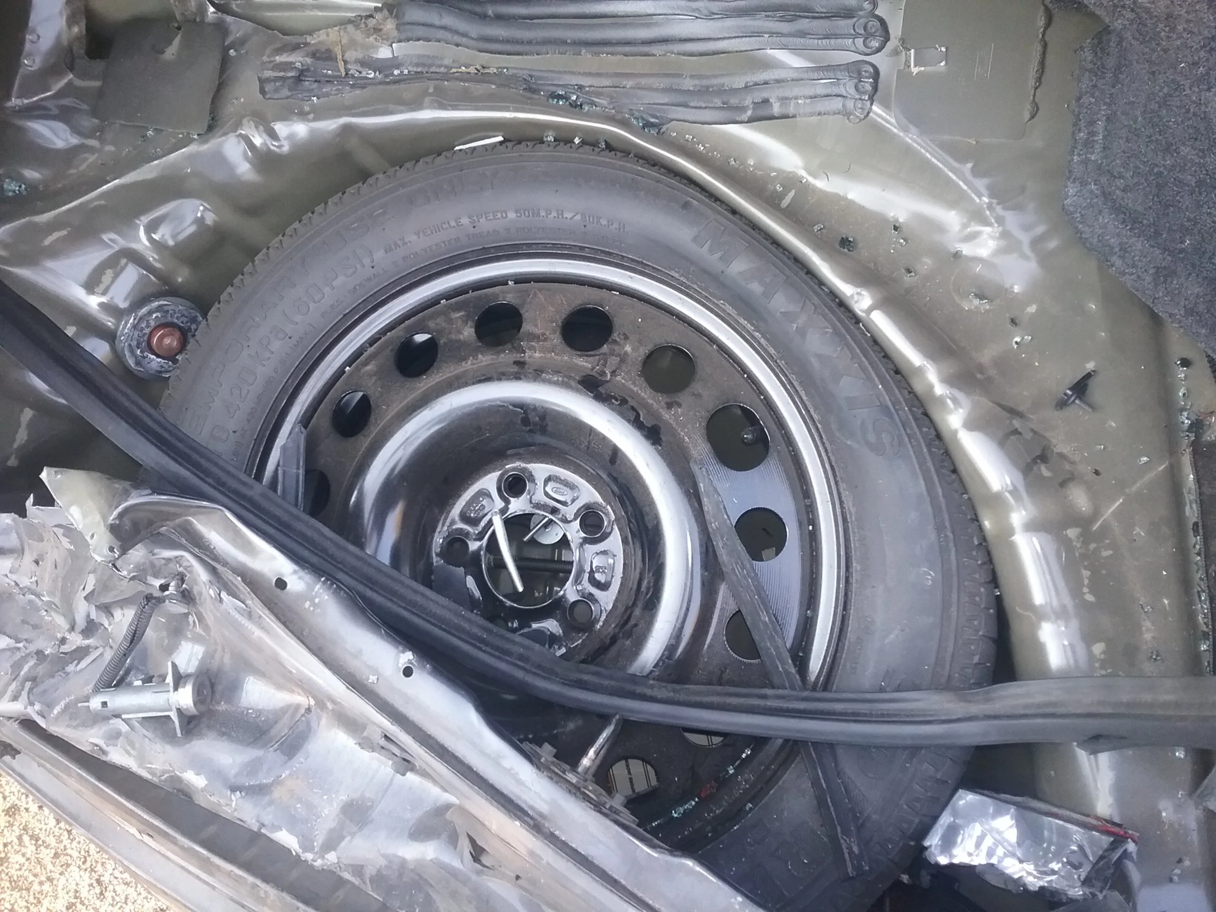

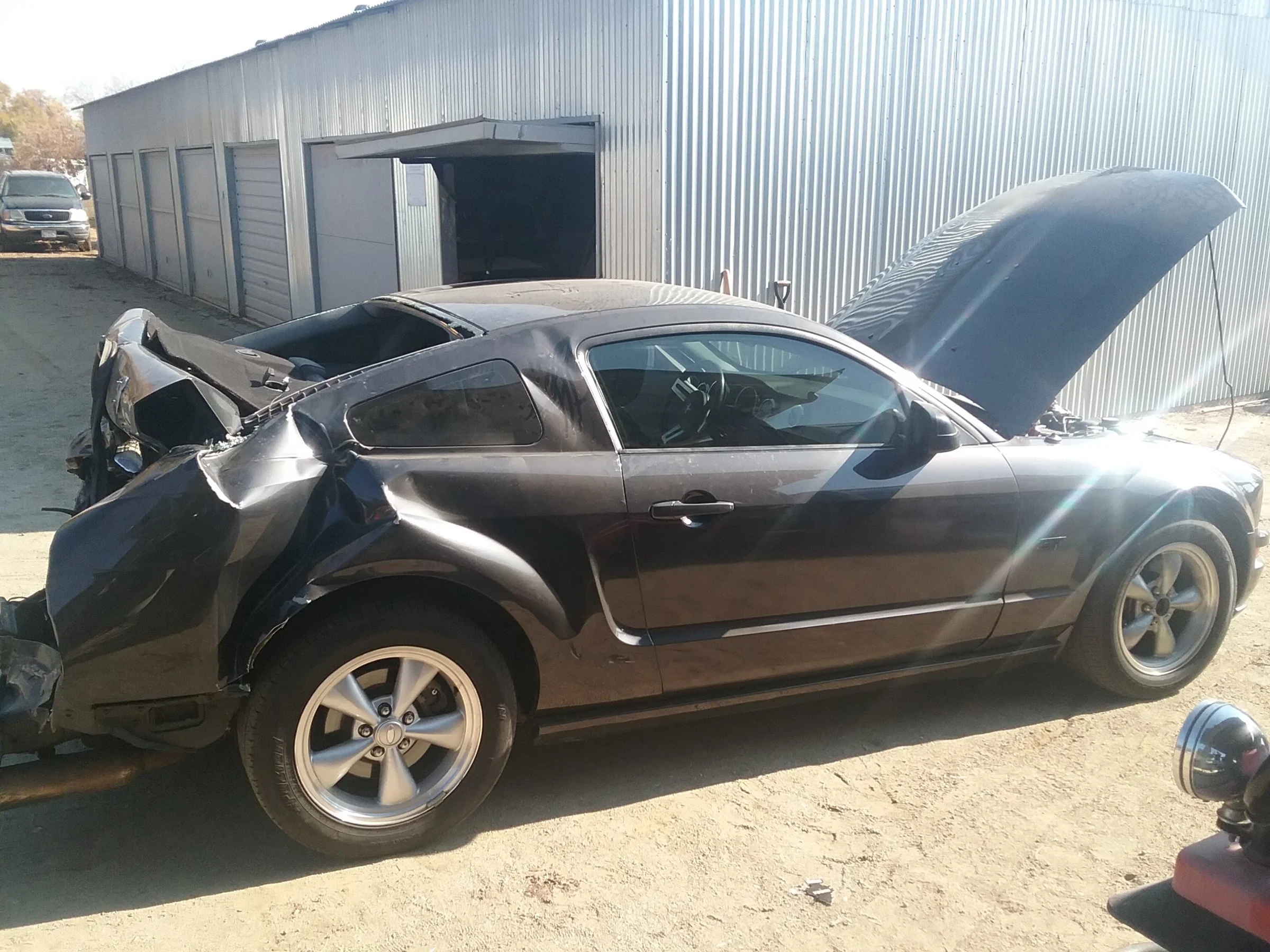

I would put the spare tire in ,i just bought a 2007 that was rearended at 60 mph and the spare actually kept the back end of the car from folding up into the back seat of the car
That might be the best route to go. Sorry to hear about the car that is terrible. I hope you are fine and no one was injured!! Also, the car didn't come with any tire inflating kit that others with the performance package have said it comes with.
It wasnt me ,the kid that had it only had it 3 days and got rearended while setting at a stop light .the spare actually kept the trunk from going into the back seat ,i let the air out of the tire to pull it out and the trunk actuallt squeezed up farther ,the tire acted like an air bag and probably saved this kid
