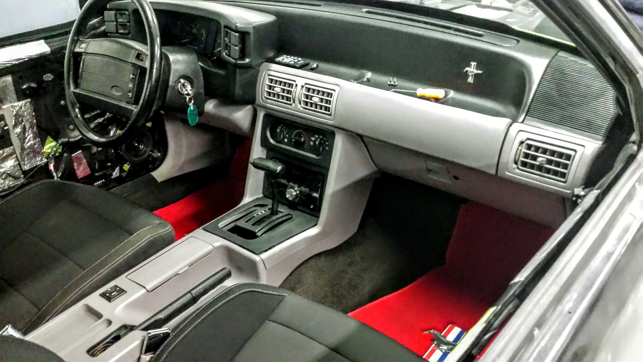

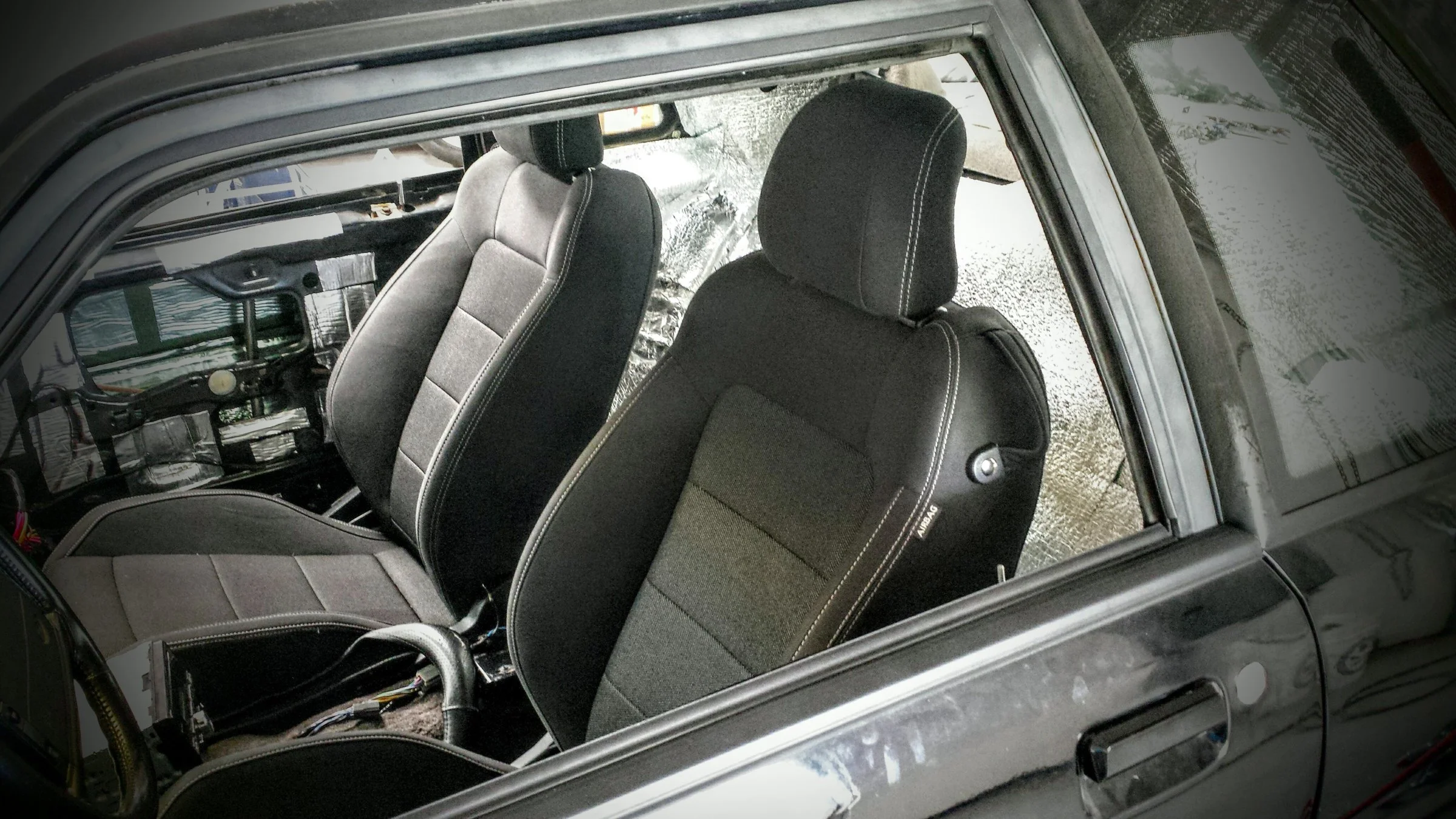

Been working on my son's 92 SSP interior. The interior was in pretty decent shape, except the driver seat foam was in need of replacing. I originally intended to put 05-14 Mustang seats in the car, but after seeing the 15' models I decided to try them. I had to cut the tracks off and weld some square tubing to the seat, then drill holes for the original Fox tracks. Man what a difference in looks and feel. I moved the tracks forward on the seat to give more leg room, and they sit a little lower than the Fox seats which is to my liking.

nice job, that looks great. was going to try to do the same. could of got a good deal on 15's but it looked like it would of need a good amount of fab work and i dont weld. would love to see what u did to make them work
Reactions: Bossed
Nice work, 2015 Seats are something I would like to add to my car too.

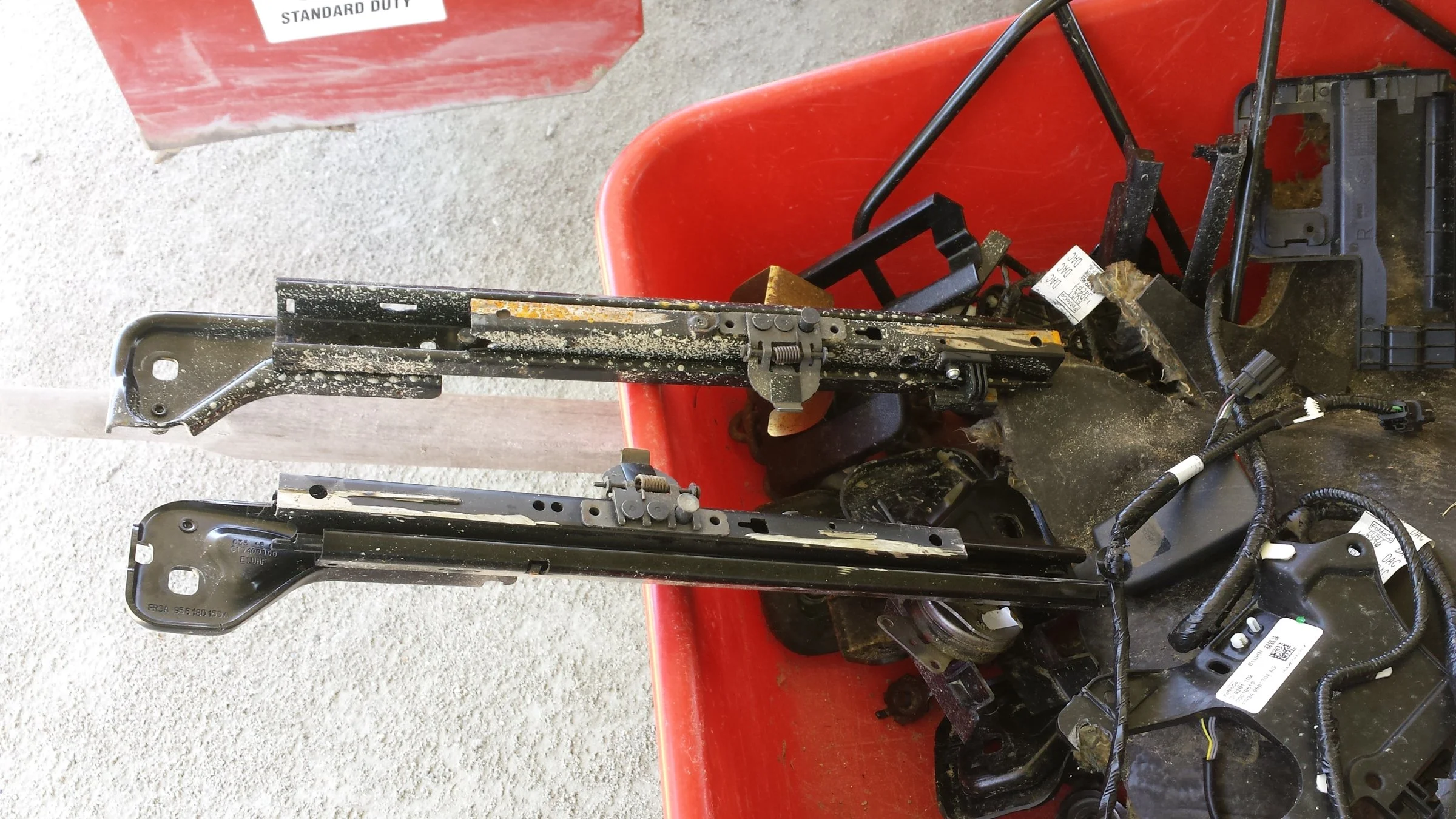

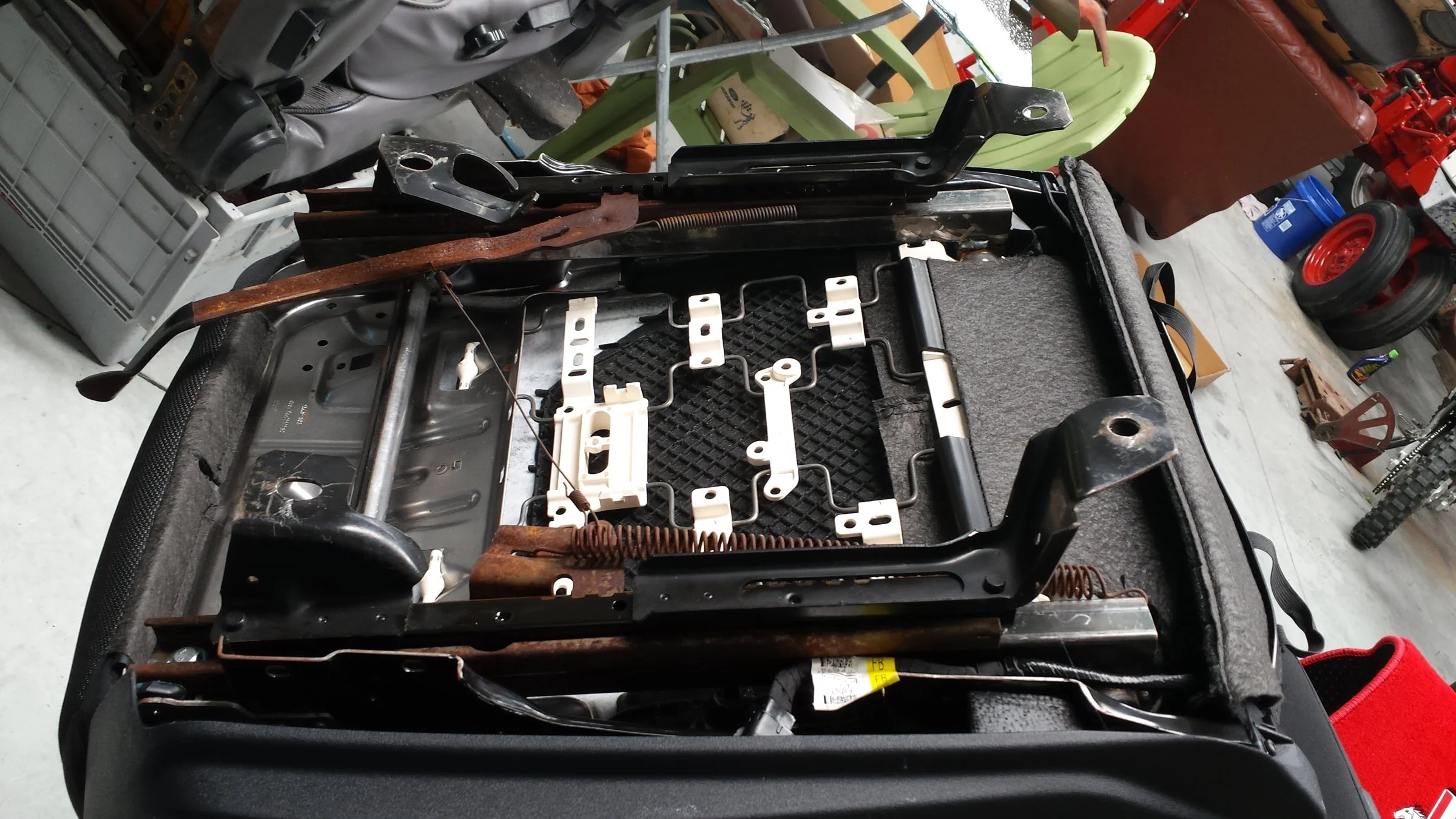

Here's a couple of pictures of the stuff I cut off, and the Fox tracks mounted on the new seat.

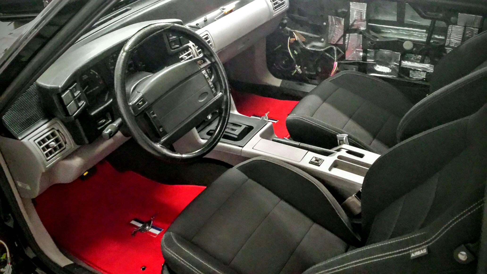

Those look good, and I like the red floormats. Nice touch.
I kinda want to look into this. I have 99-04 seats in mine, but they do sit a little high. I'd like to get down a little lower as I'm 6'1", and it seems a newer set of seats is the way to go. Just need a welder first.
Reactions: Bossed
Thanks, I'm still not totally sold on the red floor mats :thinking:I'm 6'1" also, but I'm kind of long waisted, so having headroom is a must. My Dad has a Terminator and it's not comfortable because I feel like I sit so damn high. My son said he likes the way the seats are, if it were mine I'd probably have lowered them about an inch on the front, but I like to sit low. I mounted the tracks a little forward to give more leg room, compared to the original seats, there's no comparison.

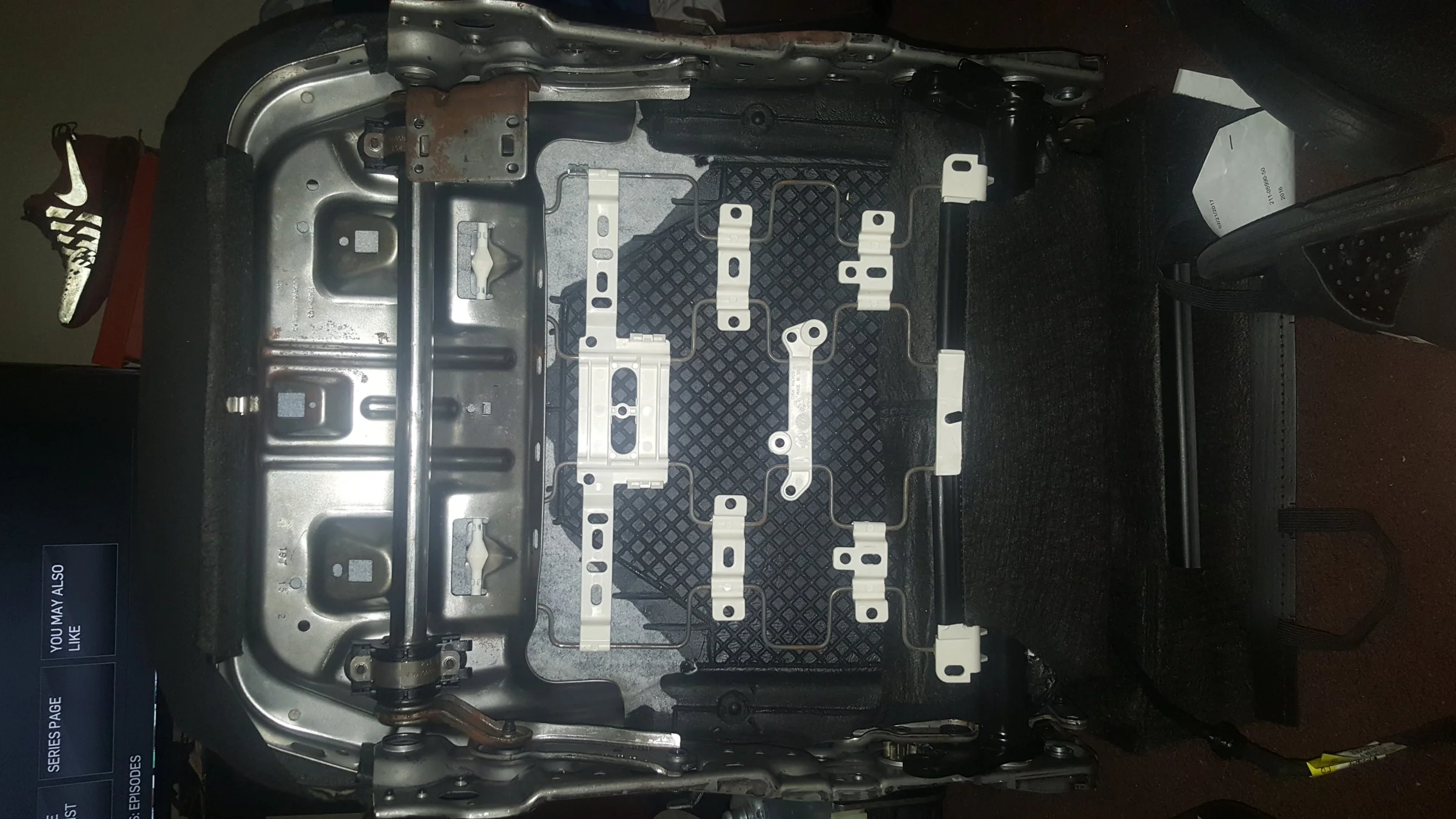

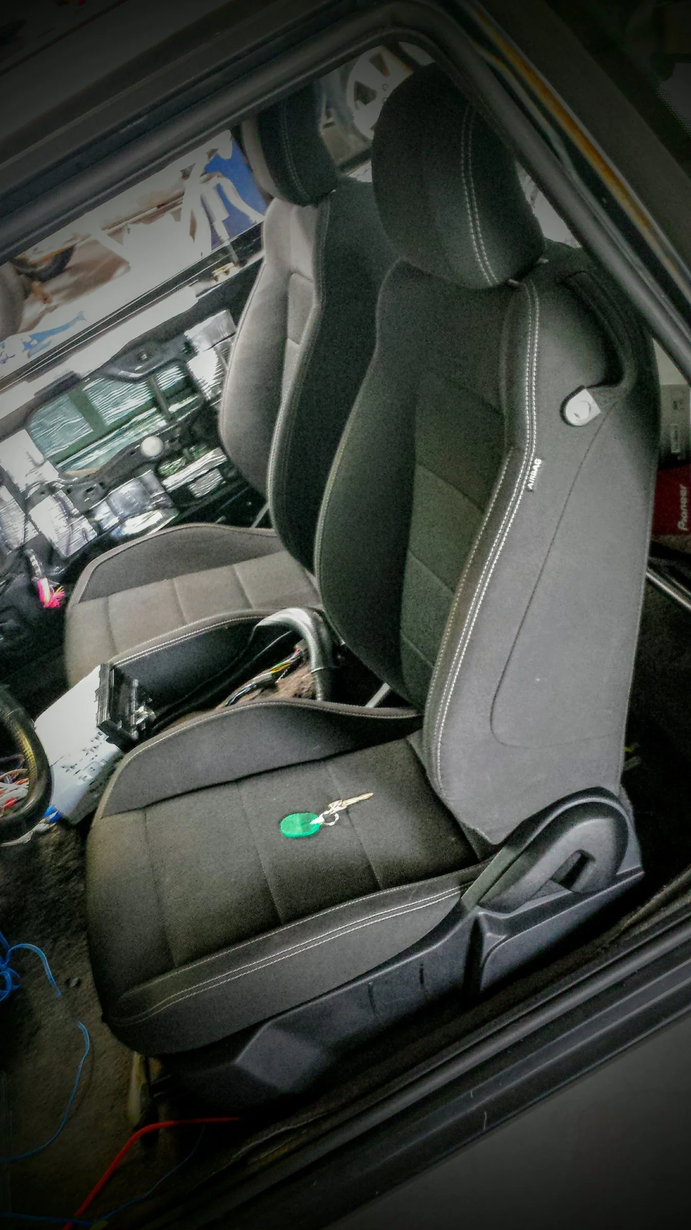

Sorry for bring a dead post back, question. Whats length and the width of the square tubing? Also did you weld on the part on the two cylinder tubes on the front and back? The 2016 seats i have had the electrical lamber.
I still have to take off a few things, but i was thinking of taking that tube up front off and weld a tube straight across as one piece with the square tube like a box or cut and grind that square bracket thing and weld the square tube only like u did.

That round pipe section looks to me like it is for height adjustment, if you are adding your stock Fox Tracks then the height adjustment would work from that.

Hey fellas, I'll have to search my phone to see if I have any pictures of it finished. I don't remember if we took pix of the interior specifically. I know there are different versions of these seats, powered, manual, heated/cooled etc. The seats I purchased were manually adjusted, even the height adjustment. Our seats would not fit in the car. They would have sit way too high, and they were no match for the Fox floor. The 2015 seat brackets are welded to the seat frame, so I cut them off with a ziz wheel. I removed the height adjustment mechanism from ours since it was not needed. I welded the square tubing to the round tubes and bolted the Fox seat adjusters to the square tubing. The seats are a tight fit, but they do fit, and they're head and shoulders above the originals.
