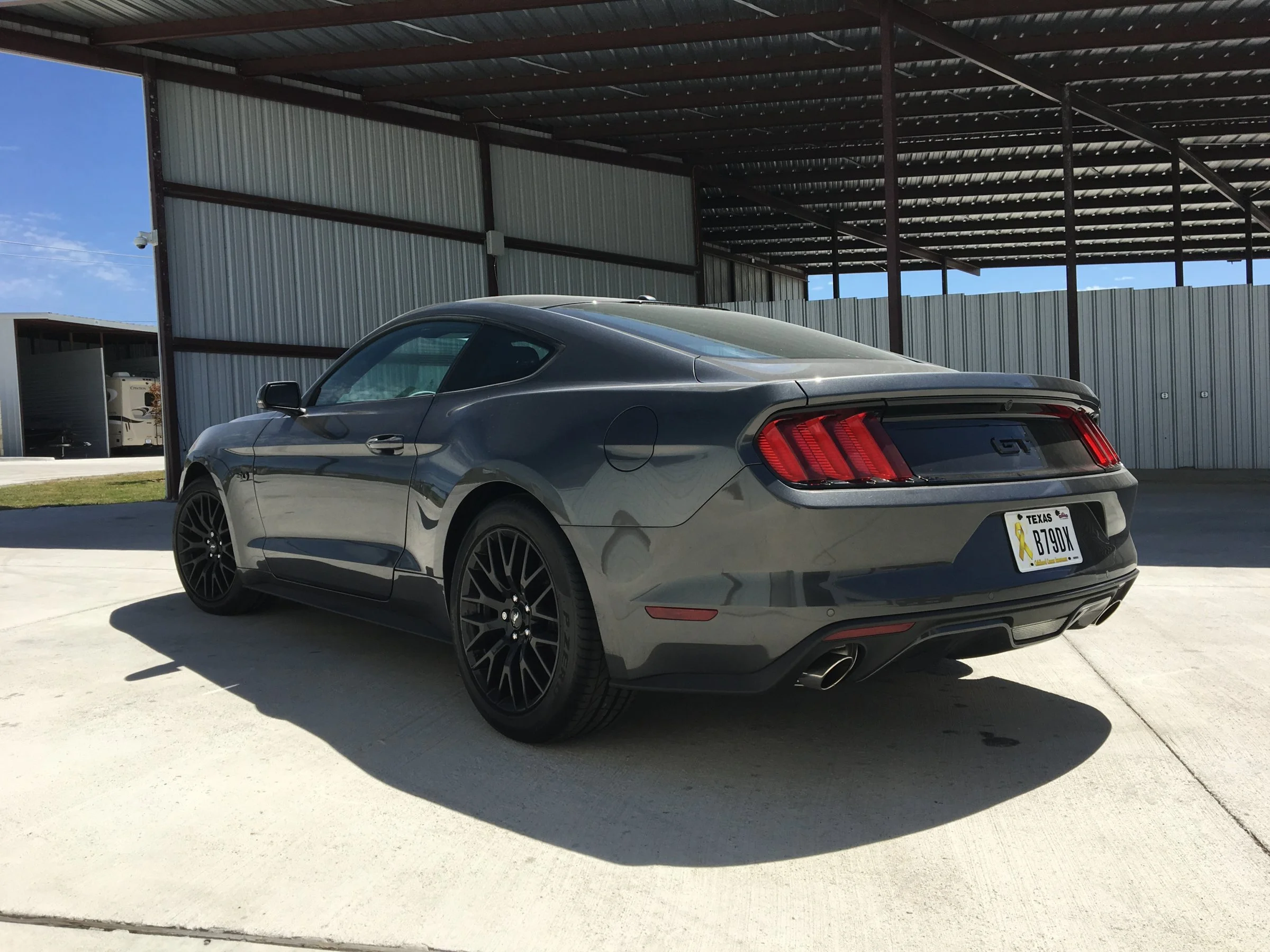

Couple of questions for the Guru's here.
I have pretty much set my sights on the Whipple Stage 2 Kit and have a couple questions.
https://whipplesuperchargers.com/index.php?dispatch=products.view&product_id=368
1) Anyone have any experience or opinions with/on this kit? The only S/C experience I have is with the Magnuson Charger on my boat.
2) After install this kit. What other mods need to be made to a 2017 GT Premium w/Performance Package to be able to keep it on the ground?
3) I plan to put a nice set of 1-7/8" long tube headers with the high flow cats. Suggestions on brands? Looking at Kooks or American Racing.
I'd like to keep the car as stock looking as possible.
