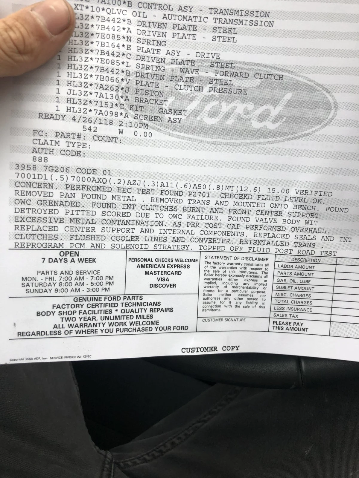

Has anyone else had a problem with there 10 speed transmission? Mine went out at 4000 miles and it’s been at the dealership for two weeks. Was wondering if it was a freak accident or if there’s more cases out there
Well, that's some sucky news.
We've been waiting for information one way or the other on the new transmissions, please keep us posted on the details. Also, if anyone is drag racing with the 10 speed we would really like to know your results and opinions. Description of the car, tires, mods, and times would be helpful. Thanks!
