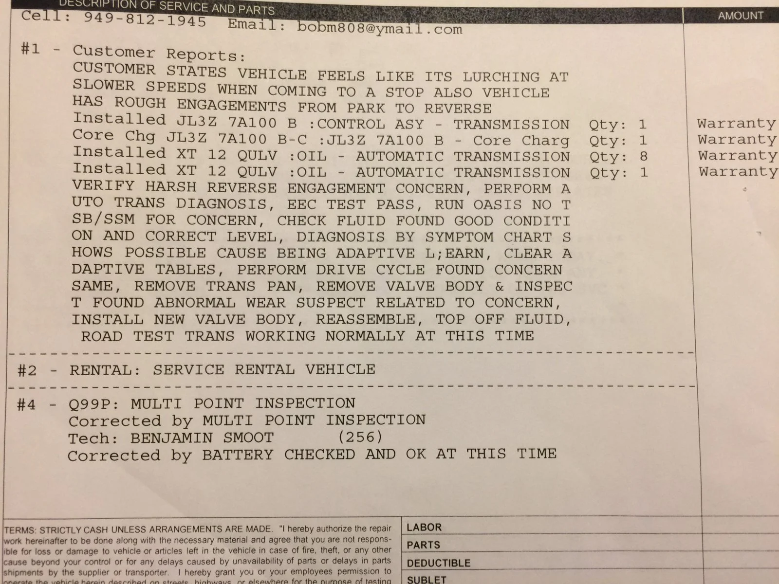

ok an update since my last post. I got my car back and all seemed fine, a few days later I started noticing different issues. I could now feel the transmission downshifting as well as upshifting...really hard to describe....took it back in. Dealer has had it for a week and a half now. I was told yesterday they need it until at least next week to completely remove and overhaul the transmission, and that they are working with Ford engineers to make sure they are on the right path....
I have attached my first work order...I cant make sense of it!!

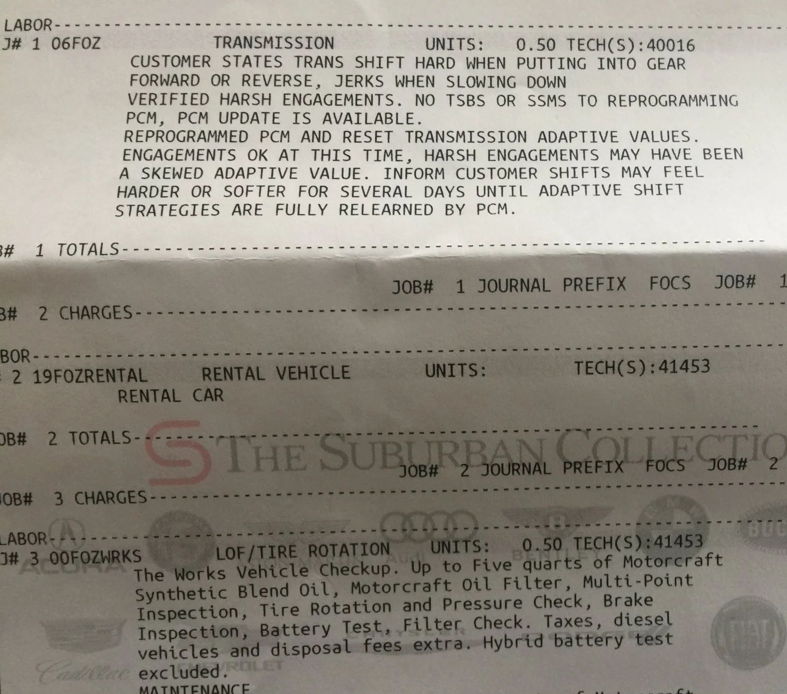

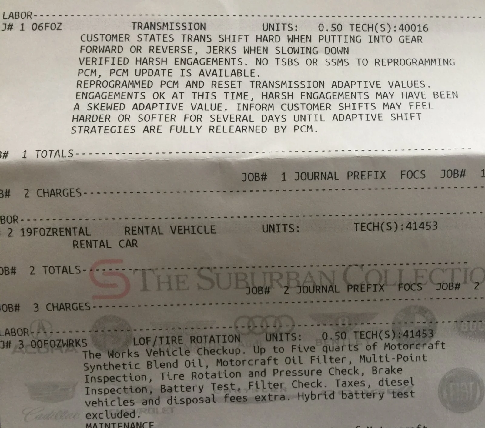

Update on my 2018 ecoboost "lunge" and "jerking" problem. The service department of the dealer took my car and keep it for 2 days (just to be sure) and called me that they reprogrammed it. It drives much better but there is still a little bit of downshifting you could feel when slowing down and the idle speed is a little bit faster compared previously maybe around 650-700.
I had it for a few days now hoping its going to get away after the technician said it is going to "relearn". Still hoping its going to get away. Here is the printout of the service done.

IMG_5368.webp Update on my 2018 ecoboost "lunge" and "jerking" problem. The service department of the dealer took my car and kept it for 2 days (just to be sure) and called me that they reprogrammed it. It drives much better but there is still a little bit of downshifting you could feel when slowing down and the idle speed is a little bit faster compared previously maybe around 650-700.

So another update on my car. I finally got mine back last night after the dealer having it for 28 days. They completely removed and rebuilt the transmission. There was no catastrophic failure but a few different areas that showed abnormal wear. So far after only driving it a little it seems better. Going to give it a few weeks to see if it stays that way!!
Why don’t you print out some of the service write up we got from ford service shop and show it to them so that they have ideas what to look for. I think your problem is pretty much the same as ours. Let us know on the update.
