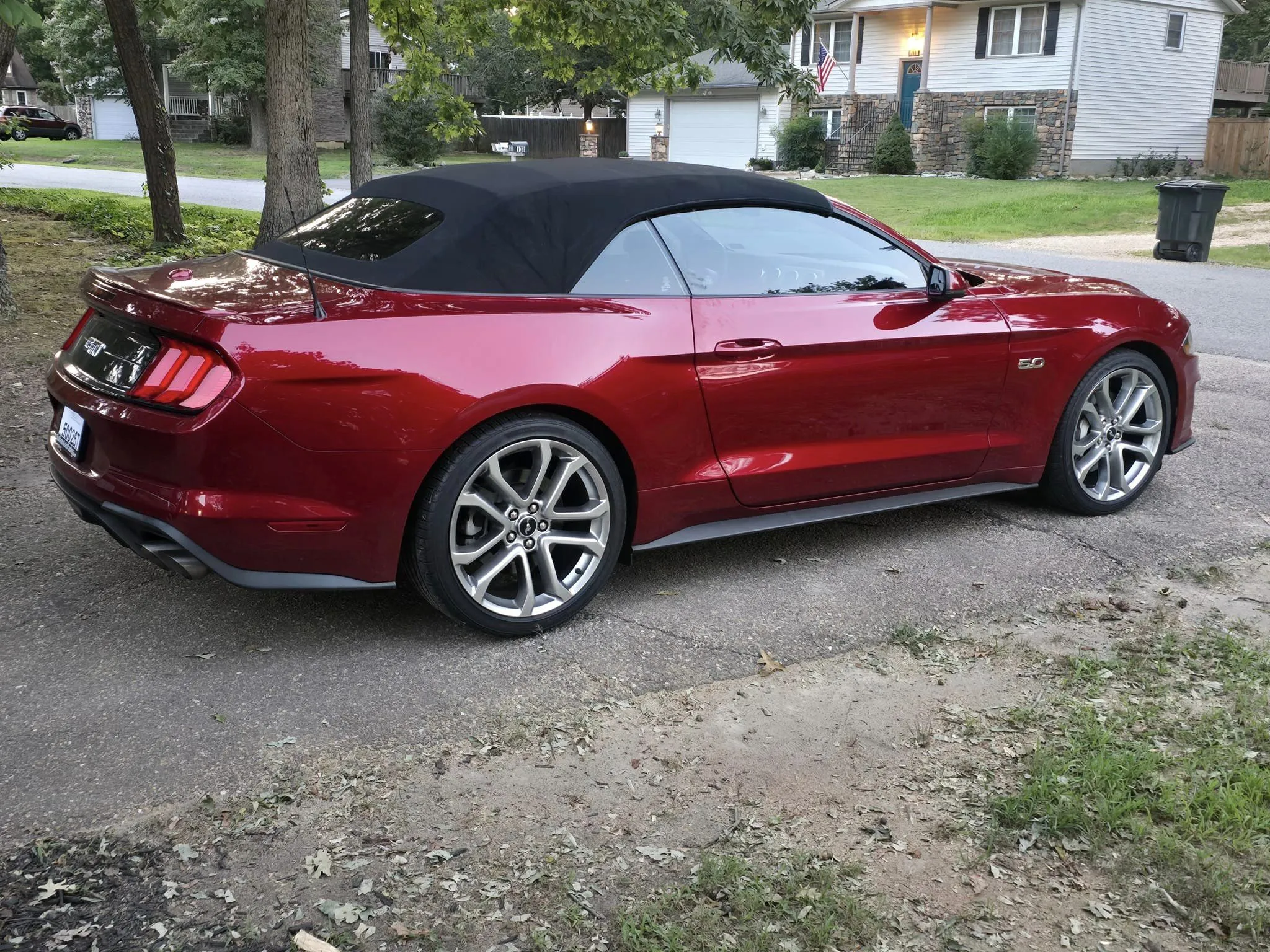

And, as will surely be requested by someone - be sure to post pics of your ride! Everyone here loves pics!
Here is a nice side profile of it.
