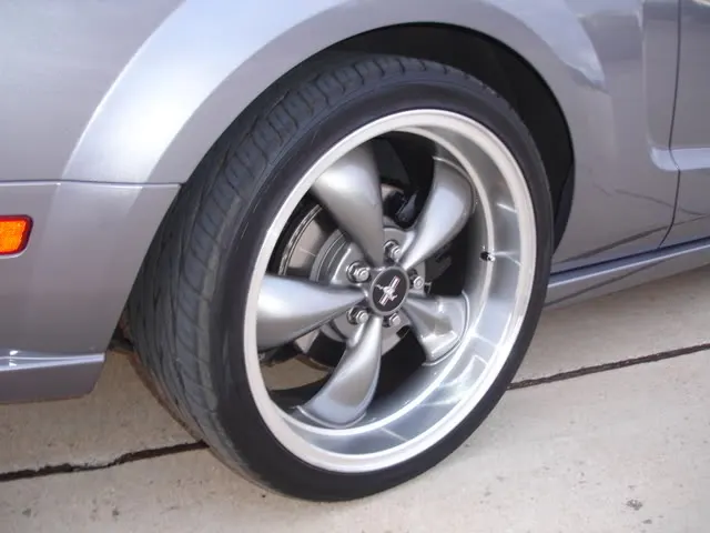

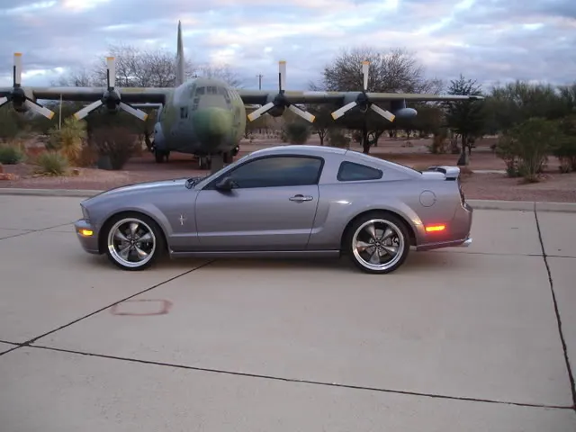

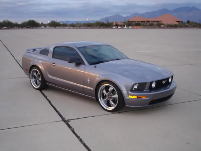

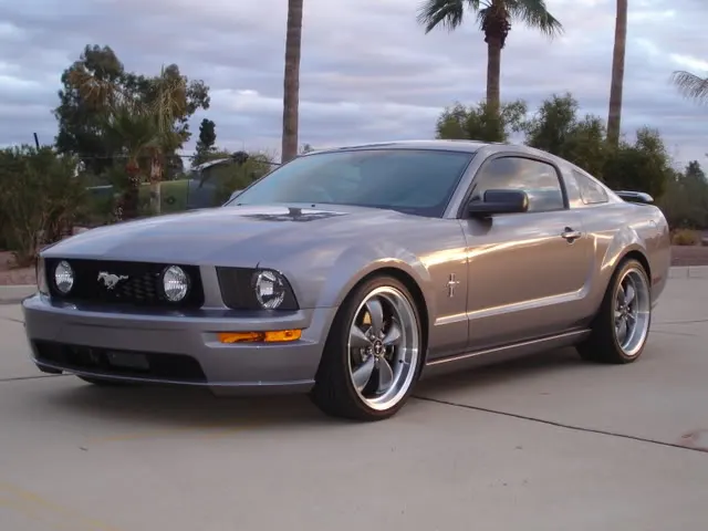

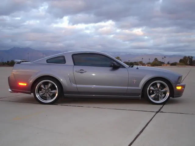

Here is my car with American Muscle wheels and Toyo tires 20x8.5 (245/35) and 20x10 (295/35). No problems with the FRPP lowering springs as well.

If you are ordering through americanmuscle.com make sure you are in the 05-07 section for wheels and the offsets should all be correct. I understand you fitment concerns, but with the setup I have there is no rubbing, scraping, or hitting at all. The tires are flush with the fenders and I can turn the front wheels all the way. Are you worried about the tires and wheels going past the fender or just getting wrong sizes? For the springs I went with the Ford Racing lowering springs, which lowers the car 1.5". Hopefully the link below works so you can check them out. If you have any questions I be glad to answer them the best I can. One more thing, get the staggered look as I would not be happy if I did not get that (20x8.5 and 20x10).
