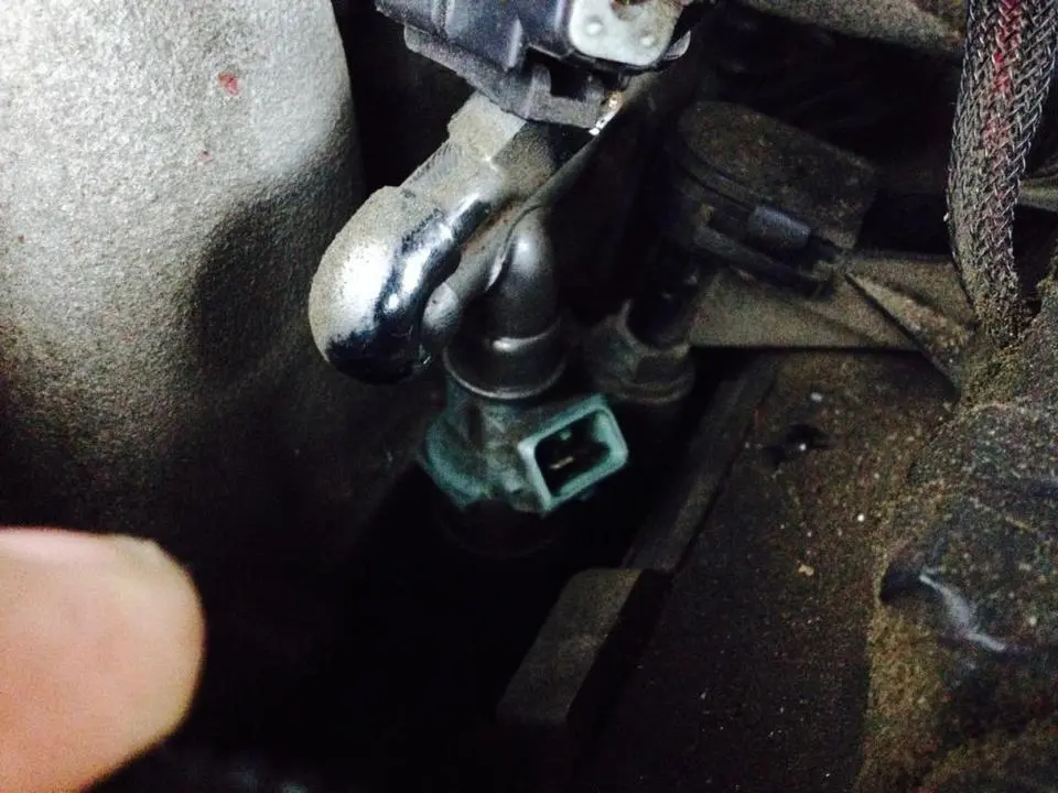

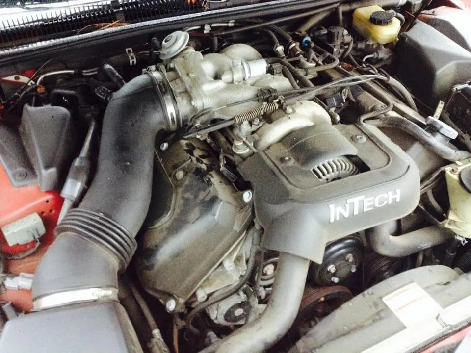

I was at the pick and pull today and I think I spotted injectors I can use. I want to confirm first. These are in a 32 valve V8 1997 Mark VIII. They are the blue injectors.
Are these the 24lb injectors that will work with my 92 5.0?
