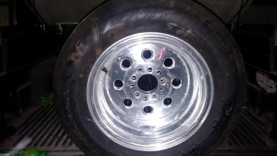

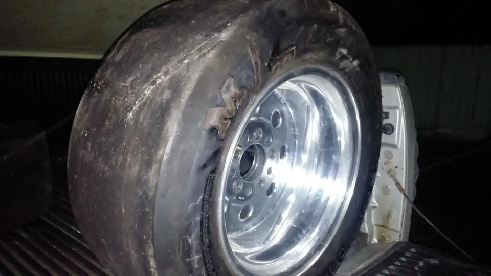

I picked up some Weld's 15x10 with some decent M/T ET Drag Slicks on them for $130. I was told they were on a fox before and more recently on a 99 turbo stang. I gather they dont use numbers like 315 30 19 on slicks? I did measure them from the ground up its 26 inchs. Im assuming they are 26 x 10.5 x 15 but not sure.
I had my bro in laws 315's on the fox and they would of worked with a little work so im hoping the 10 inch wide is gonna be ok.

If they have a 6.5" back spacing they should fit and work well.

They stick out way to much.. I need something else.. Live and learn

Oops. Yeah they have to be 6.5" or they stick out. I looked at a pair recently myself. They were 5.5" and wasn't going to work. On a 8" wheel you need 4.5" fyi and I assume 5.5" on a 9" but not positive on that
