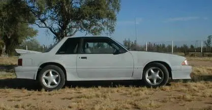

I have 245/45-17 on my 87 Notch and they do not rub the fenders at all, with the original fenders and the replacement fenders on my car, one from an 86 GT and the other off a 90 LX. And as you can see I do have my car lowered.
Because I have the 91 - 93 Saleen front valance on my car I just removed the fender extension completely because it covers this area. And even with my SVO/Lincoln 5 lug conversion there is no rubbing.

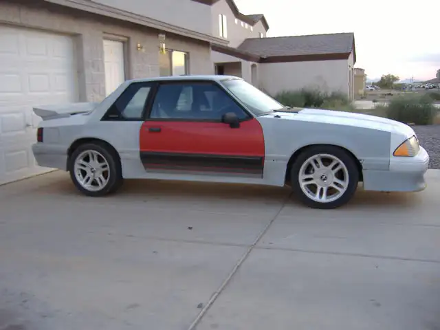

If you look at this older picture of my car this is with 94 16" Ponys and the fender extensions on the car. With standard size tires it rubbed and as you can see the Saleen valance doesn't fit properly.
