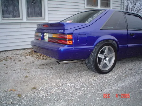

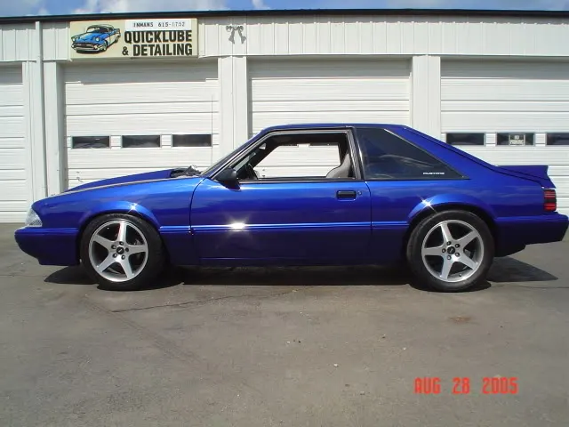

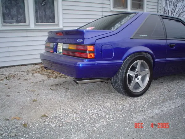

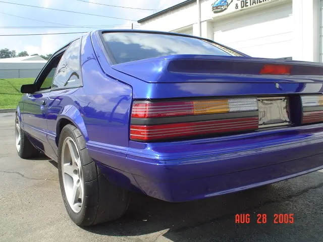

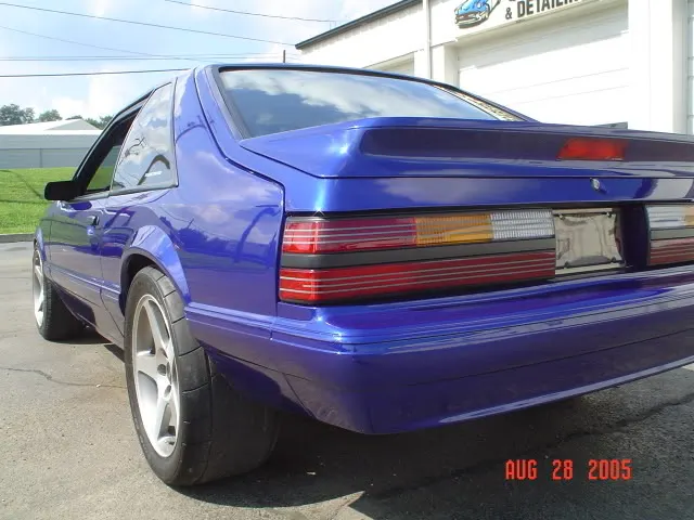

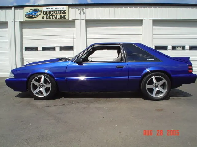

I have nitto 315/35 drag radials on the rear of my 90 lx. stock length ranger axles, no quads or spacers, no fenderlip mods OH and i just put tailpipes back on the other day:
What size are the back rims?? You really make those 315s not look big at all. Another concern with me is the appearance of the tire in relation to the rim. Im very picky and anal about it. In fact, when looking at the stance and stuff of a car its the first thing I look at. You know when you see a narrow tire on a wide rim and the tire gets oval shaped and it doesnt look broad or squared off on the corners, that looks stupid. Or when you see a super wide tire on a narrow rim and its buldging out on each side, that looks goofy too and unsafe because the tire wall will wobble. You want the rim to help make the tire appear like its wide, so you want the tire to be slightly wider or larger than the rim. Like when a skinny bikini string makes a girl look like she has that cute little baby fat and not the skinny crackwhore she really is, lol. Like that.
