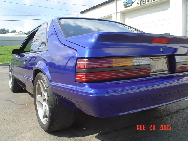

Yeah, I like the 10.5 inch rim due to the massive deep lip, and I've calculated the sizes and it should look just like a 245 on an 8 inch rim. I figured the 275 is 30 mms wider than a 245 and if you divide that by 25.4(mms in an inch) you get a little more than an inch wider tire and your adding close to that in rim width, so the 2 are about proportional. Now I just hope that these offsets supposedly designed for 94 and up, works with my 85. Usually its not a problem taking factory 8 inch rims off a newer car and putting them on an older car, but you throw that out the window when going with huge rims and weird offsets. Should work though, there isnt that much difference between the 2 models.
Nitto's run smaller than, say a BFG. That's why i can fit a nitto 315 on a 17X9. I don't believe a BFG would fit, they measure like a true 1-1 1/2" wider when you take a tape to them, even thou they are both 315/35. Different tire company=different real life measurements.
If it wasn't dark i'd go take a pic of the tire up close.

You'd be amazed what you can mount on what (well, no GUY would be amazed at that). Just because it will physically mount doesn't mean it's optimum. People put too much tire on too little wheel all the time. You don't see the opposite very often -- most of the time when you see too LITTLE tire on too big of a rim it's the low rider set with skinnies mounted on an 8" wide gold-chromed wire wheel stuck out of the wheel well about 4"...
Yeah, i feel ya...i mean, dang, look at the bulge:shock: :shock: :jaw: :shock: :shock:
SmockDoiley said:
I noticed you said you used a 5/16ths spacers up front. I had to use 7/8th spacers mininum to get my newer rims to clear the lincoln rotor. How did you get away with such a small spacer?
I did beat the dust cap in a little so i could keep the center cap.
But 5/16" spacers are all i need
