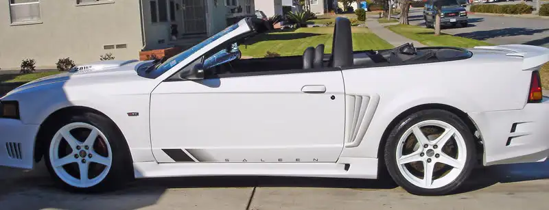

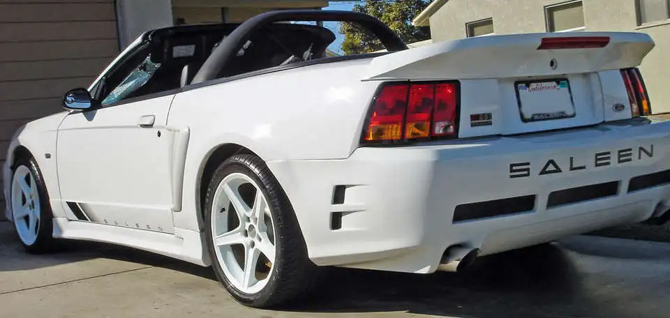

anybody got pics of 275s from the back? and can you put them on a 10.5 inch rim?
275/35/18 rears
Yes you can put 275's on a 10.5" rim.
