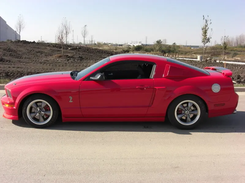

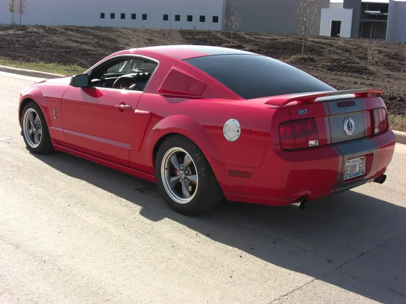

M&H's website recommends a 9 inch rim.
http://www.mandhtires.com/store.php?crn=70&rn=294&action=show_detail
here's a pic of them on my ride on a 17 x 9 rim...

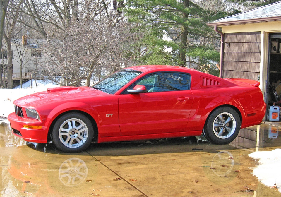

The 275 will fit fine on an 8" wheel. M&H tire sizes run quite small. I'm running the 325 on a 9" wheel and as you can see, it fits very well.
