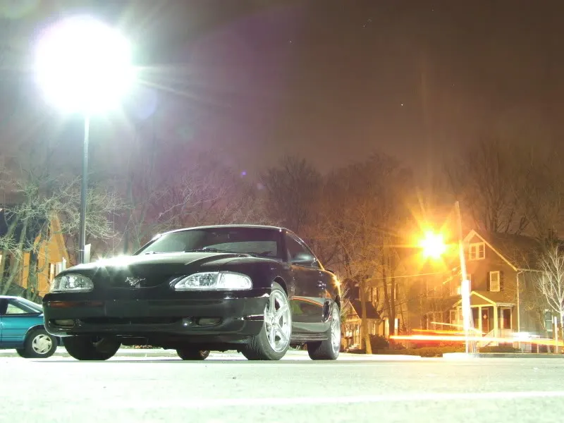

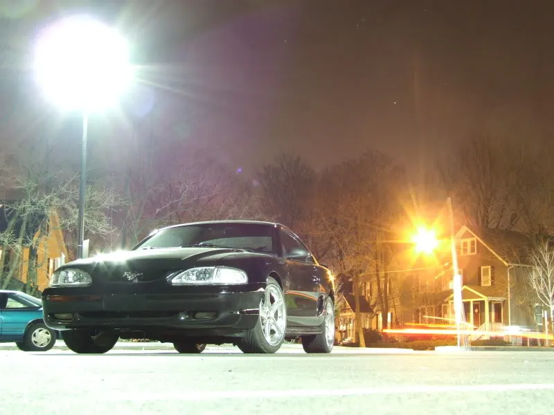

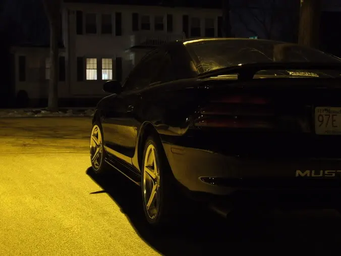

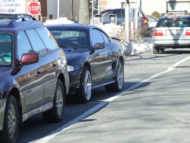

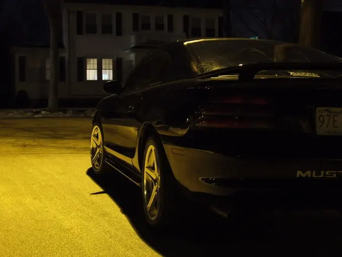

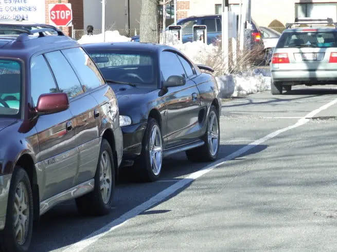

best pics i have right now. back are 285/35/18 front are 245/40/18 so you can compare
