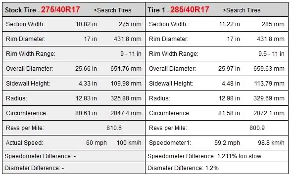

i need some rear tires bad and i managed to score a pair of barely used 285/40/17's for free. has anyone run this size before and how well do they fit a fox? i have 275/40/17's now on a 17x10 rim with 6.5 backspacing. quarter lips are already rolled and i have no quads. thanks!
Not a huge difference:
But I guess it depends on how tight it is under your car right now.
