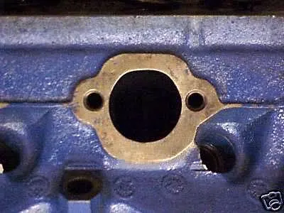

Actually, "their" statement about the C8ZE-B head, not having the two-digit number is incorrect. The main difference between the later service heads, and the pre '67 models are the letters HP cast in the top, and the later style intake flange....

Sorry Woodsnake; I made a correction to my response above. Throughout the years there have been many myths about the factory HIPO parts, and the devout HIPO experts, have sought most of their answers from Mannels book, and have adopted it as their book of reference. I believe that this is where this particular myth found it's origin. Whatever be the case, a few years back, I had several K-code guys, calling me, and telling me all about some "C8ZE-B" heads I had for sale. They had told me they weren't real "HIPO" heads, because they wouldn't have the 19, 20, or 21 casting numbers! I explained to them that Mine did, and they said that that would disprove all the known history that had been compiled about these parts. OK..... So I took a few pics, and submitted them to Mustangtek, for their head identification section. The gentleman at Mustangtek was very pleased, and asked for some more pics that clearly shows the corner casting numbers, but I haven't gotten around to it as of yet.....If you check out the C8ZE-B section, you'll notice that I've submitted a photo of a head cast in Aug. of '67, as well as a head cast in Oct. of '69. The intake/chamber side of the casting is clearly a C8OE casting, while the top is the standard 289, double dot. with the addition of the letters HP. They were both cast with the exhaust flange provisions for a thermactor port, but neither came with the injector, or bulge installed. If you look carefully at the pictures, you'll notice the numbers 20, and 21 referenced on the lower side of the intake area, and 20 cast into the '67 head, in the outside corner where usually found on the earlier designs. The other head sports a number 22, below the plug hole. You'll also note that Ford merely ground off the C8OE, and re-stamped it on the '67 casting. I've personally seen these heads with casting dates into 1970.
