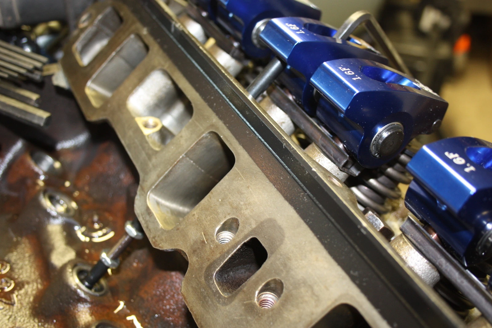

Attached are a few pics of my GT40 heads off a 93 302 cobra installed on my 289 w/ Scorpion roller rockers. My stock rods are too short. I just got an adjustable push rod and I'm gonna mess with it till I get a good wear pattern on the valve tips. Any suggestions on what length I should start with or you used?

My push rod length at zero lash and no pre-load on the lifters is about 6.87" and per my camshaft instructions acceptable preload is .030-.060" on the lifters. The Scorpion tech guy said .030-.080" of lifter preload is acceptable.

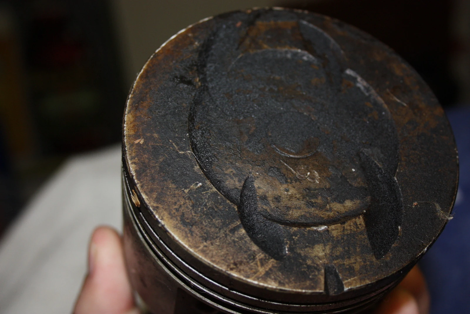

My original pistons where dished about the size of 2 half dollars side by side and maybe 1/8" deep (photo attached). My new pistons are .040" over due to the new bore and flat tops. My machine shop says this should make up the difference in compression and from eye balling it, I would say he is correct but I have no exact measurement or science here. If I loose a little compression that will be oK, its a street car and I would like to run 87 octane anyways.
I will post a photo of the new pistons when I do my compression check w/ clay hopefully this weekend. Wish me luck...

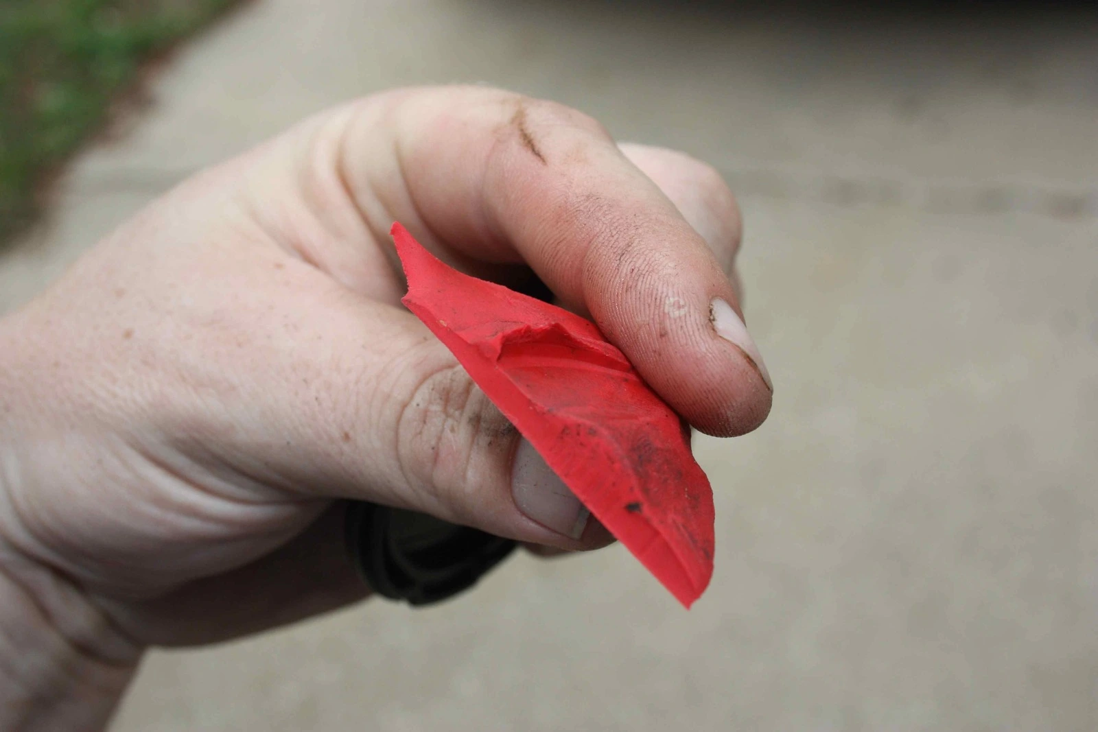

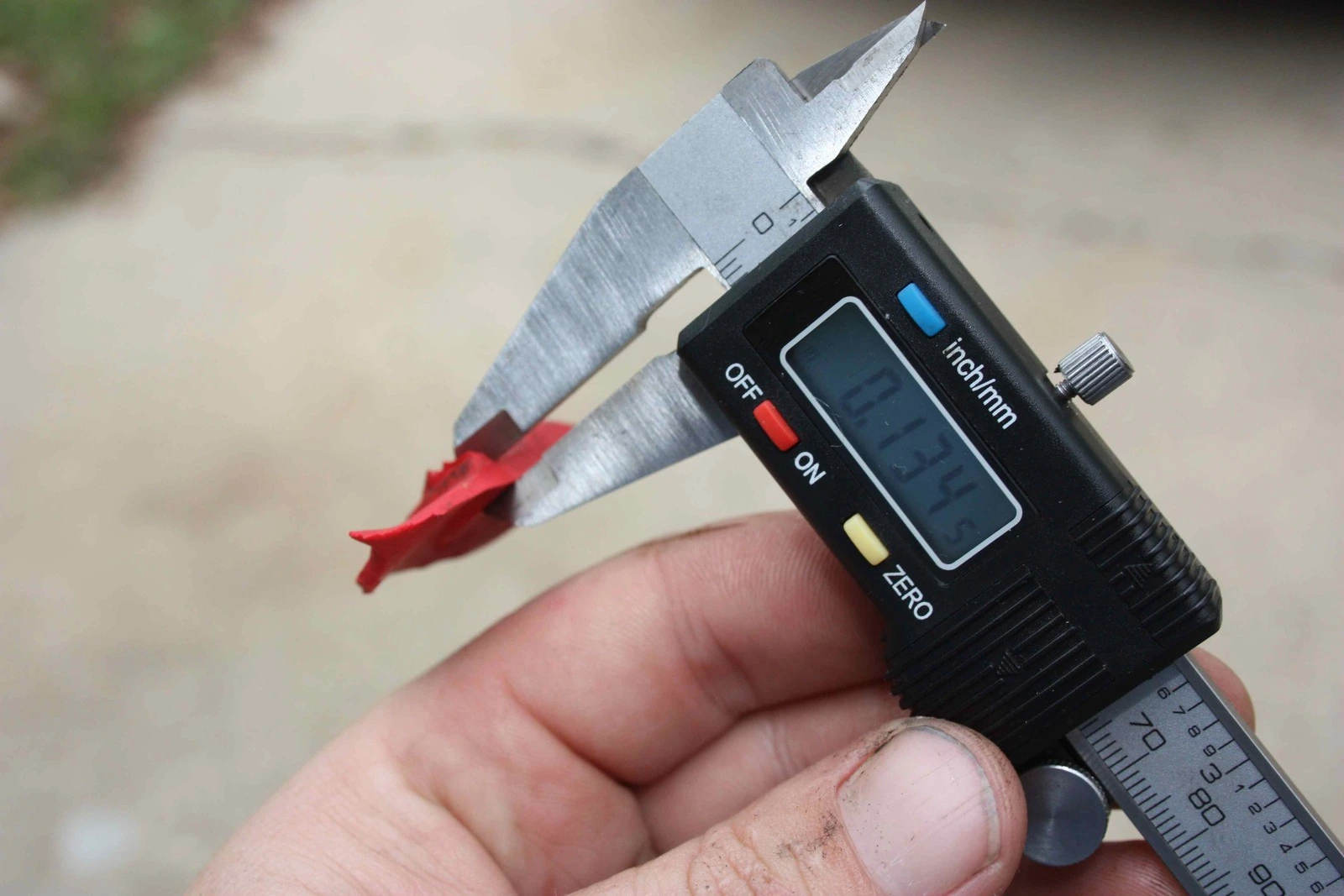

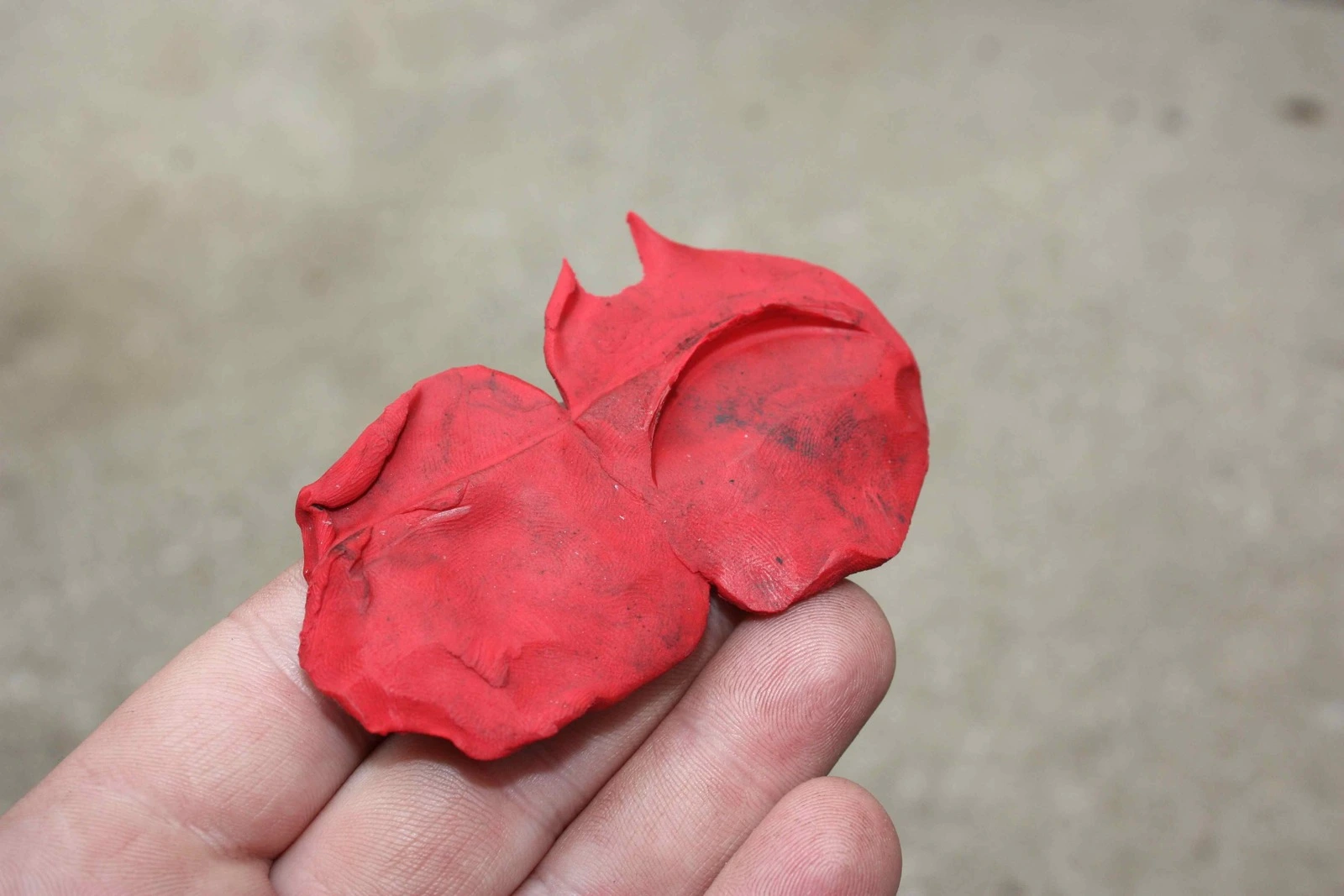

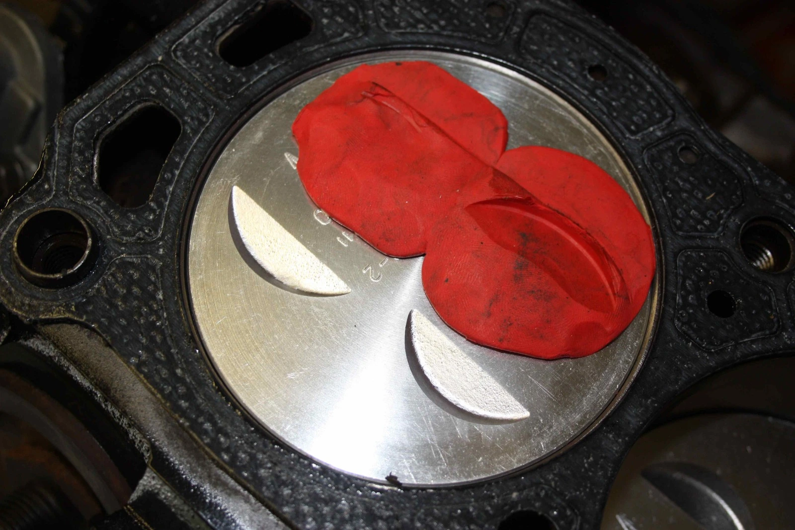

Did my piston to valve clearance test and the exhaust valve barley touched my clay and I got a minimum of 0.134" of clearance on the intake. See the attached pics.
Do you think I could have gotta away with 1.7 ratio rockers? I may see if I can get a deal on 1.7's in the mean time and sell the 1.6's. I got a steal on the 1.6 rockers anyways, paid $195 for a new but open item on eBay.

I assume you are running hydraulic lifters? If so, did you convert to solid or install checking springs on the valves prior to doing the p-v clearence test? Just making sure, because the hydraulic lifters can collapse under pressure from the valve springs and give you a false reading.
To answer your question about higher ratio rockers - maybe. You could certainly try them and see. Be certain that the clearance numbers you are getting are correct before buying 1.7s and keep the 1.6s until you know the 1.7s will work. I like your idea of trying the 1.7s though.

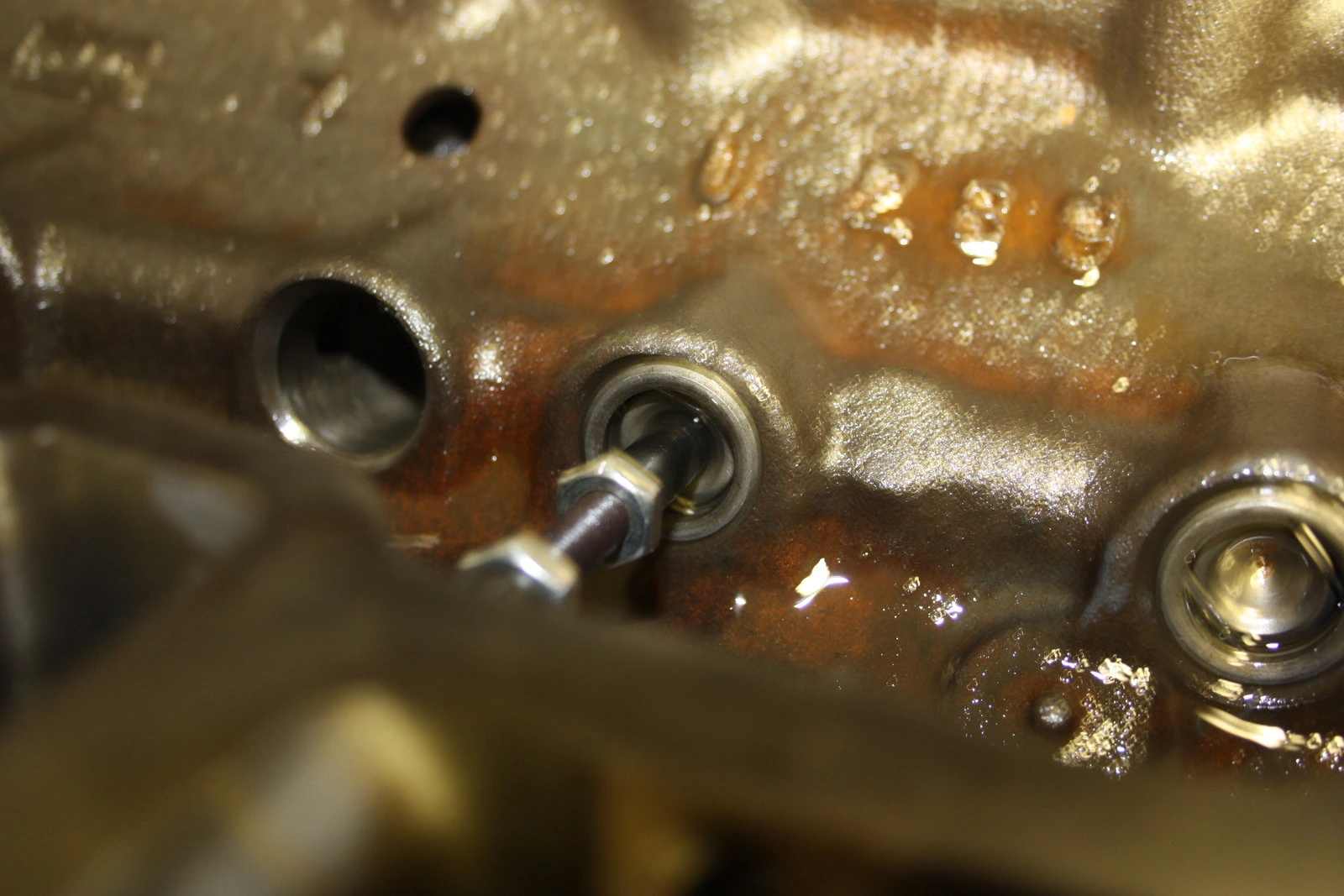

I was gonna convert to a solid lifter for the clearance test but a Scorpion tech said that it would be inaccurate due to the lifter seat can be at a different heights than the hydraulic lifter. So I extended my adjustable push rod to bottom out the lifter on a flat side of the cam and then checked the clearance. I was a little worried about doing this wondering if it would damage the lifter? I have another lifter set that came w/ my rebuild kit if I need them.
Sounds like your clearance numbers are correct. No - you didn't damage the lifter.
