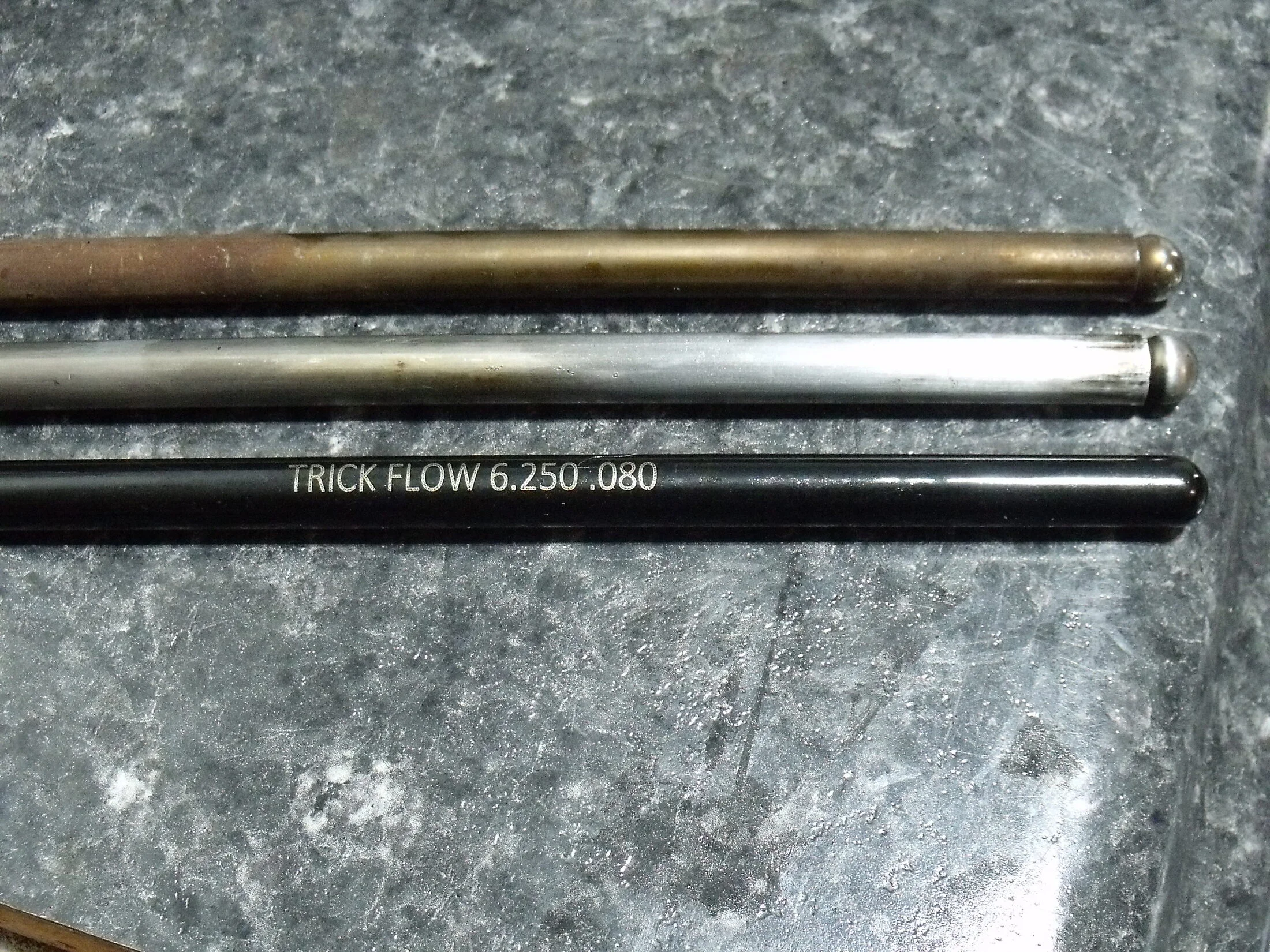

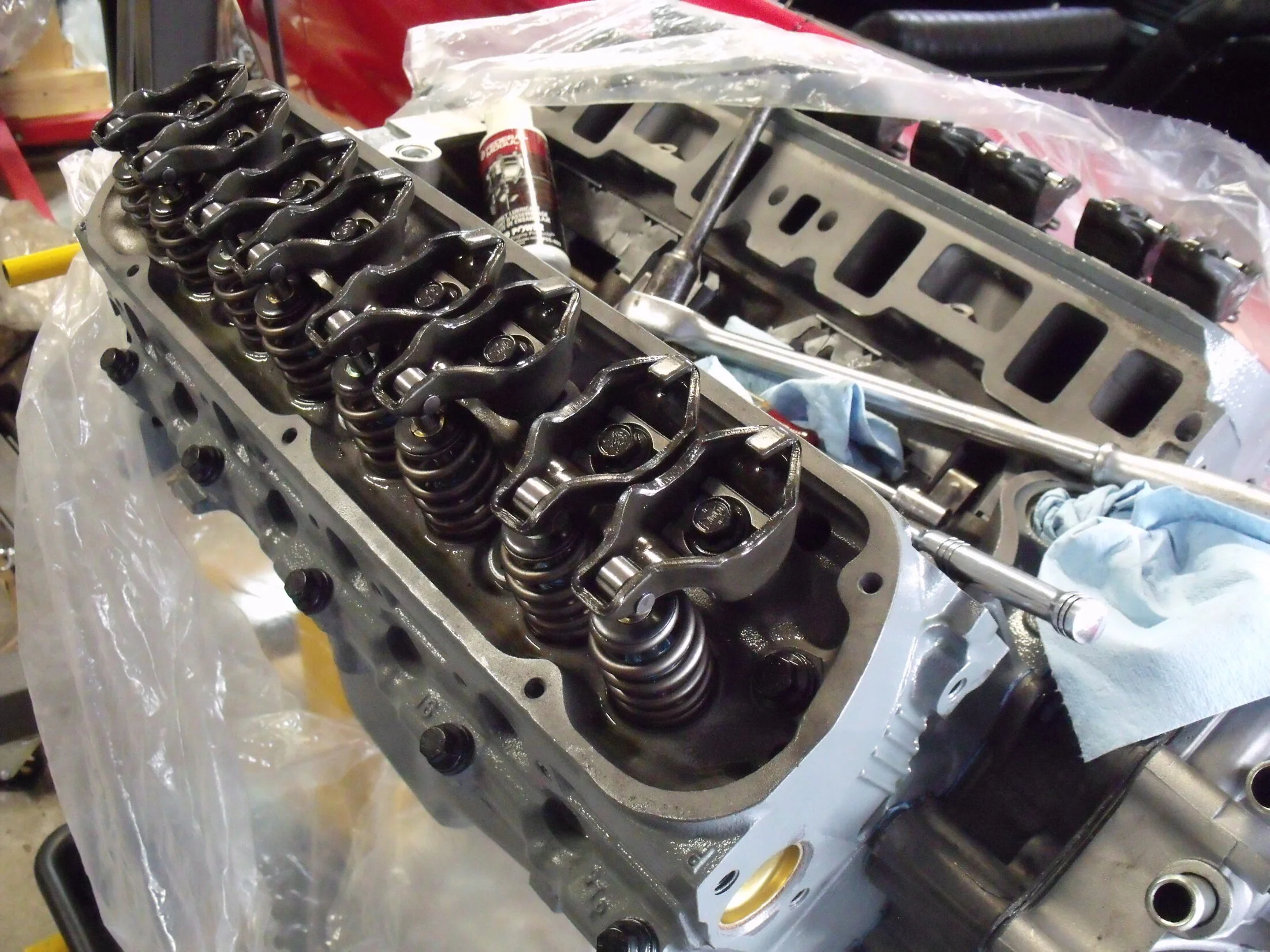

I just installed a TFS1 camshaft and a set of 3 bar GT40 heads on an otherwise stock block. The lifters were also replaced but are an OEM replacement from Ford. I am trying to reuse the stock push rods and rocker arms, but when I torqued them down, the rocker arms were very loose and I am able to jiggle the push rods up and down slightly. This would indicate to me that the cam might have a smaller base circle than the stock one but as far as I know, the TFS1 uses the same base circle as a stock cam. I'm wondering if this is normal with fresh lifters that have never been pumped up, or if I need longer push rods. Has anyone else running the same combo also had this issue?
Where is a good place I could find push rods that are a little longer or custom length?

Agreed, you need the adjustable push rod and the modified "solid" lifter to test it with, then measure and order pushrods in that length. I think I still have the tools here from when I did my HCI install years ago and doubt I'll need them again since my new engine will be the 4.6 4V so if you want I could sell them to you.
I concur. You will need to get an adjustable pushrod and make a solid lifter and check. Stock pushrods may work, but they may not be ideal.
I think this is the correct range you will need. Might be able to get off Amazon
You can also get the priming tool that fits in the dist to spin the pump and prime the lifters, but the initial check with the adjustable pushrod needs to be made with a solid lifter (use one of the originals and flip the internal cup to make it solid.

I got my adjustable push rod and measured the length to reach zero lash. The stock length push rods measured out to 6.250" and the adjustable rod measured out to 6.270" at zero lash. If I'm shooting for an extra 0.050" for preload, that brings me to ~6.320". However, push rods aren't very readily available in this length. I would like to step up to either a 6.300" or a 6.350" push rod because those sizes would be easy to get.
I read on a similar thread that anywhere between 0.030" and 0.080" of length past zero lash is acceptable, but this means that choosing the 6.300" puts me right at the bottom end of that range and choosing the 6.350" puts me right at the top end. My question is which push rod length would be best for my application between the two options I have outlined.
Perhaps I am missing something here..........
The goal here is after reaching zero lash, you want 1/4-1 full turn on your rocker bolt to reach torque spec..
My engine goal was 1/2 to 3/4 to reach the torque specs...
Thats what you need for the correct length of your pushrods....
I would want to double check my torque number, but I believe it was 22 FtLbs......
Okay I will try that approach then. Should be able to set the adjustable rod to 6.300" or 6.350" and then test to see how many turns to reach torque spec from zero lash.
If you have established you zero lash number with your solid lifter, now use a hydraulic for your " turn for final torque number......
Look for good geometry on your rocker/valve/pushrod, then check your rocker arm to valve contact with some grease.....
Adjust your intake as the exhaust starts to open.....
Adjust your exhaust as the intake starts to close......
When working towards zero lash, the claim is todays modern synthetic oils make the " twist " method ( rolling the pushrod till snug) not as accurate as the up and down method until no movement.....
Take your time and don't get in a hurry....
If my contact area needs adjustment how do I do that with the stock rocker arm set up?
Personally, if its not way bad, for a simple street machine no biggie... I would guess that MOST of us do not have optimal valve contact...
A high lift, high spring rate, racing engine..... Probably a bit more of a concern....
The perfect contact mark is LESS important then good rocker geometry
" The pushrod length sets the preload, shims set the valve contact"

No pics yet, I will check valve contact when my push rods arrive instead of using the adjustable one to make sure I get an accurate reading. I set the adjustable push rod to 6.300" and it took a little over 3/4 of a turn to reach torque spec after achieving zero lash for all the rocker arms, so that is the length I settled on.
