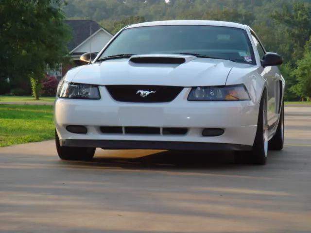

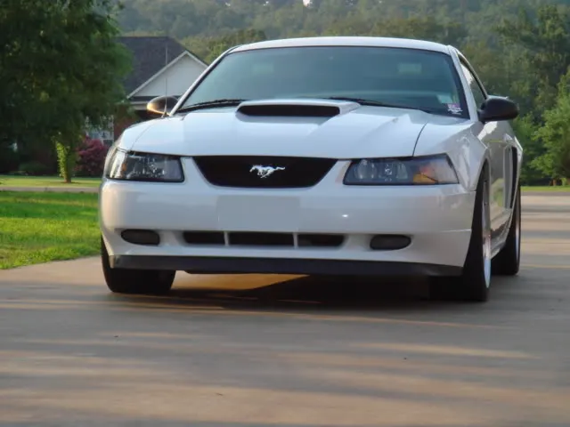

Hmm... For all of those who say don't go bigger than a 275 on a 9" wheel.... I'm currently running 285/35/18 GS-D3's on my rear wheels, 18x9's. I love them, but I want to go to a 295 and I probably will. Now that i've ran a 285 out back on a 9" wheel for a year, I wouldn't go anything smaller.
For a little comparison..
265/35/18 up front with 285/35/18 out back. Both on 9" wheels. Notice how narrow the front tire is compared to the rear. The 285's look great out back on a 9" wheel; gives it a real "meaty" look :nice:
My 275 bulged WAY more than that on a 9" wheel. It's all about the tire manufacture ;)
EDIT: Your car looks badass, by the way.

Just because they'll mount up and run on the road doesn't actually mean they're meant to be used in that capacity. Hell, you can stretch a 245 onto a 9" rim, but that don't mean it's the optimum setup.
The simple fact is that a 295 is way too wide for a 9" rim. So is a 285 for that fact. But, do what you want, it's your car. :notnice:
