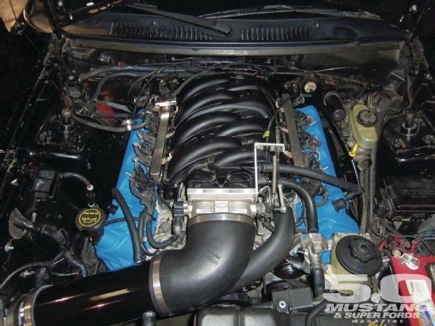

Here's my Logan swap 3v
See this is the route i want to go just because you do not see a lot of them. Plus its a direct bolt in. Around here i can get a low me 3v cheap. Was that your car in the mag? Or was that just an example of what you have done?

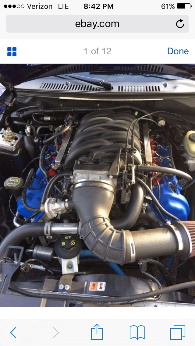

The reason I ask is because I bought a car with the swap already done. It's an 04 original 6 with a gt ECM.
It ran fine till I hooked a tuner up that wasn't married to it, now it is in theft mode so I now need to have it reflashed for the pats. I don't know if it had tuning done to the car.

If they swapped a 3v in, they probably used a 2005-2010 ECM to make it run.
You have pics of this thing? I want to see it.
Also, doing a Google search for "3v with 2v ecm" (I kid you not, all I typed) revealed that a company named Logan Motorsports did make a tune to run a 3v with a 2v ecm... Unfortunately, their website is down. (Meaning they're probably gone.)
That's actually pretty clean looking (was picturing a hack job in my mind... which after having seen some crazy chit people have done to their cars, and even drug to me to fix over the years... well, let's just say I was imagining something far crazier than that!).
I edited my post above with a little info I found... It's not much, but maybe there's another company out there doing the same thing that would be able to help you out. (If someone else here doesn't chime in).
I tried calling them on Friday. No response. It was done fairly well. Ran awesome till this tuner issue.
