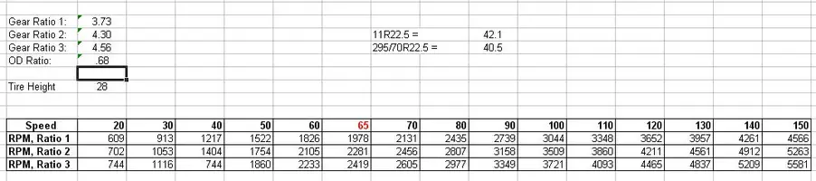

Check out the attached file
Exactly my point. Different motors/trans/tires will respond differently to gears. For example my friends fox went 10.06 on 4.10s
it's hard to make the arguement that you can go faster with 3.73s (he then went 9.9x with 4.30s)
