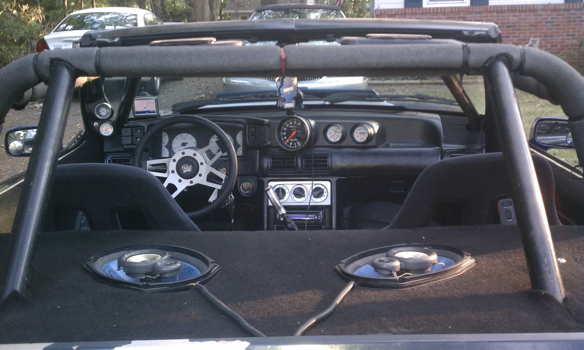

I deleted my rear seat and ran a 10 point cage. At first belts were bolted near the floor but after learning I moved them to the crass bar behind the seats.
These pics are from 15 years ago. I miss this car.
The roll cage was from S&W Racecars.

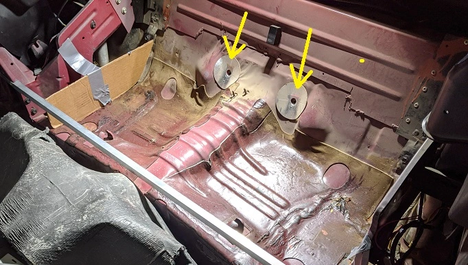

Well, I'm talking about the rear seat belt bolt holes behind the rear seat back, not the floor. I know you shouldn't angle more than 12 degrees down from the harness slots but these holes seem back far enough to avoid issues. The pictures of this 3 point harness on LMR show the rear strap going back to the rear seat mounts in a coupe, I'm wondering specifically if anyone has used these in a vert without a bar. If I have to do a bar I'm not using them but they seem like they would work.
