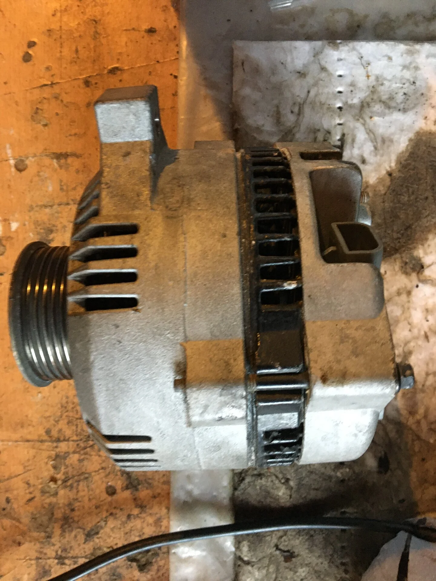

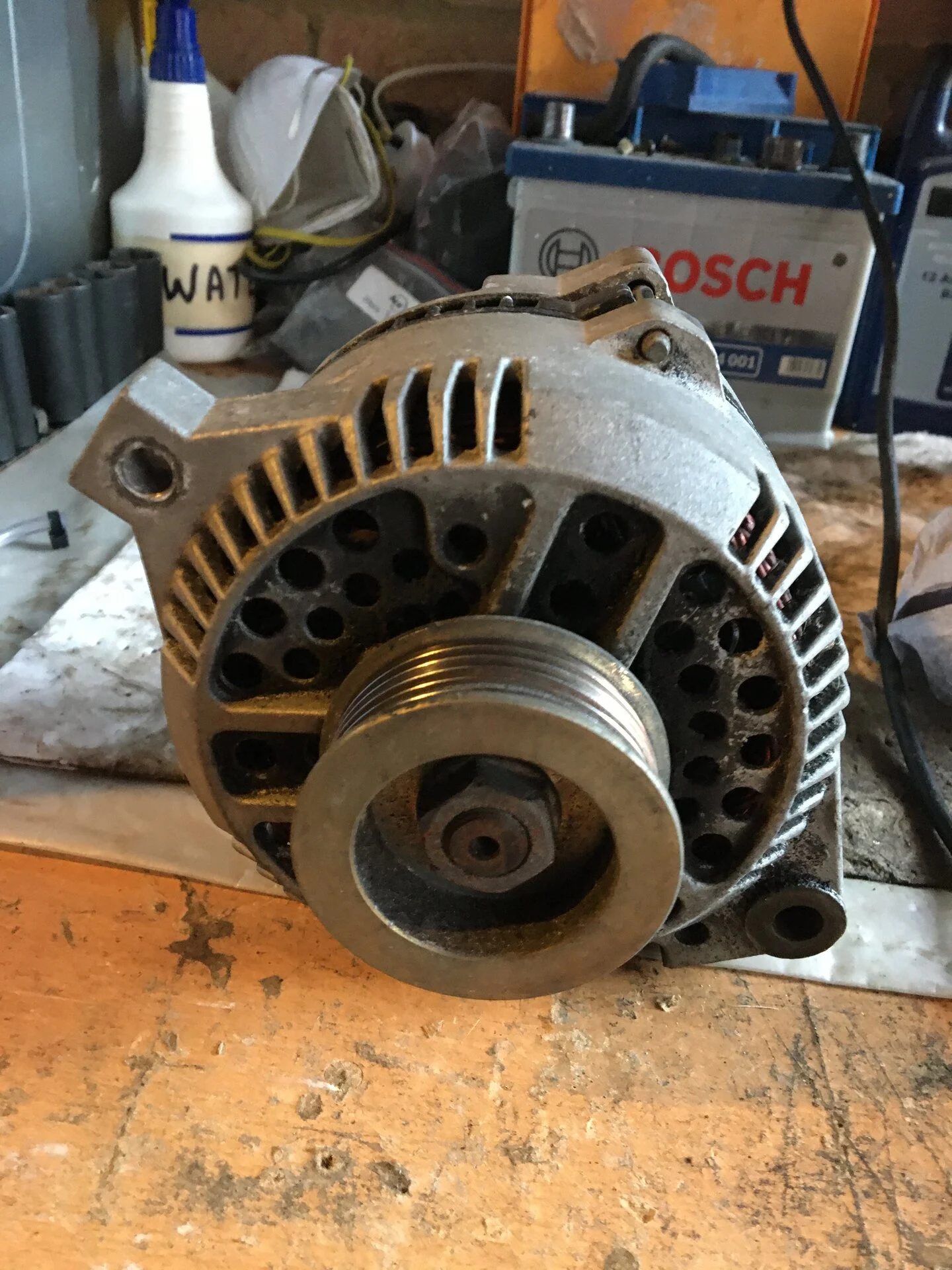

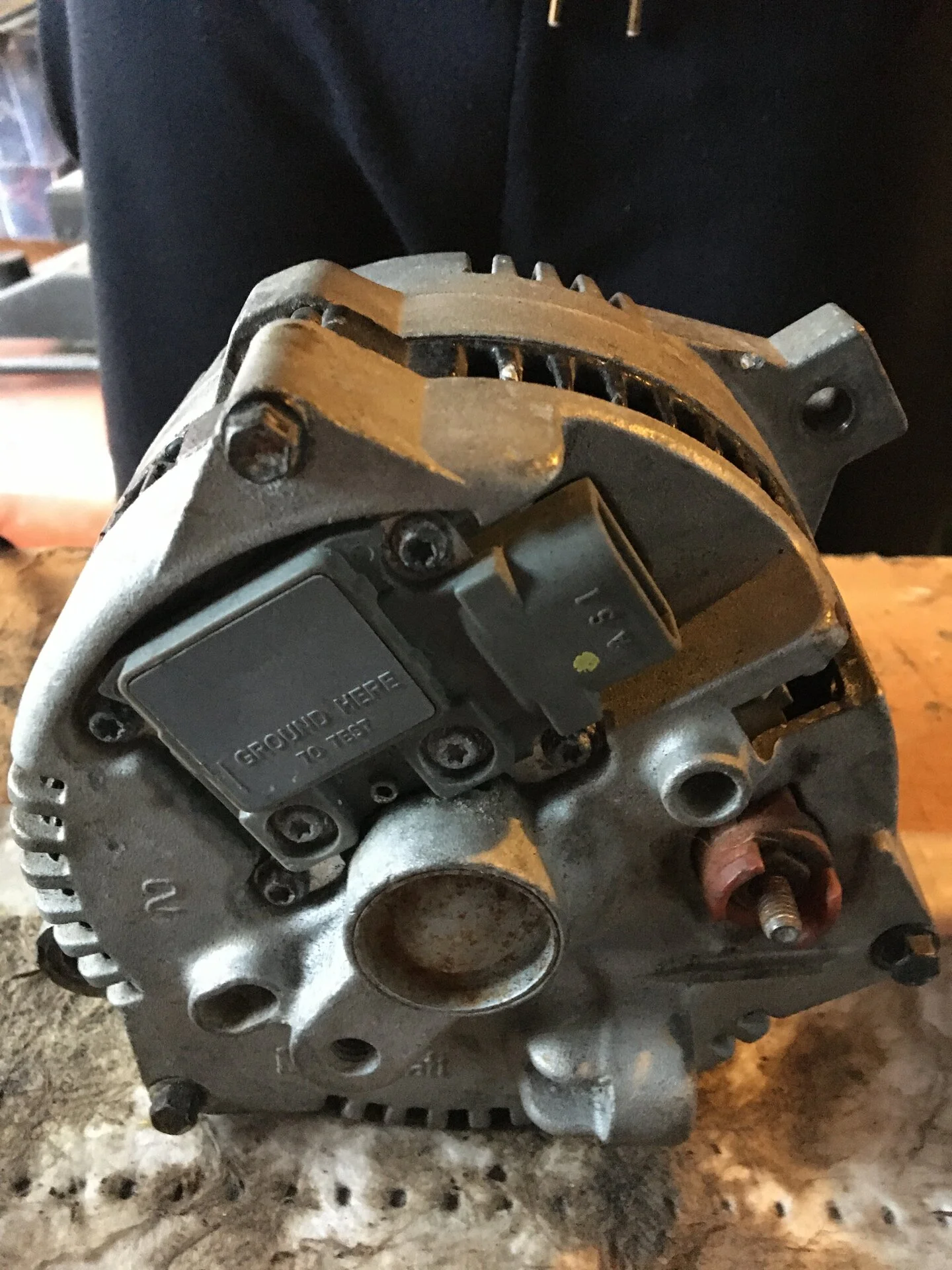

Hi everyone, I bought a car with 1990 302, the car has a fair few mods from headers to transmission, I’m changing the alternator but there is not a single identification number on it?? Can someone tell me if this is a 1 or 3g alternator please, all it has is motorcraft brand name and number 2 on it!
As it’s quite modified it may be likely they upgraded alternator too and understand there is a some wiring mods when upgrading to 3G so didn’t want to get the wrong one.
many thanks in advance

3g or 6G. Hard to judge its size by the pics
Appearance mostly. The 6g is a small case version of the 3g with better cooling, but I believe they are 110A. Came on 01-04 v6 Mustangs
this list is incomplete
I believe the 86-93 mustang alt us considered a 2G alt
