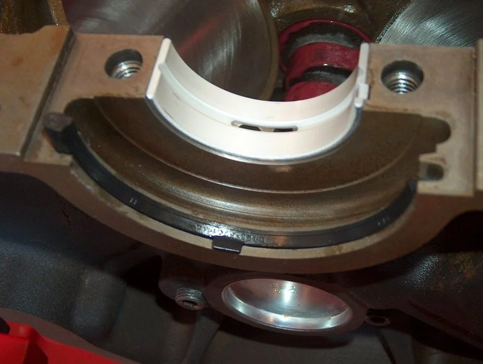

It's been years since I've seen one with a two piece main seal as well. lol. If I recall, I used to install them with one end of the seal sticking out slightly further than the other and gave the ends a little dab of RTV where they meet the edge of the block. After it starts to set, give the seal a liberal coating of oil. Make sure the small lip on the outer seal is facing the inside of the block as well. A lot of guys put them in backwards.
Found this pic with a quick google search as a reference of how the seal needs to go in....
