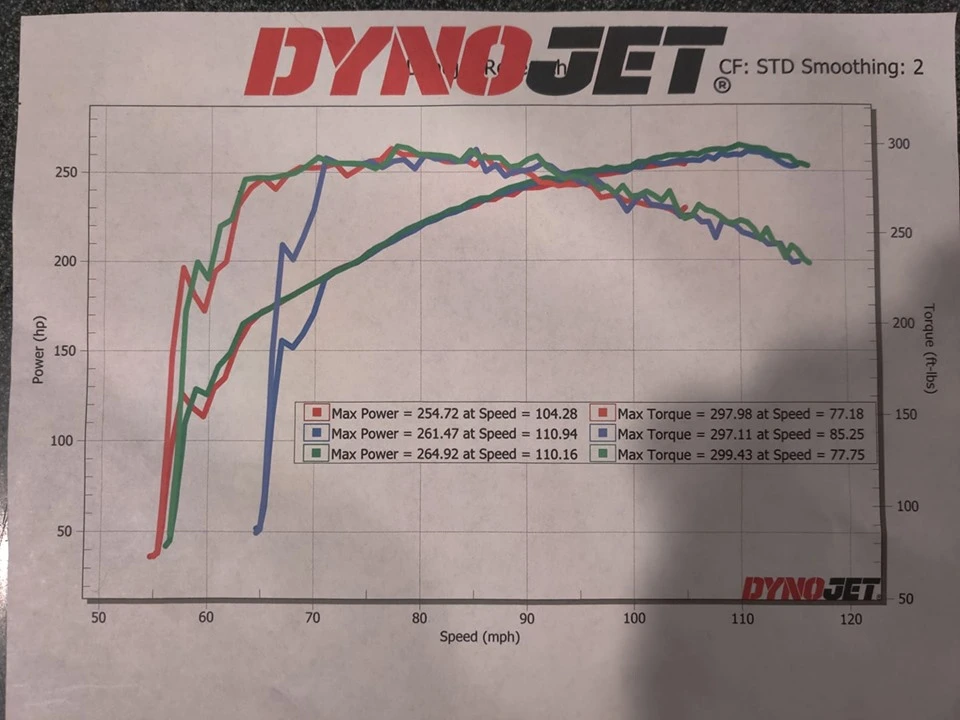

Not an apples to apples comparison, but the engine in my Cobra started life in a 68 Cougar. I rebuilt it with hypereutectic flat tops, added a Melling cam, Trick Flow heads, long tube headers, and topped it with an Edelbrock Performer RPM Air Gap knock off with a 650 double pumper. Here's a link to my dyno run and the first post.
I took the Cobra to a Fox body show and meet and greet at a local speed shop. They were giving 3 pulls for $50 so I said what the hell! It's never been on a dyno, I've always just used the Desktop Dyno numbers that I did when I bought everything for the 302 15-20 years ago. Those estimates were around 350 HP/370 ftlb iirc.
It's still running rich since I put the new manifold on it and took the carb back to stock jetting. I haven't taken the time to try and tune the carb yet at all and it showed! I asked about having them tune it and the price wasn't all that bad, so I may take it back to them at some point and have them go through it. I suspect my dyno numbers will increase once the A/F ratio is a lot closer.
Videos are currently uploading, I will share them when they're available on YouTube. :D
Given what you've listed, I'd suspect something around the same as I have, maybe a little less if you use the stock rocker ratio. Here are the specs of what I have for a cam, they have VERY similar specs.....
