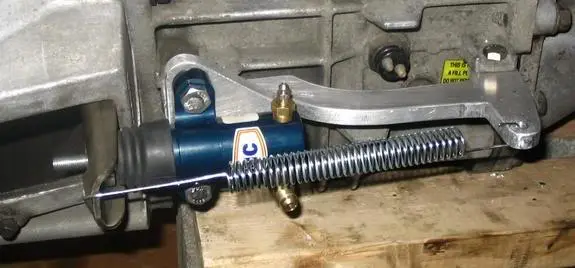

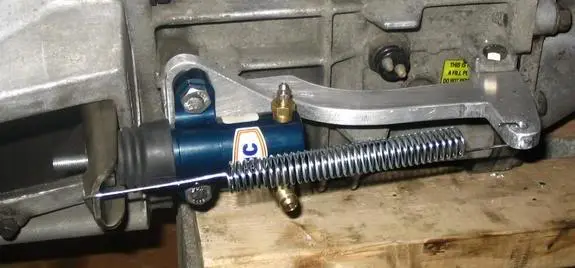

All you need is a slave cylinder and bracket for the T5.

i really like that slave setup... where i can i find that at? i def need that.

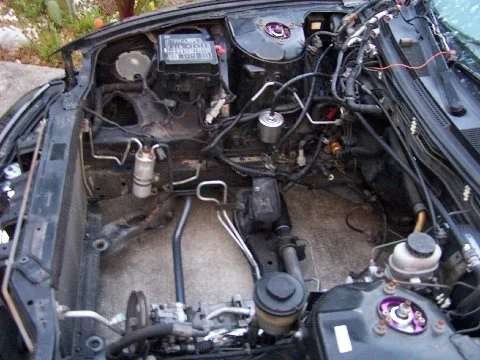

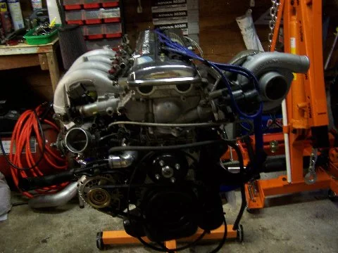

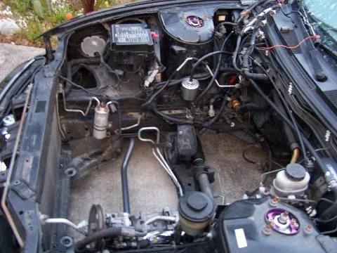

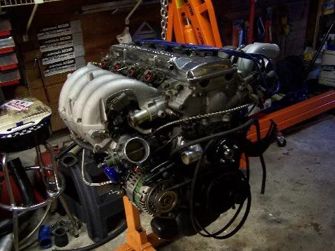

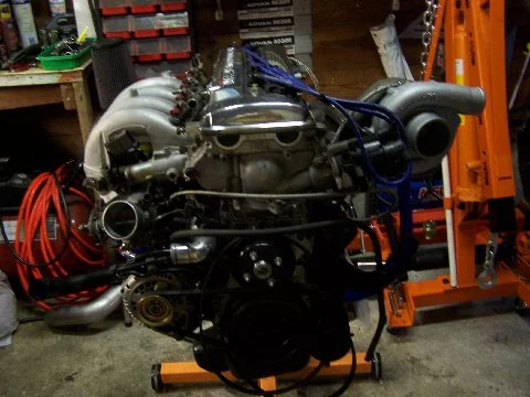

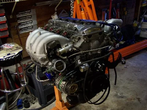

heres my last 240 i did just to give yall a heads up
and a money shot... the reason why i wont by a fox or a mustang period... because theyre ugly
this motor i full i built along with all new turbo components for about 4k. this was about a year and a half ago. i tuned it myself... needed money, sold it, and a guy from texas flew down here and drove it non stop from here in orlando to there. i just recently talked to him and he hasnt touched a thing on it. not to mention i was boosting 17 psi all day everyday puttin down 300/300. so the comment about the 240 rear end is BS. people are putting lsX motors in their 240s with the stock rear and they hold just dandy. do any of yall even know how much the ka motor weighs? its a iron block, plus i had all the turbo shlt on it, and ac/ps as well. handled like a dream. nimble as shlt, and very predictable. im willing to bet that with the setup i had in the s14 will weigh about the same as the 302 with the iron heads, or about 75-100 lbs heavier at the most.

where can i find these calibrated mafs you speak of? also, a link to that slave setup would be sweet too! yes, rod bolts are def on the list. like i said i want to do this as cheap as possible. what can i do with the stock maf and injectors and intake just to get me going down the road for now and do Al heads later down the road?
