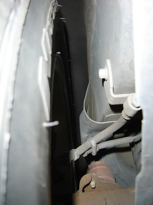

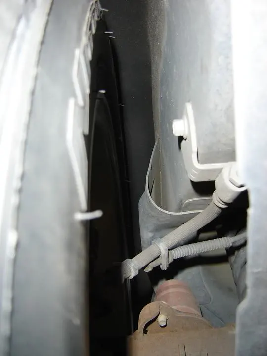

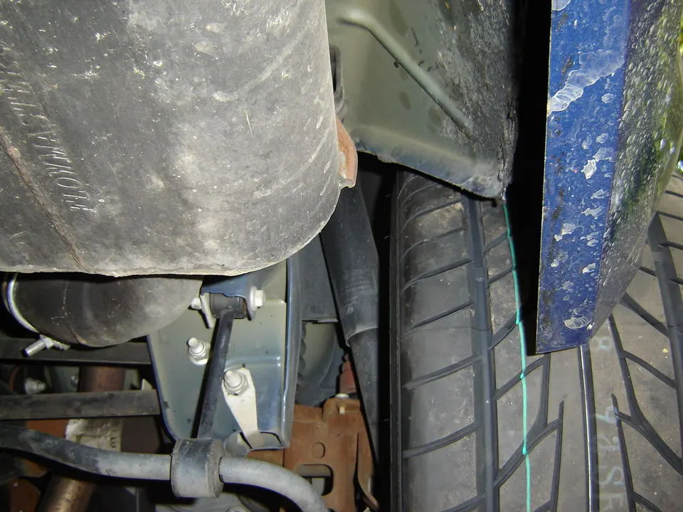

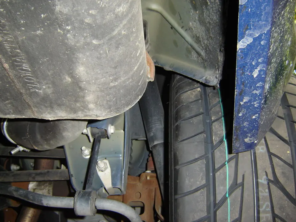

My Nitto 295/45-18s fit fine on the 10" wheel with stock parts. I have plenty of room both with the fender lip and suspension. I don't see why I couldn't go another 1"(.5" to each side")wider on the tire width.
