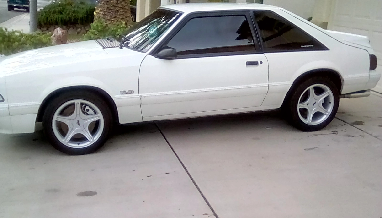

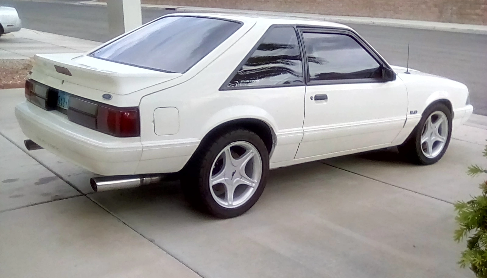

I run 245\45 17 with gt premiums all around no rubbing ever, but not lowered.

Do you like the 17's or the 18's better? What are your observations of each size in relation to ride quality, performance, and fitment?
