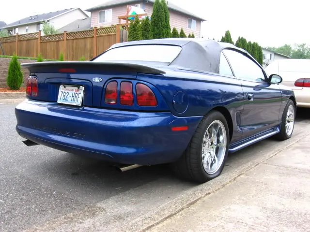

I ran them on my car until I sold them and put on my new wheel s and had no problems at all. Here's a pic of what it looked like.
I had 245/45 up front when I had the 17's. I know have 18's and summer tires I run 255 up front and 295 in back but I will be changing to a 305or 315 this Spring in the rear.
I completely eliminated my quad shocks and went with LCA's on the rear instead because my 315's wouldn't even mount on the car with them installed.
And the handling all together improved from the all stock 245 on each corner.
