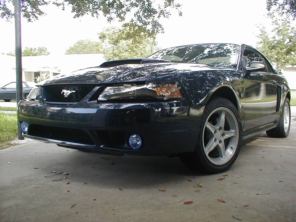

I ran some 315 Nitto drag radials on my 17x9's a couple years ago. They fit fine and the treadwear was even all the way across. I don't think I would try it with any other tire though, as those Nitto dr's tend to run narrower than most 315's.
Here's a picture with them on...
For comparison, the fronts in that picture are Sumitomo HTR+'s 275/40/15's

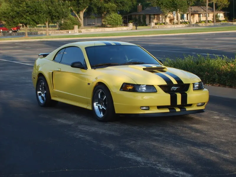

Tim is spot on - the Nitto DRs run small and a 315 fits a 9" rim perfectly. Here's another photo of a Nitto 315 DR on a 9" rim...
Thanks!
Chris
