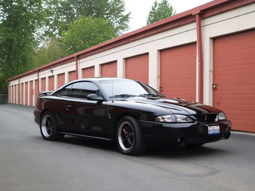

The wife's car with GS-D3's on it:
I had to flip the quad shock and rotate the passenger's tailpipe in just a bit for clearance on install. After that, the tires rubbed on the inner wheelwell a bit under hard cornering. I took off the rear wheels and massaged the wheelwells a little with my BFH. All is good now.
Different brands of tire in the same size can have slightly different overall dimensions. The Eagles seem to be one of the wider ones out there.
