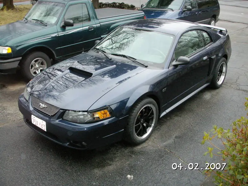

Heres a pic before:
And After:
The Eibach pro-kit doesn't lower it a ton but it gives it a good stance. Mine is a tad bit lower now cause I removed the back isolators when I did the LCA install.

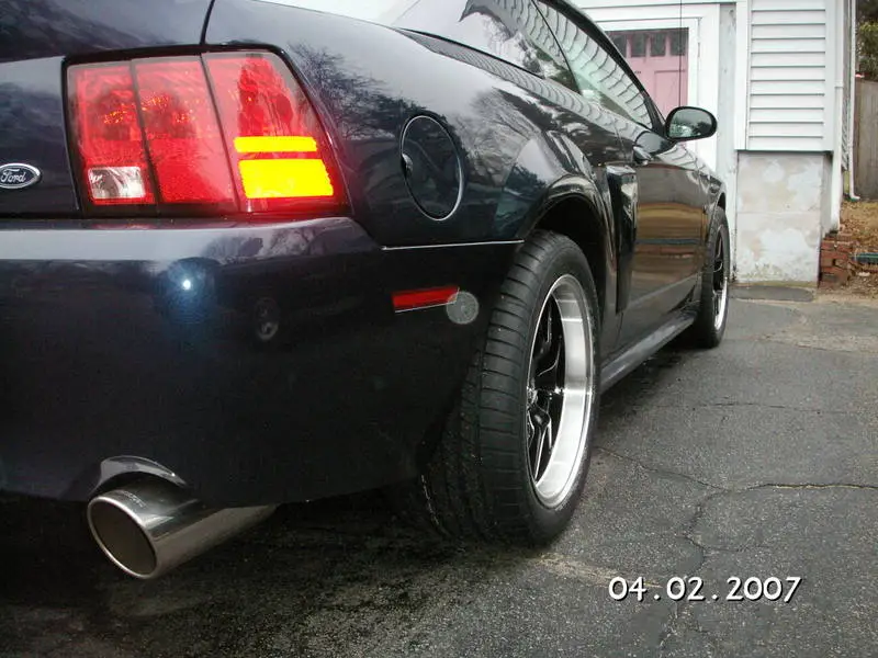

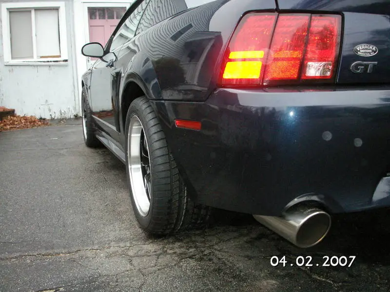

alright finally got some descent enough weather to put on the FR500's. What a difference. What do you guys think?
