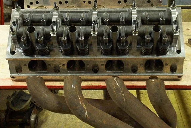

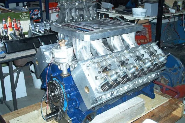

I have been looking at some of the other threads about the MII front ends and did not see what I was looking for so I wanted to ask any that may know here.
I am going to be welding on a extended MII front cross member + suspension on my chassis as I want extra room for this 32 valve 428maxx engine and been looking if there was still a power REAR? rack option with this/a MII setup?, in the past I thought I seen this option in some old mags using/keeping the older stock spindles?, anyone here know of this option?, I thought rear rack could be better for big tube headers?. Also where would be best place to get rack extensions from today?, thanks for any info.

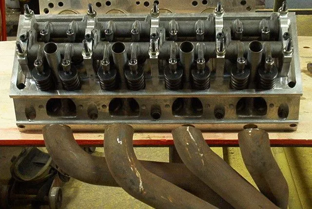

I was googling a bunch of stuff and maybe I got this rack thing mixed up (its been awhile), anyone got some input on which rack setup (front or rear) would have better/more room for long tube headers?
Thanks rbohm, after googling more I realized I screwed up in what I had been thinking for this 32 valve head setup. I got a set of big tube/long tube headers to fit with new N type flanges for these dominion arao 32 valve heads and I am sure some lower mods will be needed too, just wanted to pick the easyest way. Now I got to look for a new rear sump pan.:shock:
