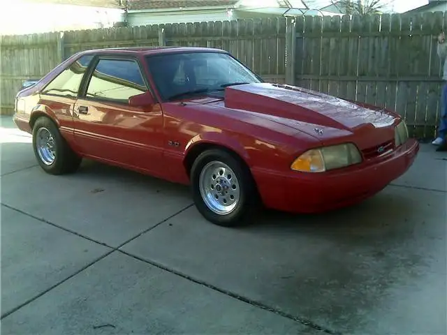

hey i am new to the site and kind of the mustang world
i have a 1989 mustang lx
331 stroker
12.5 to 1 comp
eldebrock performer heads 202s
funnel web intake high rise
proform 750 cfm carb
underdive pulley
msd ignition and distributor
4.10 gear
c4 with 3800 stall
holley fuel pump
7qt pan
2800 lbs
110 torco
mt et streets
i was wondering what kind of hp and 1/4 mile times could be possible with this car i have no idea
thanks for looking and for your input

thanks for helpin out and yea i know its hard to determine
all i know is the lift on the cam is 620 a custom ground one and i shift at 6700 it can take more but i dont want to try more until i go to the track and see how she does ...which i will soon
1.72 roller rockers , lol i keep thinking of more stuff
long tube headers 3 inch to turn downs with flow masters
and it is tuned very well extremely responsive
Wow that's a big cam....that gives you a lobe lift of around 387 so with the 1.72's your total lift should be about 666 if my math is right , unless that 620 lift is WITH the 1.72 rockers (seriously...not making up the 666 stuff...lol). The intake you have is arguably the meanest single plane intake you can run with a carb...it'll flow well past 8k RPM. I'd say your HP numbers are closer to the 450-500hp mark...should be at least a high 10 second car. Any idea how much it weighs? It would still be worth taking to a dyno and making sure the air/fuel ratio looks good with the race gas and to see where your hp/torque peaks are at...that'll tell you where you should shift at.
damn thats better than i thought it weighs 2800 give or take 100 lbs because that was with mustang seats and the radio and door speakers
now i have race buckets with stereo totally gutted
