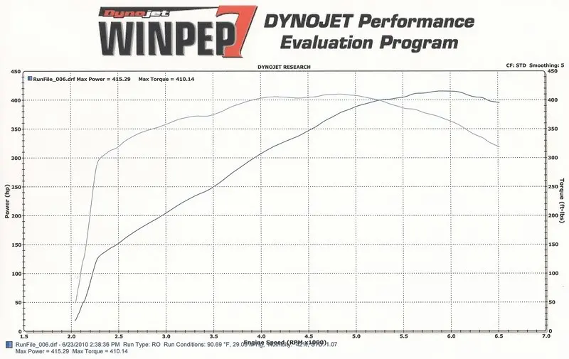

The results....
415rwhp...410rwtq!!!
Here's the graph:
To say I am thrilled is an understatement. This car is almost too streetable to make power like this. LOL! For years I've been saying how streetable it is so on the way home I video'd a little street driving to show just what I'm talking about. Here's a video on the dyno and my little streetability example:

Absolutely stupendous numbers for a low compression N/A 331 Paul. A torque output of at least 1.0rwtq/ci over a wide 2600-6300rpm band speaks volumes for the efficiency of the engine, so I can only imagine how much more efficient it would be with a 10.0:1 compression. You'd probably get ~20rwhp/20rwtq more.
Awesome numbers, that curve is great.... Must be that engine builder:D
As far as duty cycle on the inj I would assume its pretty high up top, what did you end up with as a base Fuel Pressure. I know in the past 2 years I have started running smaller inj then in the past, mush easier to make things streetable with out fouling plugs...and now you see how much power can be had from a 30lb'r.
Assuming a 17-18% driveline loss your making about 490BHP :nice: You wont regret tossing on the turbo, but you wont use 80% of the new power on the street. I'm a little more generous then Chris, Ill give you $1050 and I'll come pick it up..lol

Again Paul, great numbers. the torque curve is better than what i thought it would be. I'm with Troy though, put in a turbo cam!
Is your water temp gauge working? From the looks of it you were around 230* from what I could make out.

Grady- I was happy with the peak numbers but the area under the curve is what really impresses me with this combo. It picked up a lot more down low and in the mid-range than I ever expected. The SOTPM told me that it picked up a ton when I put these heads on, and now I can see why.

blksn955.o- You are observant! The autometer sending unit is located in the back of the intake in a blind coolant hole. If I get into traffic or idle for a while when it is hot like it was that day it'll creep up to 250 as it heat soaks. I don't even look at it anymore and I knwo the factory gauge works and I can see by my AEM datalogs that the coolant doesn't get above 190* One of these days I'll put the autometer in the stock t-stat housing, I just need to find time to do it. And thanks for the compliment on the combos, I appreciate that. The plan is to put the FTI cam in the cobra once I get a way to tune it and once I decide if the new cam for the 331 will be a turbo or NA cam, and if it'll be a SR or HR cam.
