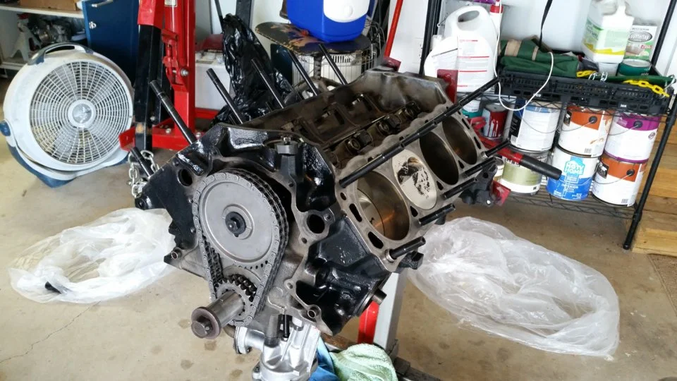

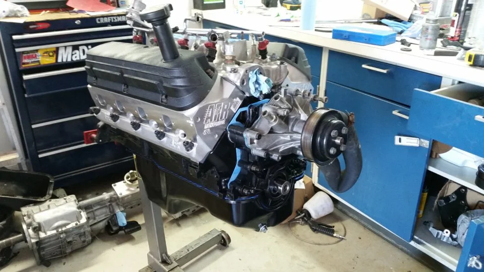

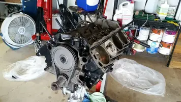

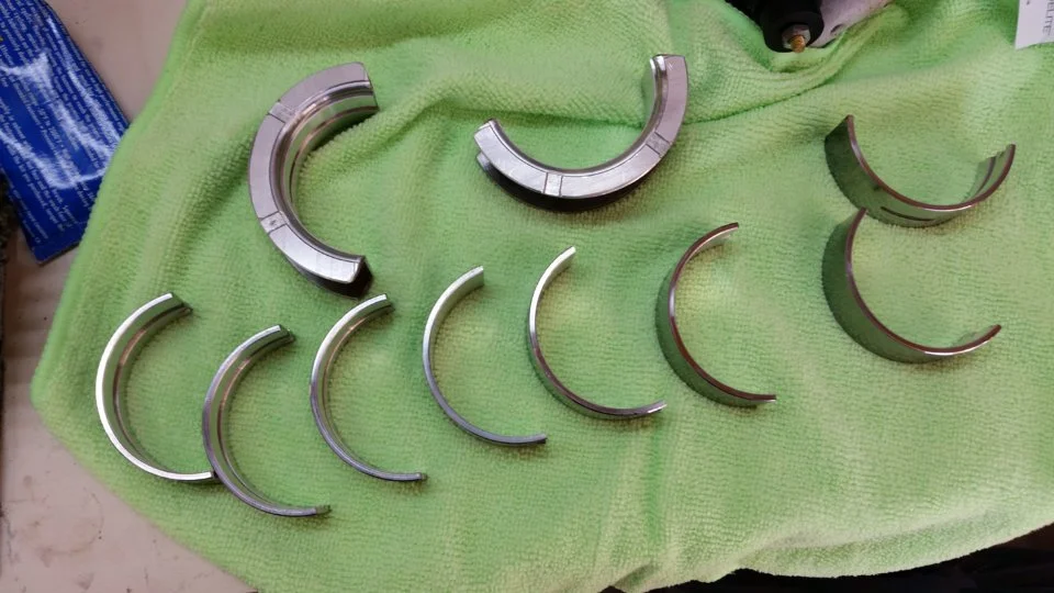

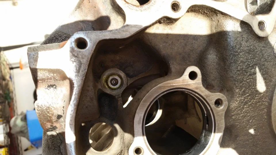

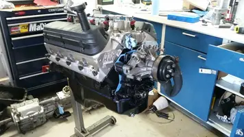

Here are a few pics. We put in an oil galley plug with a .030 hole to provide oil to the distributor gear. Pic of the new main bearings getting ready to go in. Another pic of the polished crankshaft, and finally my stopping point for the day.
Joe

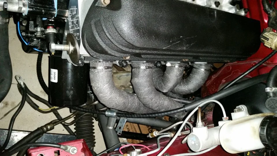

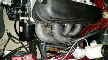

The wife and I hit the beach for a few days, so I didn't work on the car this weekend. However, we got home tonight and I scored an hour or so in the garage. The good news is that my headers work with the stock steering shaft!
Progress will be slow over the next month while I button things up 15 minutes at a time. There is normally a Christmas race in Calhoun in December, so I would like to have some break in time on my clutch well before then.
