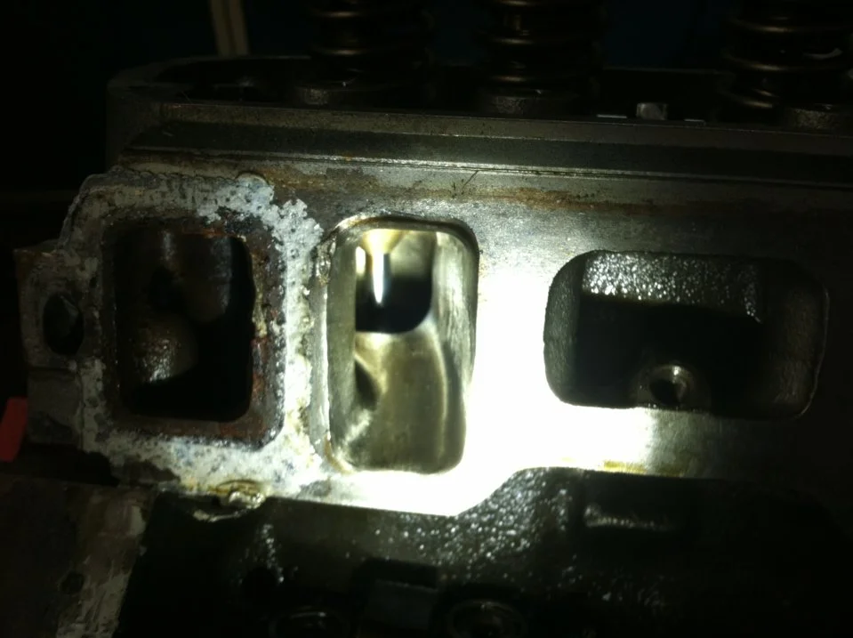

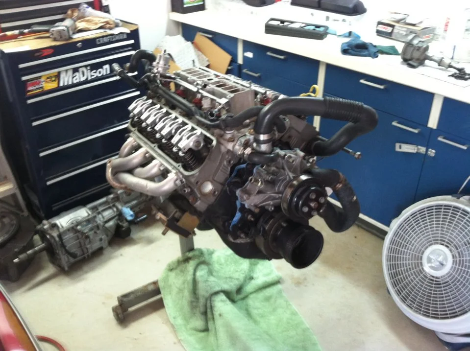

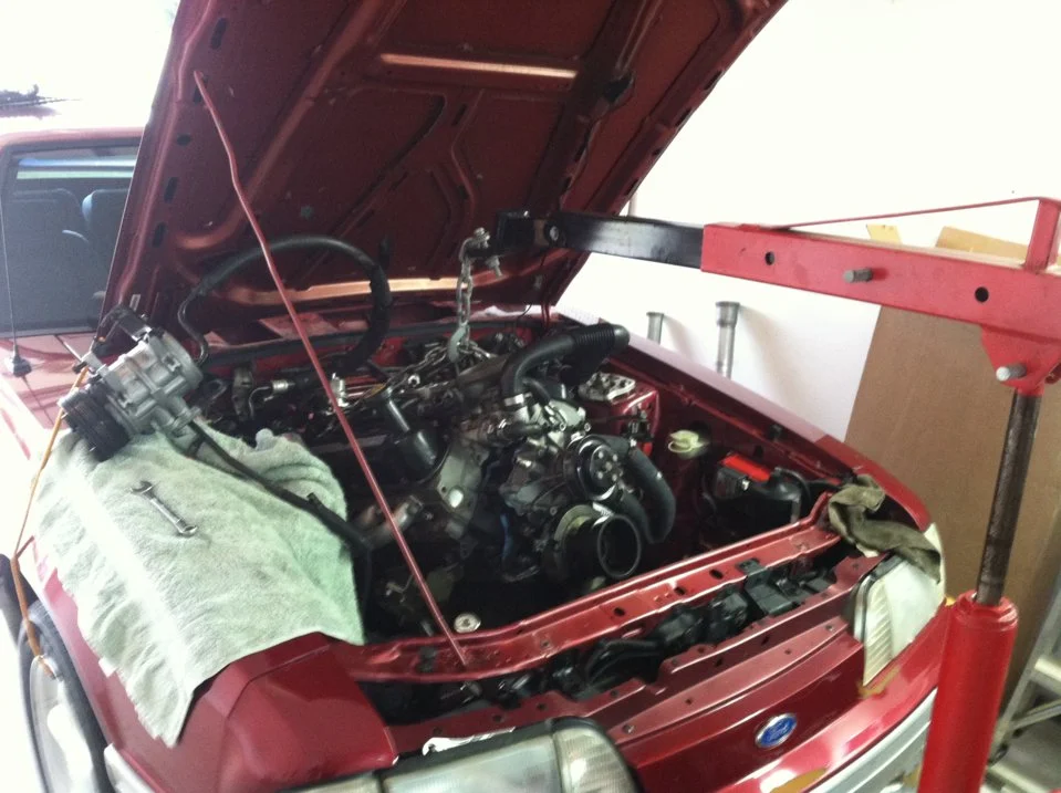

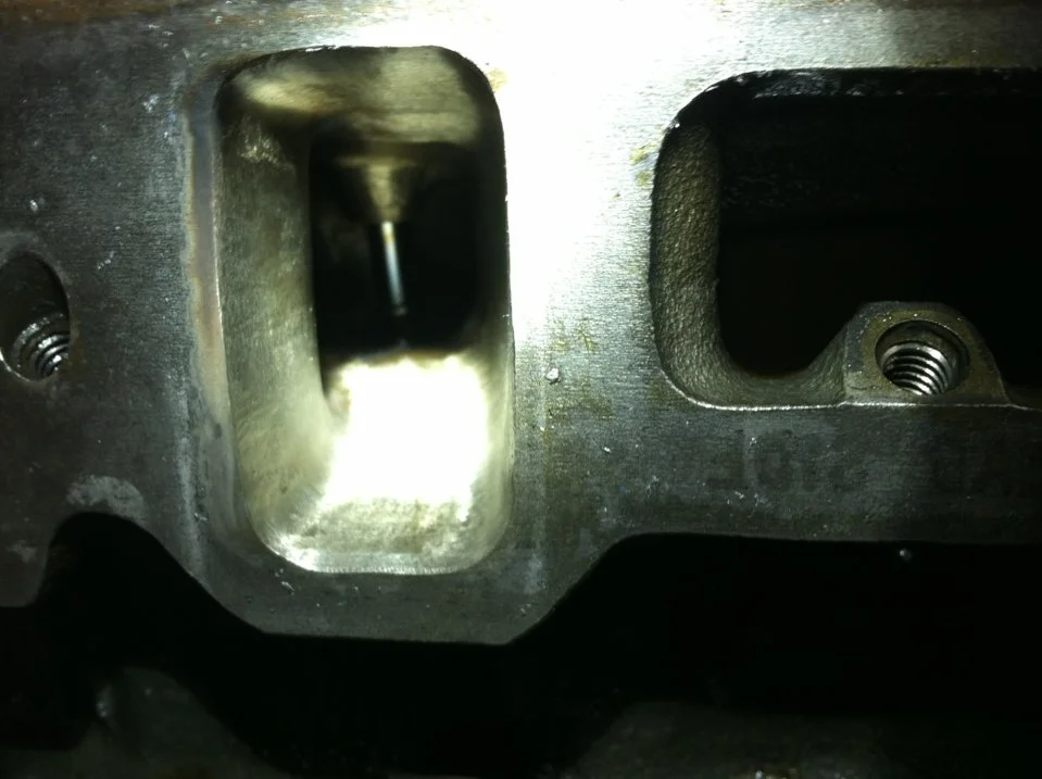

For those few of you who may know, I built my 331 in my garage going on about 4 years ago now. I built it out of the necessity for a new bottom end, but I didn't have the money to redo the top end to match. So I home ported my GT40 heads, swapped in a N41 camshaft and robbed the Edelbrock Performer RPM intake from my father-n-law. This combo has been good enough to propel my 3400lb car to a best of [email protected] with a crappy 1.85 60ft. That puts this combo right around 305rwhp, not too bad I guess.
For the last 1.5 years I have been collecting top end parts. I have taken next week off of work to get things accomplished, but I got a good start over the weekend and into today. Here is the new parts that are going on:
-AFR 185 w/ LS valve springs
-FTI custom Cam 227/235 .613/.588 on a 111 Lobe
-Systemaxx II Intake
-Mac 1 3/4" Longtubes 3" collectors
-Comp promagnum rockers
-VRS X-Pipe 2.5"
-Standard Volume Oil Pump (replace HV)
-UPR K-Member (Old D&D will not clear LT)
Here are some pics of the work getting done now and a few pics of the GT40's I ported. All the old stuff coming off is for sale ;).

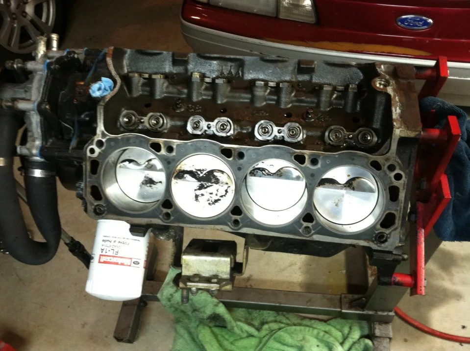

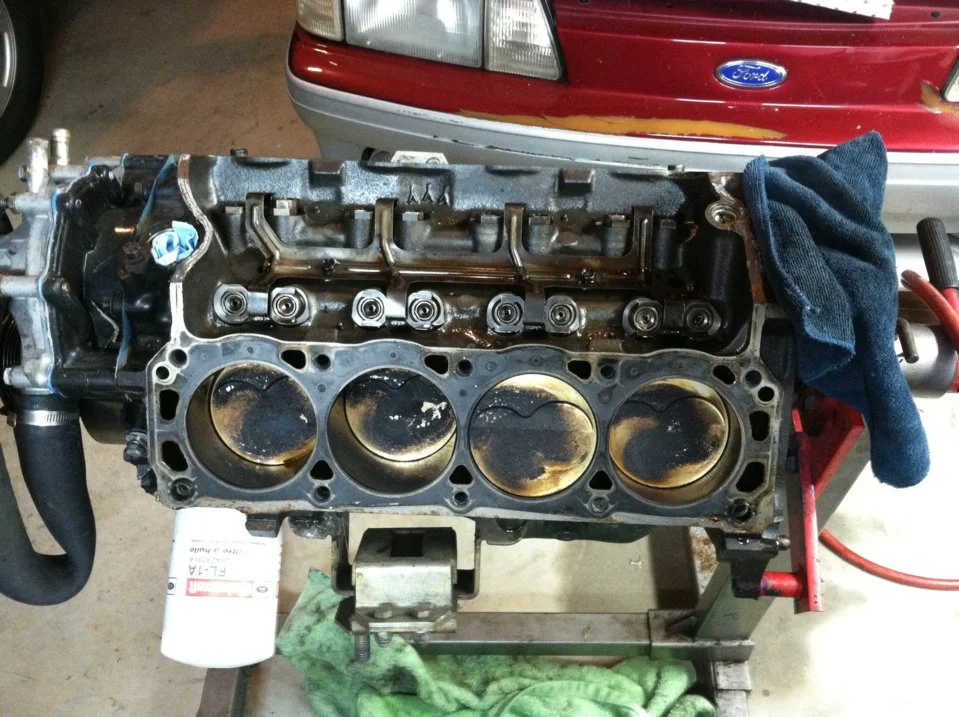

Got the heads off. Here is a before and after picture if the pistons. I used acetone and a rag to clean them. Is there any reason to clean them further? If so, what is the safest and easiest way to do this? I have read various chemical and mechanical ways, let's hear it from you guys.
Joe
