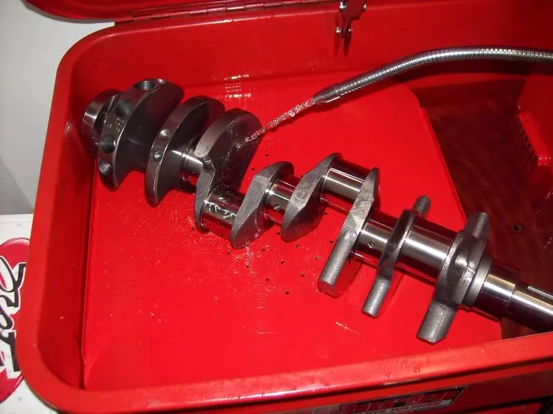

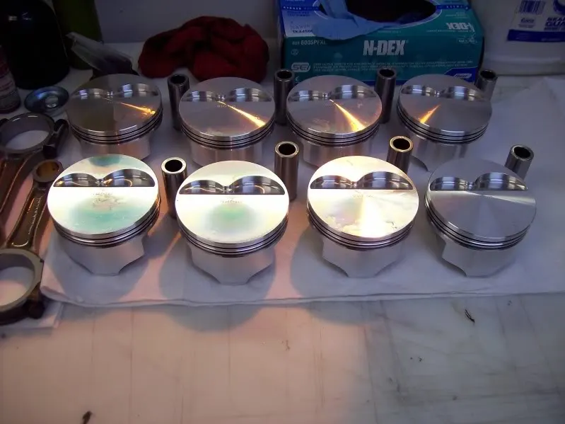

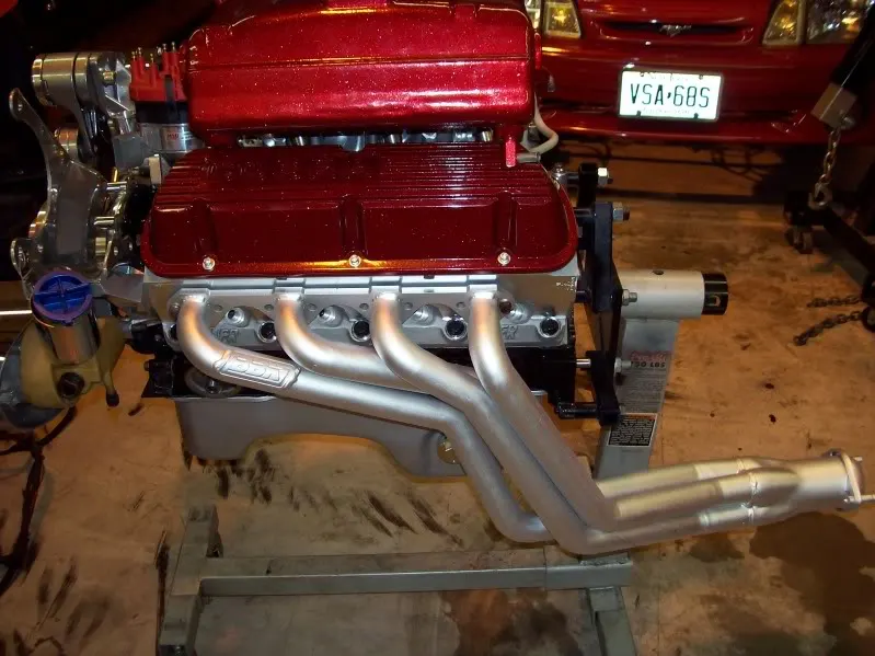

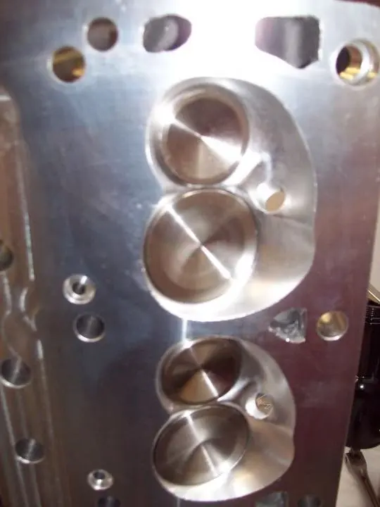

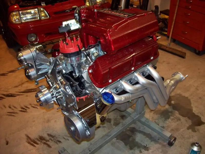

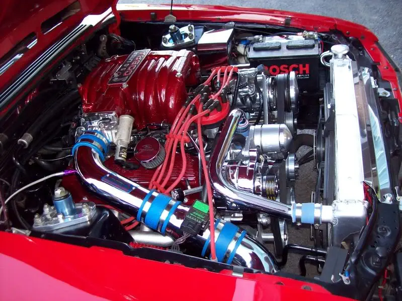

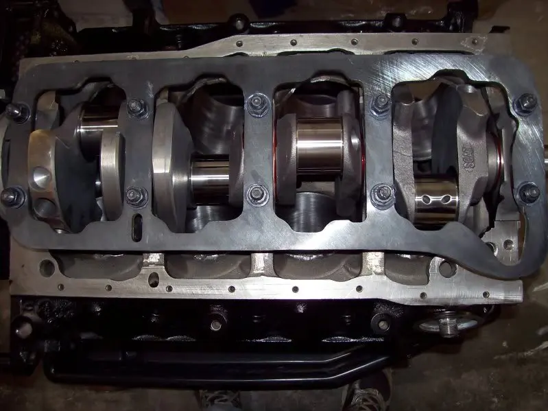

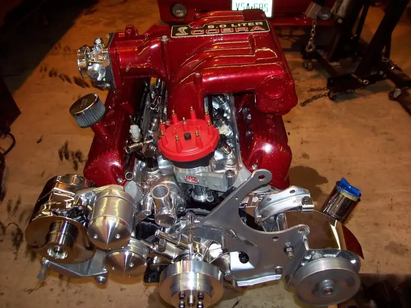

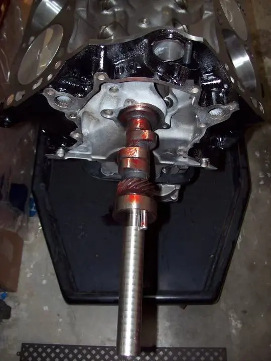

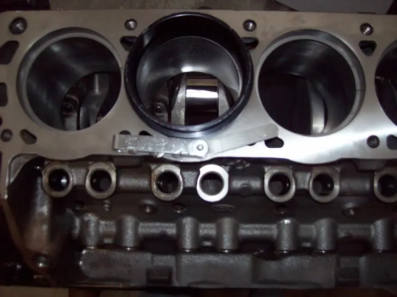

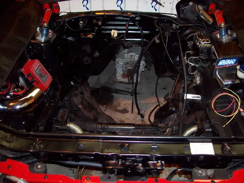

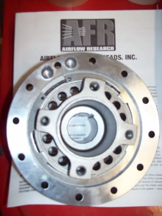

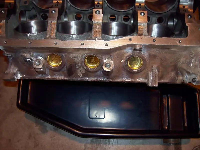

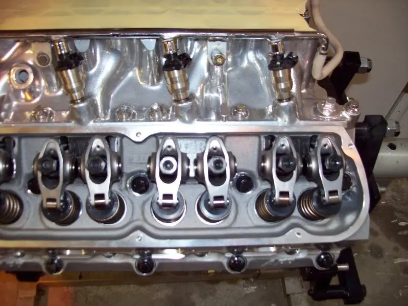

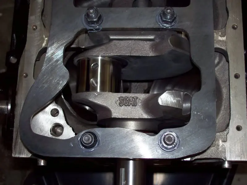

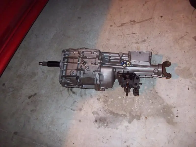

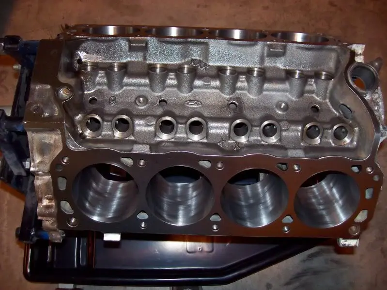

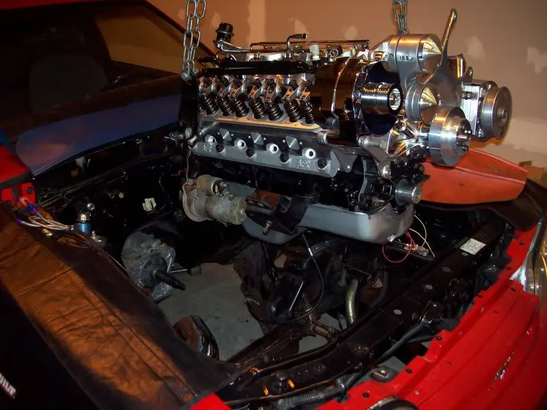

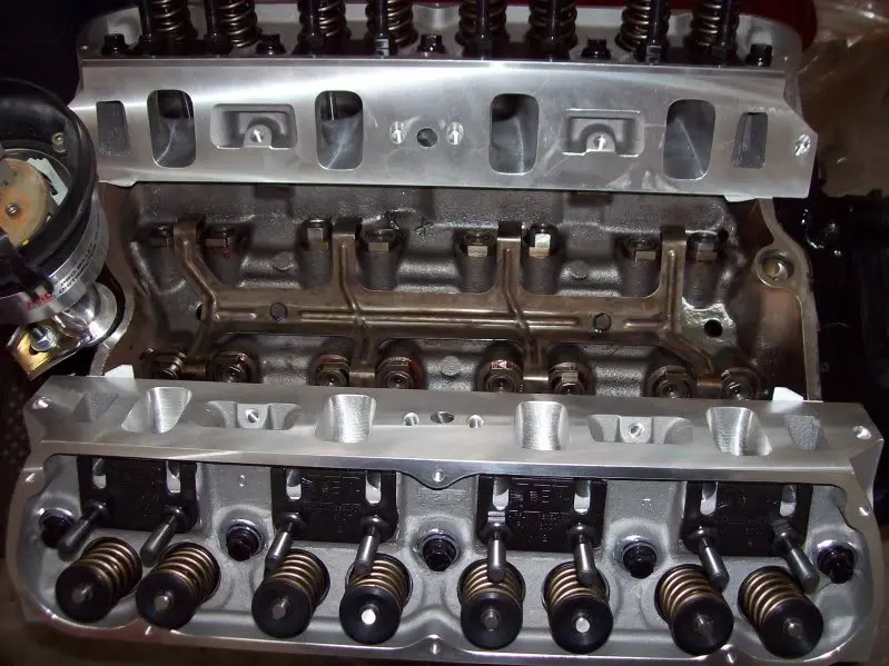

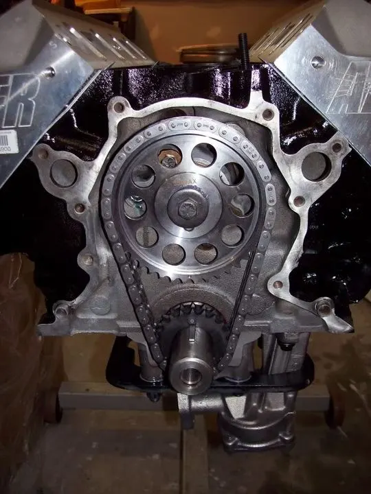

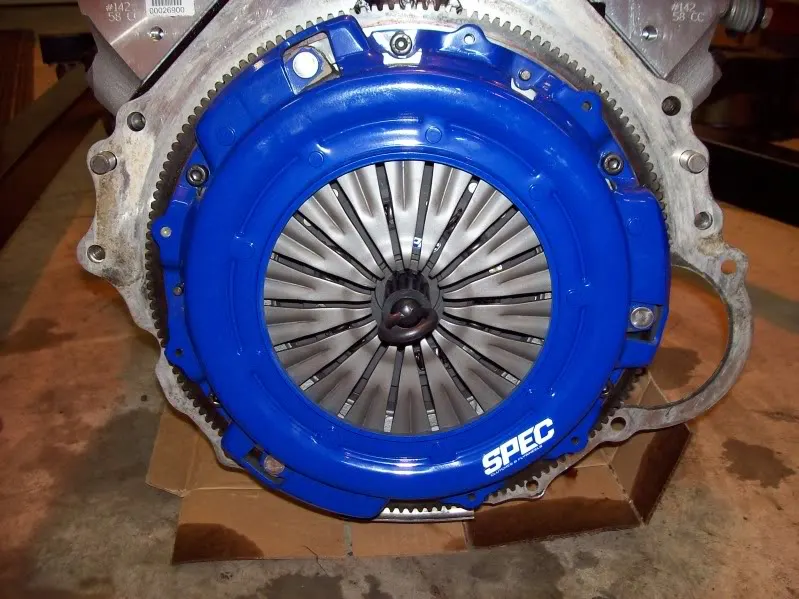

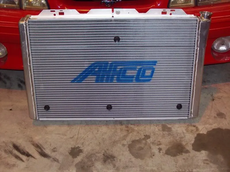

Rick sent my paperwork, disc with my build pics couple quater window decals they are already on car!! Well done Rick :hail2:
Thanks Guys! i know people are startin to get sick of my 333 stroker posts but all i can say is tough sheeet :rlaugh: no really this is the last post i felt i had to post up some of the pics rick gave me recently on a disc worth sharin alot of the parts and ideas i supplied but it was rick that put it all together and made it happen:nice:
Maybe a silly question, but what makes it a 333 vs a 331. Is the bore slightly larger than 30 over or is the crank slightly different. I have always been curious about this as many some list it a 333 and some a 331.
Nice setup by the way. :nice:
40 over instead of 30 over
Nice setup 89stang1! I can't wait to see what kind of numbers that thing puts out because I'm gonna have basically the same setup except I'm gonna use a Holley Systemax intake and an AFM powerpipe.
I made 360RWHP/383RWTQ when I tuned it on a Mustang Dyno, used a SCT chip :nice: We actually made 382/404 un corrected after we let it cool down for an hour and made 1 last pull, the air was near perfect, barometer was low and air was cool.
Cool! That should be good for 11s or so, huh?
Thanks yeah thats what im hoping for mid 11s i'll be happy and it will keep my nitrous bottle in my basement, but if i go mid 11s a small shot could put me high 10s........... and split the block:jaw: nitrous bottle staying in the basement
