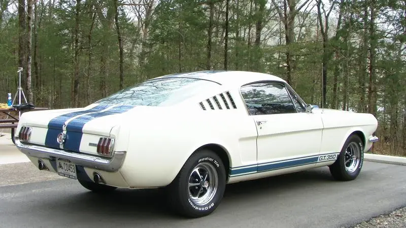

Hey guys,
I am having a 347 built and I wanted to get some opinions on what carb to run. I bought a new Holley 750CFM vac sec but am starting to question if it will be too much for this set up. Should I have went with a 650 vac sec instead. I plan on staying under 6,500 rpm.
This will be a street/highway racer....no dragstrip. Here is the set up...
1965 mustang GT350 tribute
347 block
Ford Racing F303 Cam
Hipo manifolds...for now (headers later)
Pro Comp castings
2.02 exhaust 1.90 intake
Performer Rpm intake
3.00 rear end
T5Z 5 speed
Thanks in advance!
