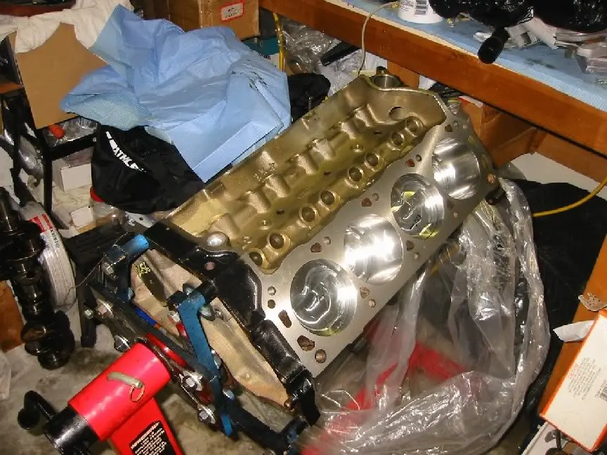

Well things are moving along. I got the short block here at the house now. I got the Cam and what not. My big summit order should be here on monday! Sunday i am starting to pull the engine out of the stang!
A couple of the Short Block
The FTI Cam
PS3 spring Kit
Oil Pan, Timing Cover, Balancer(in the white box), 28oz flywheel, Pick Up

Grn92LX said:
Nice to see quick progress :D
Whats the basic specs on the cam? Rpm range?
What rotating asembly did you use?
What is the compression?
1. Whats the basic specs on the cam? Rpm range?
Its around .590 lift duration in the 220 range and 2k-6k rpm range
2. What rotating asembly did you use?
Its a Probe Rotating assembly
Probe SRS Forged Pistons
Probe Forged I-Beam Rods
Probe Cast Steel Crank
ARP Throughout
3. What is the compression?
With the 60cc heads i have it should be right around 10.15:1 compression
4. Lifter Valley is clean it doesnt really look that drastic in person i think the camera made the color look more drastic.

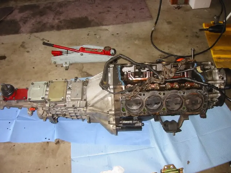

Well finally got the time to pull the engine out. Holy crap my engine bay is freakin dirty. I guess after 130,000 miles of driving some junk will acumulate in there. Its good to have it out but in the big picture im really not even half way done i have so much cleaning to do and so much work in front of me. Anyway here are some pics.
My Dad standing triumphantly over the motor and tranny we just pulled out
The Engine and tranny
Heads, Driveshaft, Lower intake(about to get sent to TMOSS), etc
And of course the Rediculously dirty engine bay

Killercanary said:
Looking good!
Treat that timing cover like gold as they are super expensive to replace.
Yeah i will be careful with it. The engine i used for the stroker was a 95 also so i have the timing cover, and i am going to keep the one from my stock motor as well. So ill have two :banana:
