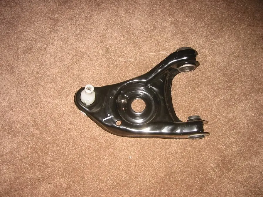

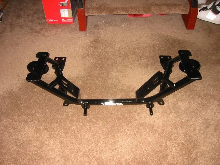

Hey K-member is finally here. It will be going in tommorow! Anyone have an tips on the reinstall of the new K-member? Here a couple pics
K-Member
03 Cobra A-arm
K-Member
03 Cobra A-arm
i like that k-membr design much better than mine. it looks like there is no grinding necessary on the a-arms for them to fit. is that correct?

I still believe the A arms will have to be modified to work with that K.
The install of a K is pretty straight forward. It's just a couple of bolts.
TIP-Don't overtighten the A arm bolts or the ears on the K will cave in.
They seem to fit in there fine. I emailed them to ask just to be sure, but they keep answering my second question and not my first one(which is about the A-arms) this time i sent them just the A-arm question so hopefully they will answer it this time :)
if they fit and have a full range of motion, you shouldnt need to grind anything. i had to take more than 1/8" off the back of the a-arms to get them to bolt up and have the right range of motion on the qa1 k-member.
On the PA racing K stock A-arms fit with no modifications as per email from their tech guy. I have them in now and they fit great. He said to TQ all the bolts to 75-80ft/lb. I just need to get my rack and bumpsteer kit on and the whole suspension will be done. Then i can put the car on the ground and TQ the A-arm bolts. I noticed that even with only a little pressure on them the ears seemed to move a little. I think with 80ft/lb they will move in even more.
