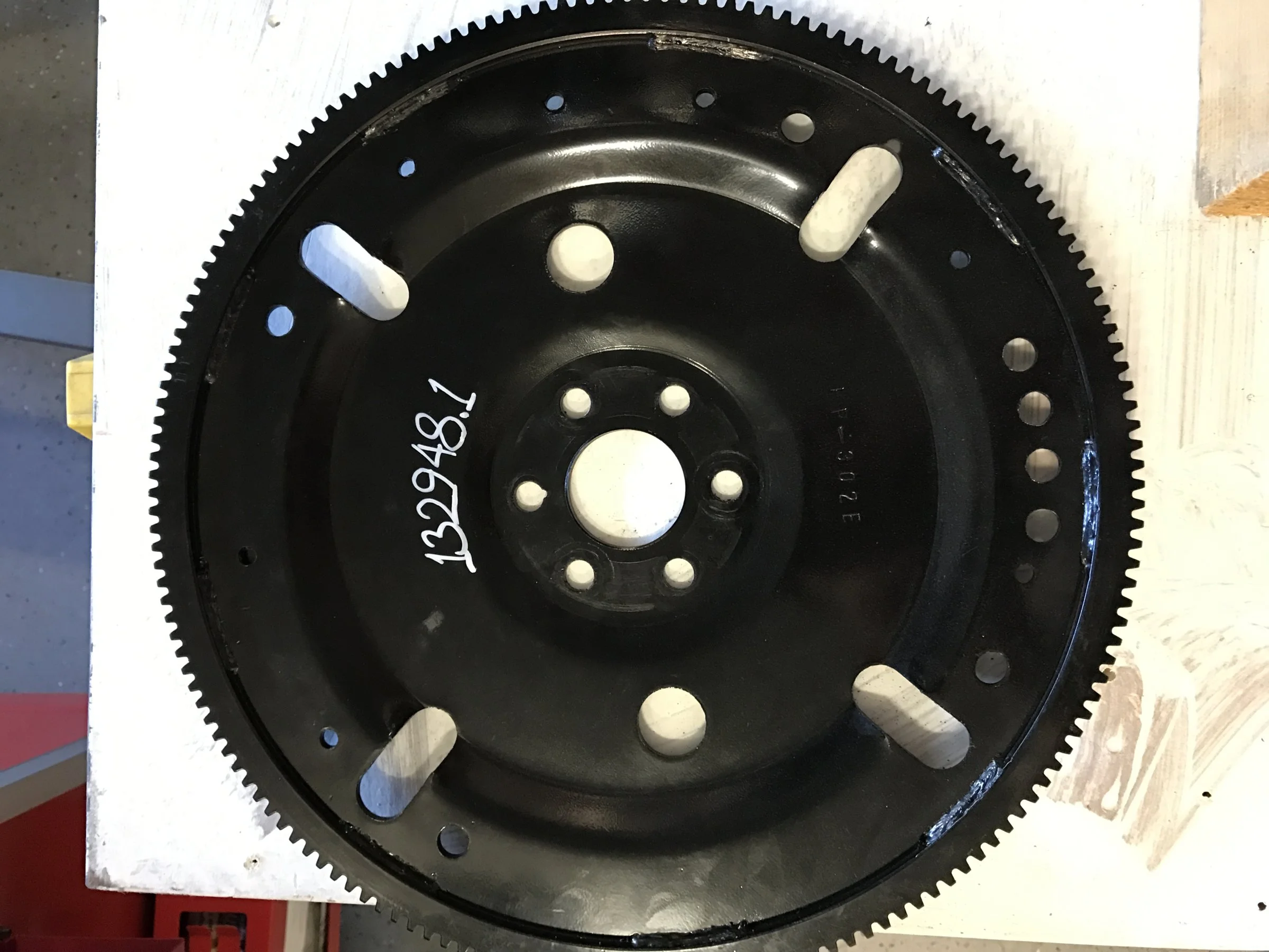

If you post a photo of both the front and rear of the automatic flywheel you received (and maybe a part # if one was included), it is possible that it can be ID'd by an astute poster as there are typically visual differences that can help.

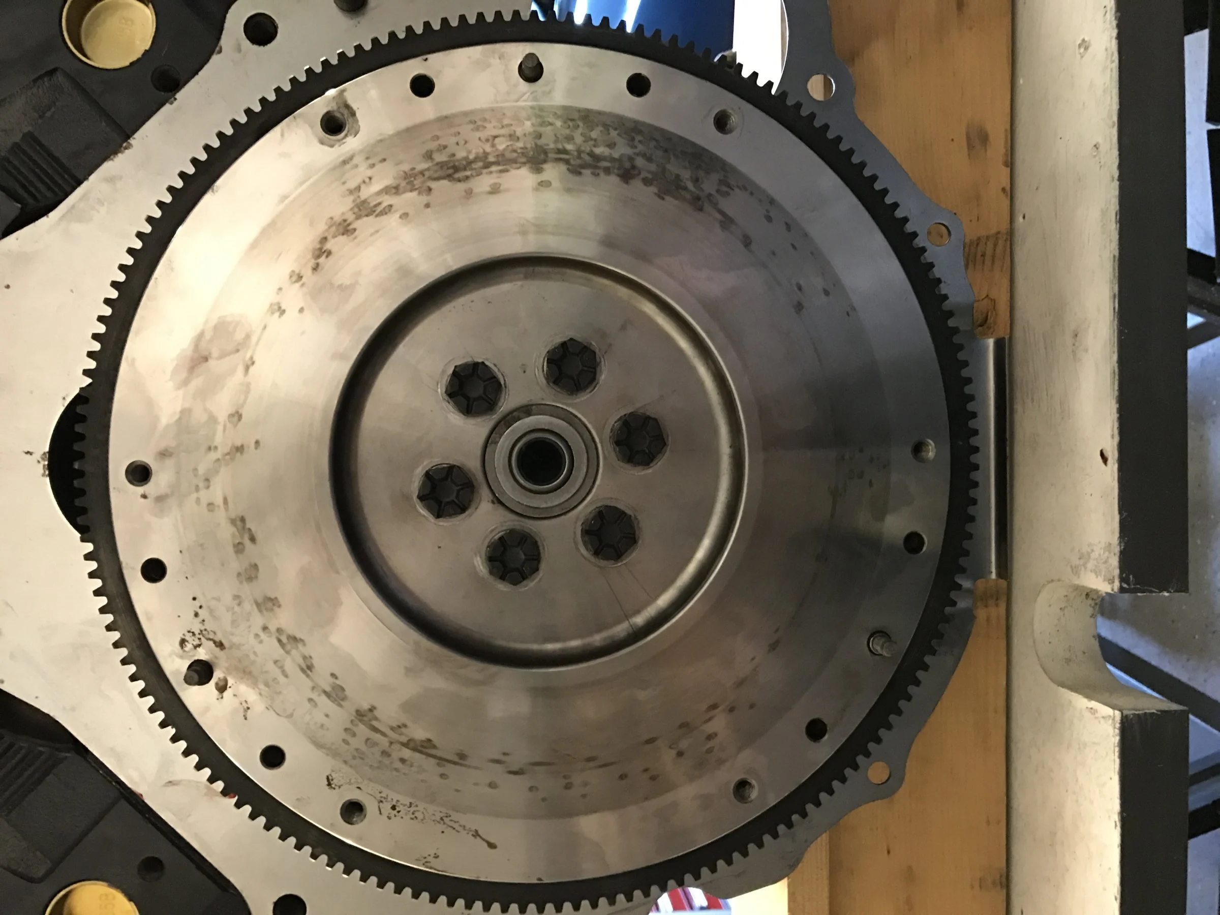

I just verified that the flexplate is 28oz 157 tooth imbalanced that came with the Ford 302 Series 9000 Cast Street/Strip Rotating Assy 347ci Engine kit p/n 1-94165BE from Jegs....and the flywheel is 28oz 157 tooth billet steel flywheel from Modern Driveline from the T5 conversion kit I installed last year.
So in theory, these should be good to go, right? Or should I still take them both to a machine shop to compare and adjust as necessary? Thanks!

If they are both 28oz imbalance, they you should be golden.
That said I try to have the flywheel also checked for balance when the crank is being balanced, but I am being extra cautious in that regard as I am spinning a big motor at higher than normal RPM's in a race environment.
(The pics don't depict the side that the weight is on.)
